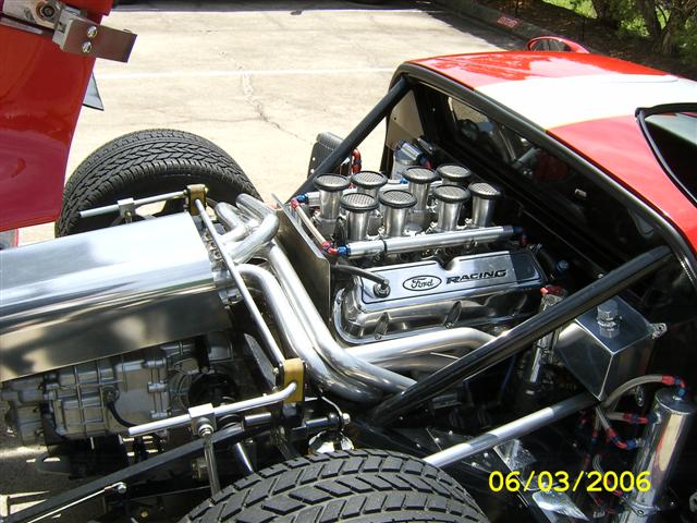

Flatchat, my humble apologies [img]/ubbthreads/images/graemlins/blush.gif[/img] I followed my own advice, had a look at the previous pages and found that I have been fairly reticent about the "go Fast" bits and the creature comforts...So lets start with the engine.
A Ford "Sportsman" block. Trick Flow Twisted Wedge cylinder heads."H" beam 4340 conrods. SRP forged pistons. 4340 347 stroker crankshaft, Plasma Moly rings. Heavy duty oil pump drive shaft. Hi volume oil pump. Crower performance hydraulic lifters. Comp Cams billet camshaft custom roller type.Yella Terra roller rocker kit. Moly pushrods. Steel race type harmonic balancer.D.C.&O. E.F.I. Autronic computer. All put together, balanced and blueprinted by Precision Engine rebuilders at Southport on the Gold Coast. Approx 500 FWHP. Thank you Graham.

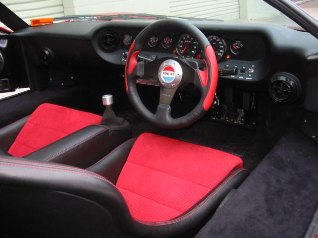

Creature comforts, include air conditioning, (a must in tropical Queensland), sound proofing, thermal proofing, tailored carpet, leather upholstery, race seats individually fitted, and set up with adjustable posture assist. Seat cushions easily changed to accommodate different drivers. Leather steering wheel(soon to be removable).Cruise control,(the only way to stay at the speed limit.) Am/Fm radio MP3 and Cd player. Reverse warning sensors. Electric mirrors, and of course full instrumentation. I think that's it Flatchat. [img]/ubbthreads/images/graemlins/beerchug.gif[/img]

Good Pete --The wheels?,accusump,oilcooler, gearbox etc,etc
Air bags -- C'mon [img]/ubbthreads/images/graemlins/grin.gif[/img]
