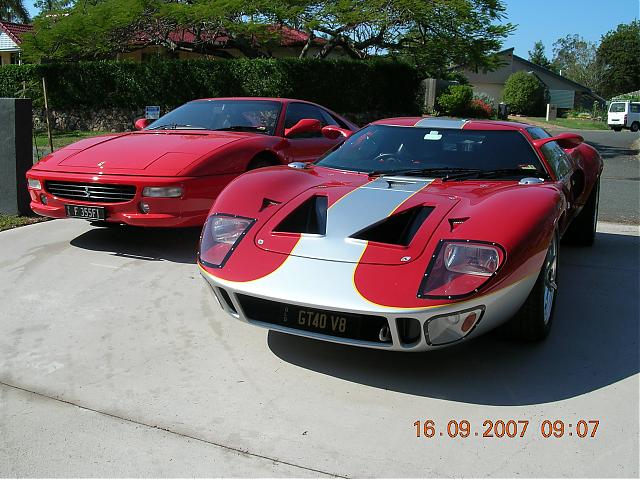

12,500 klms covered now and all of them fun. I am always surprised by the knowledge a lot of people have about the GT40. I wonder if that is something to do with the release of the Ford GT which relied a lot on the history of the Marque for promotion.
I seem to be a magnet for the police, but they have always been very nice (touch-wood) and seem genuinely interested in the car and it's history.
There is a police station only a couple of klms from where I live so I am always very quiet and circumspect around the area.
The only worry I have had is people trying to take pictures on their mobile phones while driving next to me. They always seem to wander into my lane.
