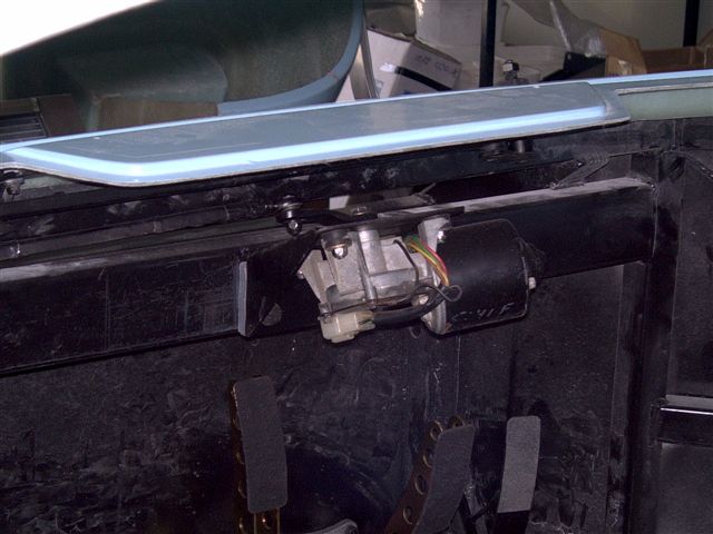

Windscreen wiper motor and assembly fitted.

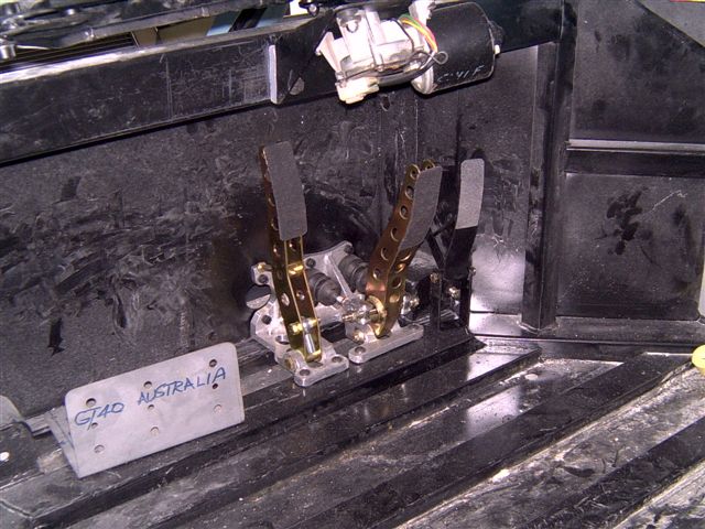

Pedals in place.

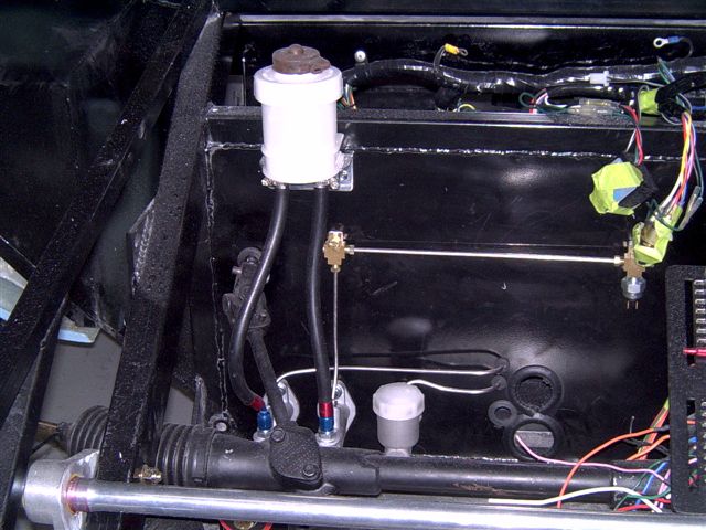

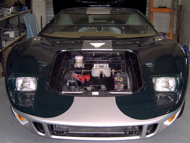

A bit more progress,hydraulic reservoirs in place. Steering
rack fitted,sway bar fitted.

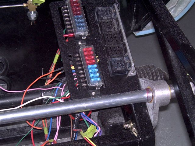

Wireing harness fitted, fuse box also.

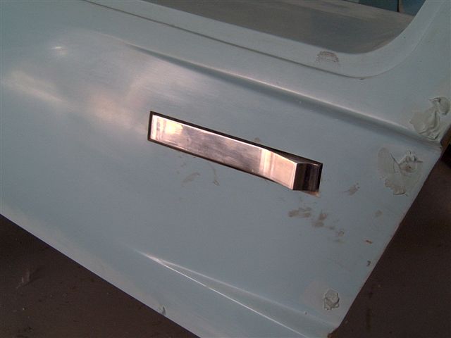

Door handles and latches done.

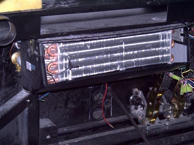

Air conditioning condenser in situ.

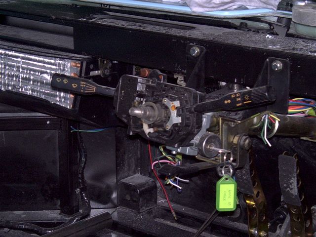

Steering column and ignition key.

Pete,
Did you go with the aircon. from DRB or is that aftermarket? Also, did you have to alter the footpedals any?

Re: GT40 Australia #48
Bill, Aircon is supplied by DRB.WE will fit me in place once seat is ready. The drivers seat is on rails and can be moved back and forwards to suit. (only possible if you are a relative short arse like me). [img]/ubbthreads/images/graemlins/grin.gif[/img]
