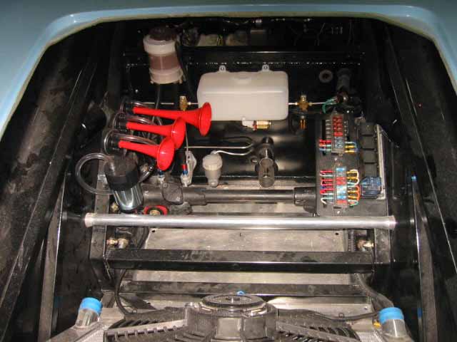

Does a red horn make you go faster? [img]/ubbthreads/images/graemlins/grin.gif[/img]

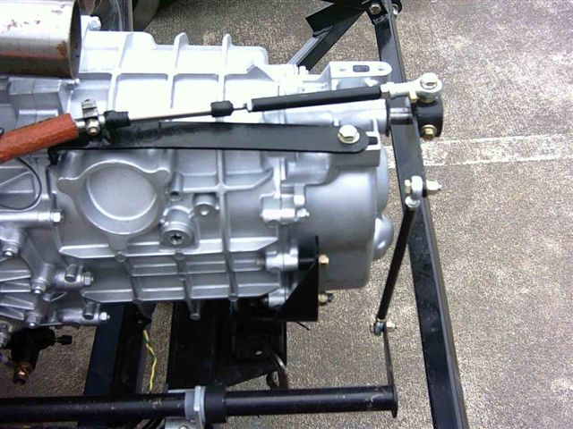

Gear linkages fitted.

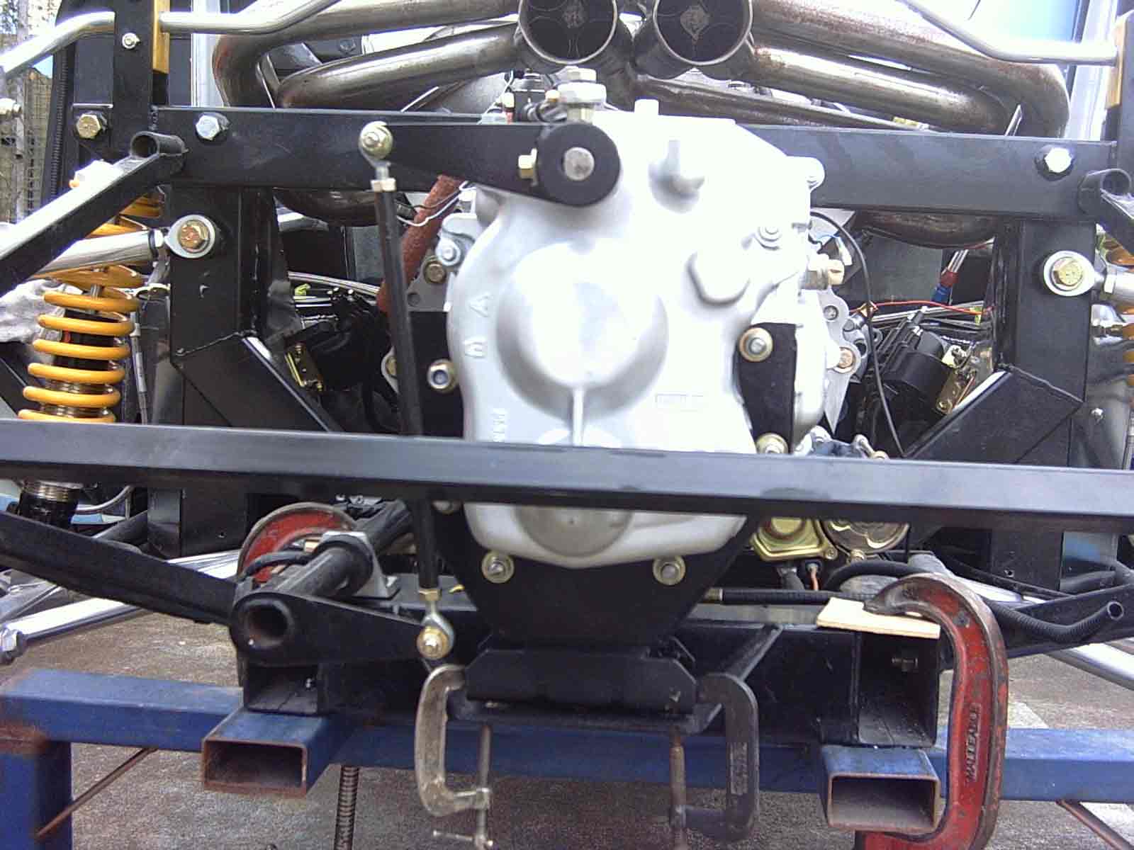

another shot of linkages

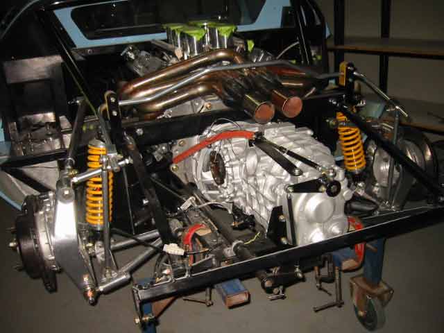

A different view.

Hi Pete - you're right, it could do with dropping an inch or 2 & wider wheels ! Backing off the damper settings might also help a bit !
In the gearbox pics, I trust that the red covering on the shift cable is some sort of heat shield material - I found out the hard way about not doing that (melted about a foot of the cable sheath). The CAT's I had to use were fairly large, & that meant that hot things got a bit too close to the cable.
I ended up running a sheet of semi-flexible heat shield over the top of the gearbox, & running the new shift cable horizontally along the side of the box, below the heat shield. The end of the cable fixes to a bracket on the outer end of the gearbox shaft rotation lever, & the lever is braced across the top to stop any fore & aft springiness.
So far so good - the feel of the shift is nice & positive, & there are no more puddles of melted plastic on the floor !!
