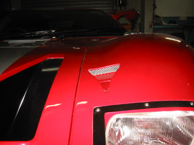

Small detail, had the NACA duct's "inlets" painted mat black
and filled in with silver mesh. They look quite authentic.
in the pics the flash has lightened off the black,but you get the idea.

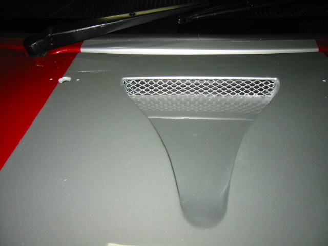

Two

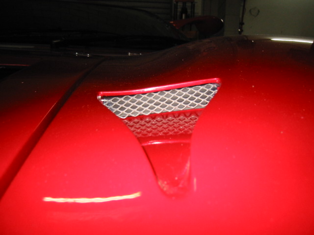

Three

Pete, now that is a really smart idea - well done !
I had been wondering whether to cut openings in the side ducts, and what on earth to do with the centre one - everything I thought of lead directly to paint problems, now it is all solved.
I hope you don't mind if I pinch your idea ! [img]/ubbthreads/images/graemlins/grin.gif[/img]

Actually it's a pretty popular idea up here with DRB's. Very effective as well.
I'm going one step further with mine...since it's being repainted, I have my only chance.
I've opened up all 3 ducts and getting fibreglass guy to continue them under the clip and then block them off. Paint them black and they will look authentic.
Plus it gives me the opportunity later to open the side ones up and use them as I can cut into them under the clip and it will all be out of site.
Sorry for hijacking your thread Pete. I'll throw some pics into my build thread when I get a chance to take the photos.

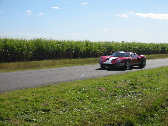

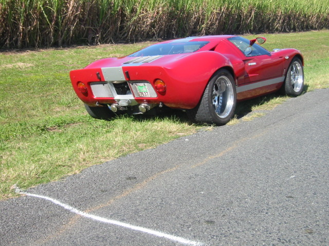

The noise and brake tests were conducted today. Brake test
comprises repeated stops from 100kph without locking a wheel. Average retardation was around 1G.
Drive by noise test is a 50kph drive past in second gear and accelerate away at the decibal meter. Then the same in fourth gear. Noise limit is a very tough 76DB.
WE PASSED. [img]/ubbthreads/images/graemlins/tongue.gif[/img] [img]/ubbthreads/images/graemlins/laugh.gif[/img] [img]/ubbthreads/images/graemlins/laugh.gif[/img].
Looks pretty in the cane field.

Looking good there I see..... One thing though, can you tell me at what distance they place the meter from the road as you pass by? We get tested at Goodwood motor circuit both as a static test at 0.5M and a drive-by at 10M from track, so I wondered how the levels/silencing compared...
thanks.
Also - (edited) I have just noticed the 'Super-Traps' or similar over your exhaust exits... How many dB did they drop? what diameter? and how many plates fitted? + finally - did they stifle the engine much?
Sorry to bombard with questions but am interested in your 'measured' testing.
thanks again...

Paul, we have 4 mufflers, 2 cats and two supertraps fitted.
I have no idea how much the Db dropped by because their was no "before reading". To my ear it went from a fantastic exciting symphony, to something vaguely like a fart in Church [img]/ubbthreads/images/graemlins/blush.gif[/img]. It certainly restricts the breathing but to what degree, once again, no idea, as it has not been near a Dyno yet. The drive by distance from the road to the measuring device was 7.5 meters.
Sorry I can't be more specific.

Must be a 'soft fart' in a church as 76dB at 7.5 M would be well difficult to pass.
Goodwood driveby test is (or was?) 98dB at 10M on the driveby......
I presume that after all testing and certification is complete, you'll not be upset should the Super-Traps 'accidentally fall off'. [img]/ubbthreads/images/graemlins/grin.gif[/img] [img]/ubbthreads/images/graemlins/grin.gif[/img]

Actually it was a very soft fart. The ambient noise from a light breeze blowing through the cane fields was around 40Db. All romance is going out of life. [img]/ubbthreads/images/graemlins/frown.gif[/img]
Pete is online now
