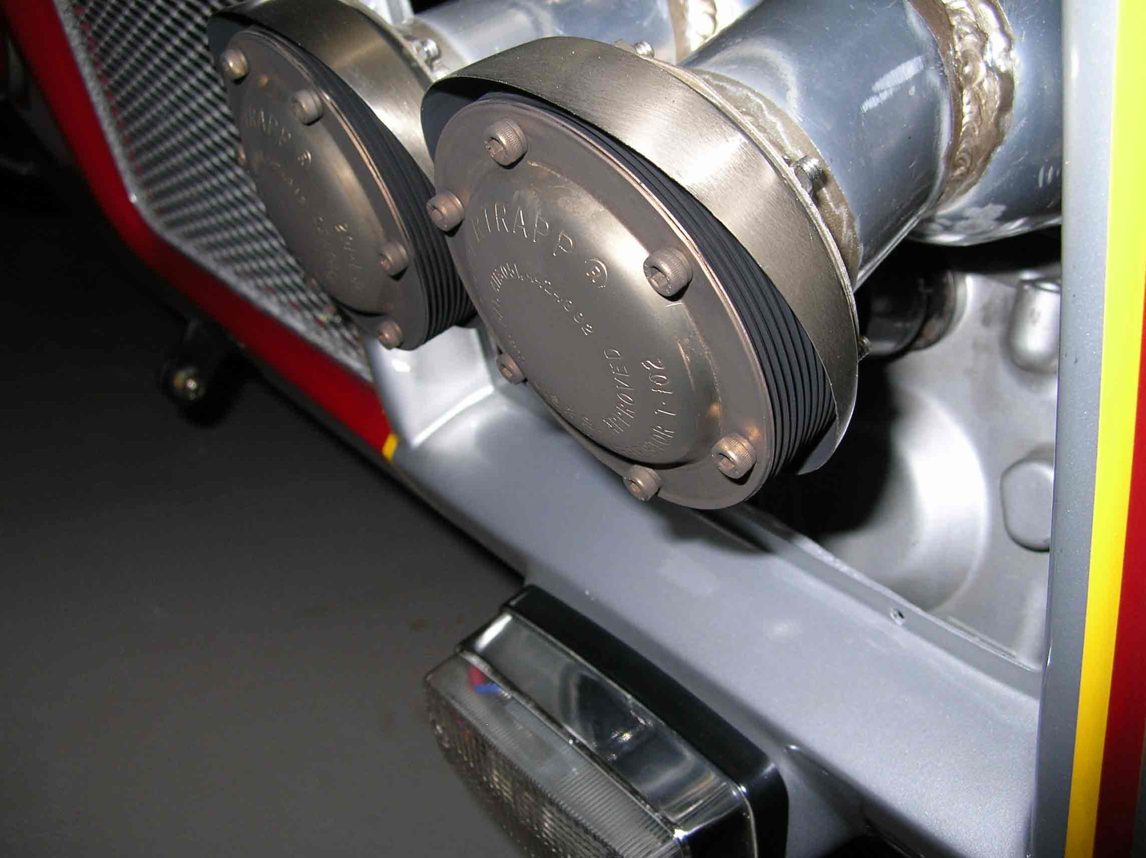

After a couple of weeks of very pleasant but unmistakable comments by neighbors, like "heard you go to work yesterday"and being followed by the local police and getting very sick of short shifting, I decided that I should do something about taming the incredible goose bump raising sound of #48. P.R. recommended fitting Super Traps.
See Pics. The Super trap fits on the end of the exhaust pipe
and has a variable number of baffles or traps bolted on behind the end plate. The more traps in place the louder the music and the less back pressure. To quieten things down just remove some of the traps. So you have instant exhaust tuning capability. For track days just take off all the traps and you are back to the original exhaust set up.
The manufacturer claims that horse power is actually increased by fitting super traps. When we have done enough miles to put the engine back on the Dyno we will have a fiddle and discover what is the best setup for both H.P. and
torque.
How do they sound? Well gone is the ferocious BRAAAAAATTT,
replaced now with a more sophisticated VROOOOM.All life is a compromise. [img]/ubbthreads/images/graemlins/smile.gif[/img]
How do they look? Frankly, compared to the end pipes I have been used to, I think they look crap. [img]/ubbthreads/images/graemlins/frown.gif[/img] But some people have commented on how cool they look. Anyway I think if I was trying to win a show and shine I would take them off.
Do they do the job? So far, an emphatic yes, I am no longer worried about the neighbors or the Police. The Dyno will tell the story. I'll let you know.

Here is a pic of the Super Traps.

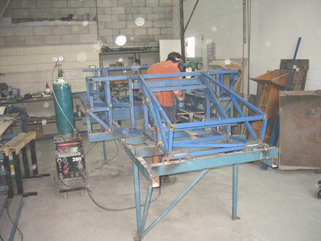

Well, 30,859 views and 424 posts. I think it is time to say my car is completed and so is this build thread. Thanks everone for the interest you showed and the help and support along the way. I have met and communicated with a lot of terrific people, some of whom, I am sure will become good friends. It has been a great ride. Now I wonder what the next project is? [img]/ubbthreads/images/graemlins/laugh.gif[/img]
The start.

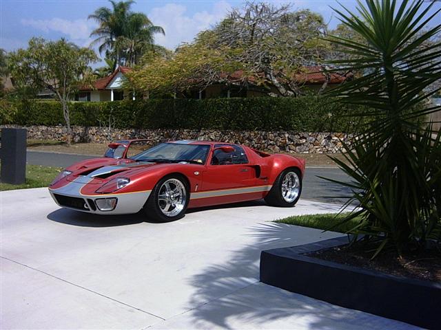

The future.

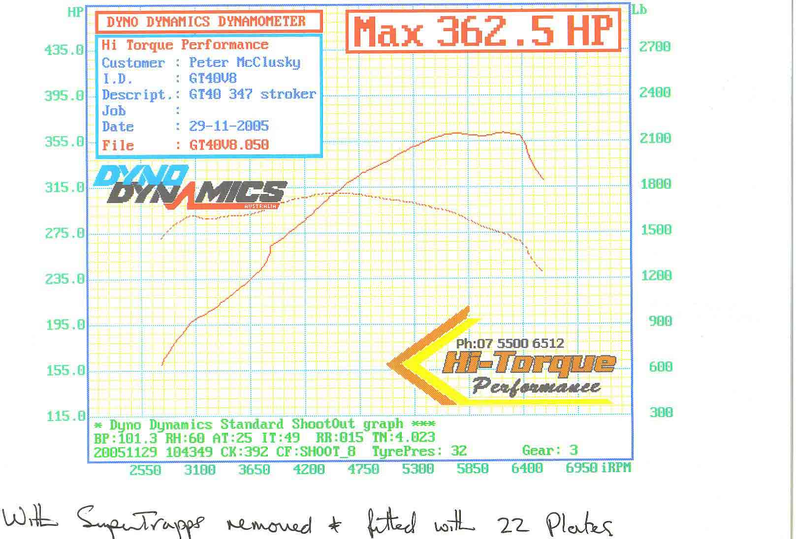

After 2500 KLM's of running in we went back to the Dyno and found a few more H.P. We now have 362.5 H.P. at the rear wheels and a healthy torque curve peaking at just under 1800 ftlbs. [img]/ubbthreads/images/graemlins/beerchug.gif[/img] We will have another look at about 5000 KlM's.
