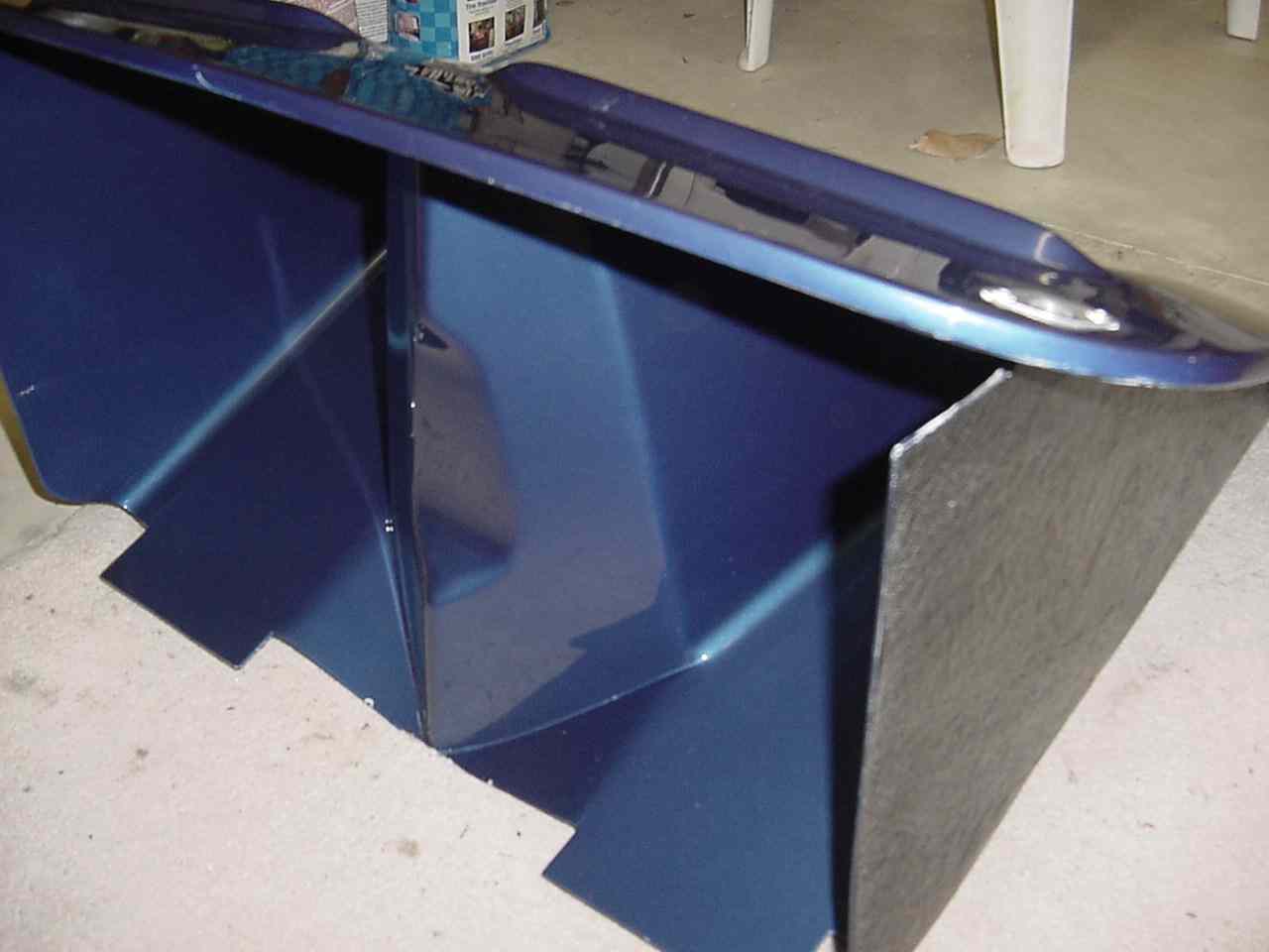

Bill, the only pics I can russle up at the moment are attached - one of mine fitted in the car, & one of Bill Bayard's panel on the floor.
Mine first :

This one is Bill's panel sitting on the floor (I hope he won't mind if I post his pic). The long & short of it is that the deep nostril panel really scoops the air out from the whole of the radiator - much the same as a MKII single nostril, but retaining the outside look of the dual MKI's.
My setup runs at 95-98degC for hours in the garage with the fan on, & did quite a few laps of the local area with no fan at 95 or under.
Good air flow thru the rad is one thing, but you still need to sort out the plumbing (bleed from the back of the intake manifold, etc) - this is covered in the thread "Hey Robert Logan" (I think that is the title).
