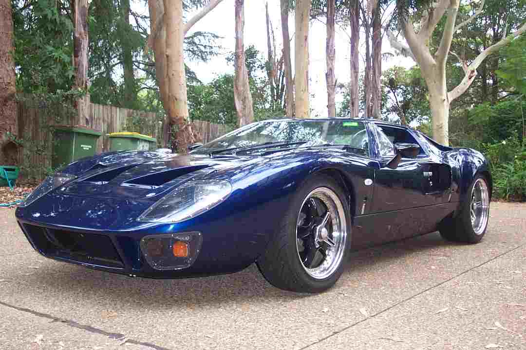

Well, its now been a few months since we managed to get the car registered, & very few of the "immediate fix" items have been addressed so far - the temptation to drive the car was just too much !!
I'll try to catch up a bit & throw in a few random pics on the way.
Every time I drive it, the incentive to take it off the road for the bigger jobs just seems to evaporate ! However, there has been a bit of progress on some of the more minor items :
a) Seats : I bought a pair of Robert Logan's seats for 2 reasons
- They are beautifully made & look so damn good
- Robert had all the ADR test reports available, so there was going to be no hassle with the rego
Unfortunately, they just don't suit a DRB which has a folded steel floor like the originals - the seat sits about an inch higher than it does in the RF with its flat aly floor pan, so even at my height (5' 9") I had zero headroom.
I had 2 options - modify the floor pan as per the DRB "dropped floor option", or change the seats. The thought of cutting & welding the floor so close to the fuel tanks did not appeal too much, so I have gone with the seat change. I started with the very early DRB f/glass shells that came with the car, but found that the driver's one was too wide at the front & stopped me getting at the handbrake. After all the work that went into that damn handbrake, I wasn't going to touch it, so V.1 of the seat involved slicing a V-shaped section out of the centre - from nothing at the top, to 95mm at the bottom front. With some temporary foam & seat covers, it worked well - I can operate the handbrake, my head doesn't hit the door tops, & I have an inch or more "arm room" fore & aft. However, I overdid the slimming exercise around the hip area, so I will graft in an extra 1/2" on each side for those sections in V.2 - 1/2" to get me comfortable now & another 1/2" for when I put a bit more weight on !! Once I am happy with the setup, I'll get the seats done in leather with the eyelets, etc.
b) Carpet & Trim : I was going to get a professional to do the whole lot, but started playing around with some "temporary" carpet & found that it was really quite easy, so I just kept going ! The headlining & door trims are way beyond my skill, so these will get done by the professionals.
The thing that kept me going on the carpeting was the reduction in engine noise when I did the rear cabin bulkhead first - huge difference in mechanical engine noise. I didn't use any insulation material, but just stuck the carpet directly onto the bulkhead & engine hatch panel (which on the DRB, is already a sandwich insulated panel). On the centre tunnel, I stuck a layer of 3mm closed-cell neoprene over it, then the carpet - that virtually eliminated the tunnel as a heat source.

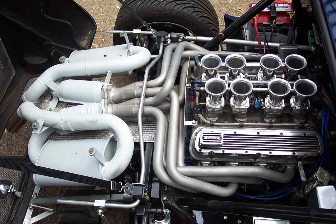

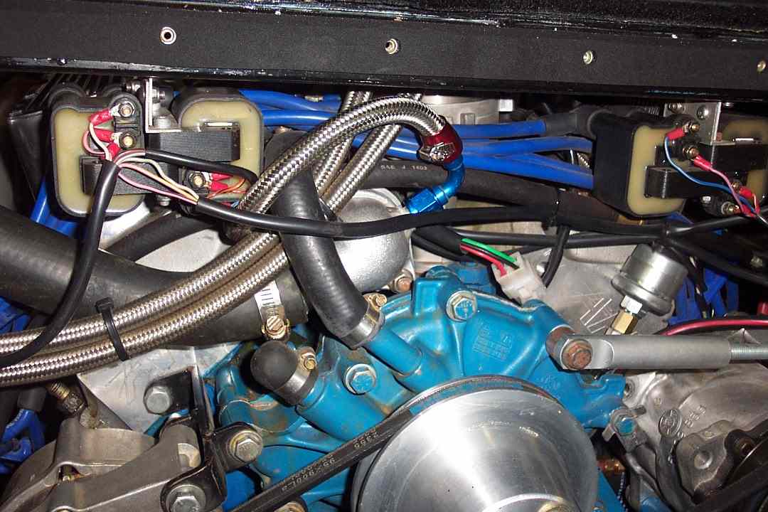

c) Exhaust System : I originally had a somewhat temporary "loop-back" setup with CATS, huge mufflers & lengths of simple "pipe bent" 2" exit pipes - it did the job, but looked ugly & was not too inspiring in the sound department. For a joke, we set up a really basic system where the collectors ran into a single small unchambered muffler - dual 2.5" in, dual 2.5" out - bloody hell ! It was unbearable - rattled all the windows & doors in the house when idling in the garage & was going to get me arrested out on the road ! I went back to the original "loop back" design with CATS, but 2.5" pipes (mandrell bends) & smaller mufflers - this setup seems like the ideal compromise. The house doesn't rattle, I don't wake up any more than the immediate neighbours, & I could probably sit at the lights beside the cops & smile ! However, when it gets some stick over 3000rpm, it is a different story - the famous GT40 howl just takes over ! The attached pic shows the new setup in rough form - once I get it trimmed up & the outlet pipes set staraight, then it will go off to get coated. The headers had already been done in Jet-Hot & after a few hours on the dyno, looked like I had painted them in grey undercoat - not happy ! I am taking my time in looking at alternatives, but a new teflon coating is looking promising (see pics in Gallery - Chezzeris).
d) ECU Tuning : Due to the extreme time constraints in getting the car through emissions testing, we only managed to map the really basic things in up to 3000rpm. Now that things are more relaxed, we have had an initial shot at finishing the mapping & the results are amazing - I reckon that we are seeing at least another 80-100hp up near the top end, but all the low end stuff remained the same, but with more torque. Some time in the next month or two, we'll run it up on the dyno to extract the last few percent !

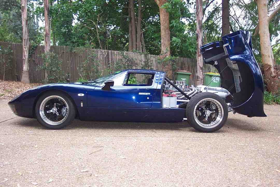

e) Rattles & Clunks : I finally bit the bullet & pulled all the rear suspension down to re-check alignment & re-tension everything. That was a major pain as I had to remove most of the fuel system from the RHS tank cover to get at the front of the lower trailing arm - just as well I did, because I found that I had not fully tightened up the main nut/bolt thru the end of the arm ! When all was double-checked & re-assembled, all the big nasty clunks had gone & I am just left with a small orchestra of minor rattles over very rough roads. I have no idea of what is "normal" in terms of noise from spherical joints, but they are my principal suspects & I may end up replacing the rather random selection that I inherited (some have little dish-shaped grease nipples which are absolute buggers to get to & use, others have no grease nipples & I assume that they are the teflon types).
The following is a pic of the rattles & clunks - let me know if you can see them, because I'll be damned if I can !!!

f) Electrifying Fun : Back on the road for a few days after the rear supension work & all was going well - until the car just stopped dead. I pulled over, waited a minute, then restarted & all went ok for a mile or so, then dead stop again. After 4 of these sessions, I finally got back home & plugged the PC in for some diagnostics - First, I pulled a log file from the ECU, but all it told me was that the engine stopped 4 times - with the Autronic, you can only log 16 channels/parameters, & naturally I was logging all the ones that told me nothing relevant. I spoke to a few mates who suggested that it sounded like a loss of power to the ECU (perhaps a faulty alarm/immobiliser), so I reset the logging channels to include ECU volts & a few other go/no-go parameters, & started it up again in the garage. Sure enough, after 15 mins, it just died - no coughs, spits - just plain dead. When I checked the log file this time, I could see that the ECU volts went from around 11 down to 8.4 - about half a second before it died. Ah-ha, I thought - they were right - but wait - the fan died at the same time as the engine, but then burst back into life 4 or 5 seconds later - ???? When I figured it out, I realised that the fan is not yet controlled by the ECU - just a manual switch on the dash, so the volts drop must have been further back toward the battery than the alarm, etc.
A couple of scotches / hours later, I had worked my way back to the main fusible links & found the problem - the one that provides power to the Ign Sw (& hence the ECU & fan control) had a badly burnt contact. I am not sure what type of setup most people use, but mine is a Holden Commodore / Ford Laser link block with male spade terminals, & the fusible links are modular units with female spade connectors which plug into the link block. Rather than use the original modular link units which came with my junkyard link block, I bought all new ones (4 x 40A) - I should have left well enough alone ! The new ones were some cheap Taiwanese jobs & had very little "grip" on the spade connectors - the old ones were a nice solid fit. I reckon that with such a loose fit, some arcing happened & once things got really hot, the connector went high resistance & dropped the volts. Given a minute or two to cool down, full contact was re-established until it all heated up again. It all then seemed logical, so I have 4 new links from GM/Holden installed & the whole problem has gone away - just goes to show what I should have already known from the wheel bearing exercise - don't use cheap 3rd party parts - ever, ever !!!!
g) Rear Clip Support Straps : After putting up with bits of fencing wire for months, I decided that it was time to set up some decent way of holding the rear clip open. I had previously toyed with the idea of gas struts & solid struts (to avoid having a gust of wind shut the whole thing on my head), but decided that it was all too hard. If there is a breeze, I'll just jamb a broomstick in place to stop a disaster ! I settled on a pair of simple 1" webbing straps with hooks at each end - these just fit into brackets on the clip & on the rear suspension posts (the latter also serve as heat shields to protect the nylon sway-bar bearing blocks which had started to bubble in the heat from the nearby exhaust pipes).

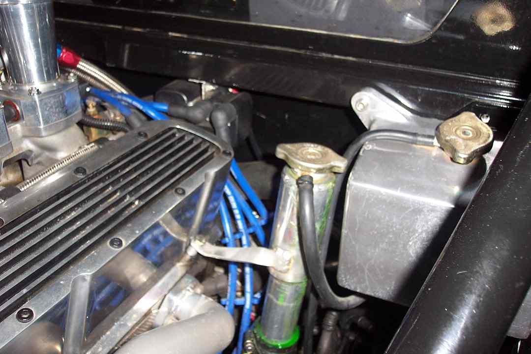

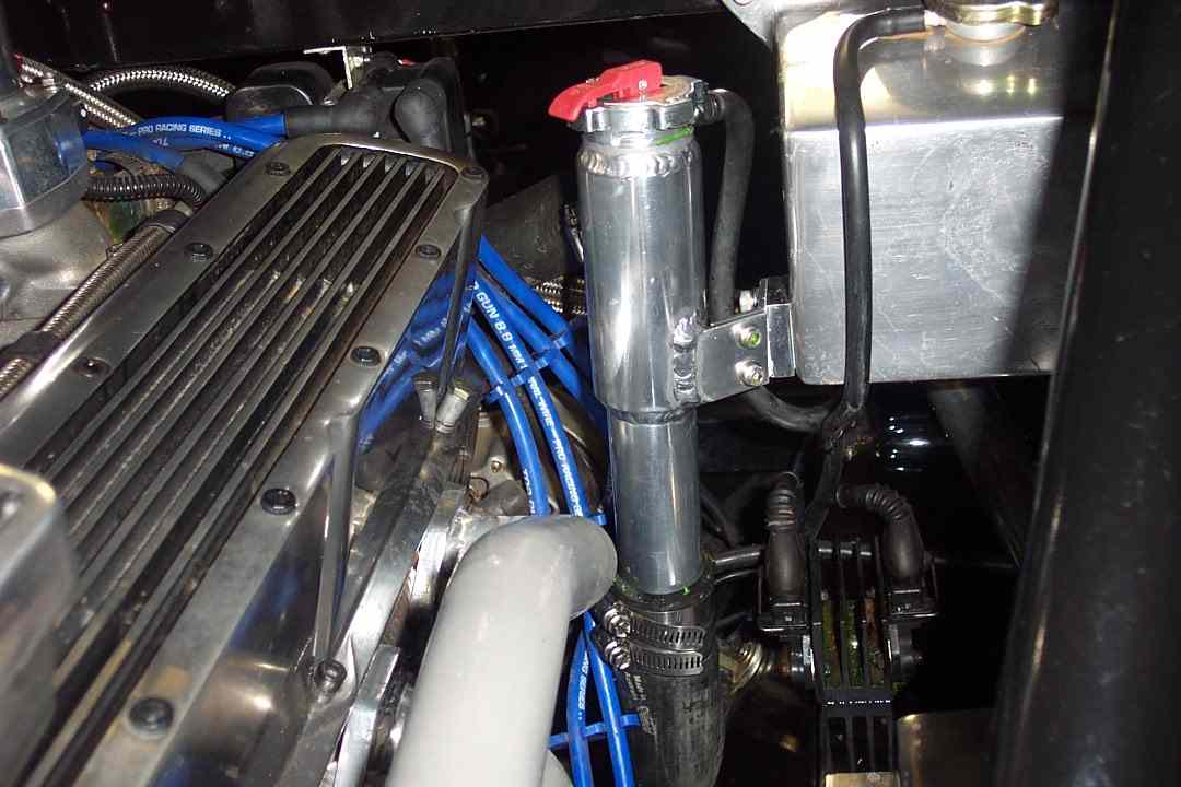

Cooling System Leaks - Right from the beginning, I had an annoying minor leak from the top of the header tube – when the system heated up, the excess coolant dribbled down the outside of the tube, but when cooling, it seemed to suck in fresh coolant from the recovery tank. This meant that the system never actually got pressurised, and I had to keep an eye on the coolant level in the recovery tank. I managed to forget about this once, & was rewarded with air in the system, boiling, bleeding, bleeding & more bleeding !
Check the green goo !

That was it – time to do something. Peter Ransom at GT40 Australia very kindly sent me a brand new header tube which was made from thicker-walled alloy tubing & had a really nice machined billet top for the pressure cap to fit into.
The pic shows it mounted off the recovery tank, as opposed to the old setup where it was mounted to a rocker cover bolt. The green coolant in this pic is just a bit left over from the bleeding process - trust me - it does not leak any more !

While fitting this, I also took the opportunity to change the routing of the bleed line that comes forward from the 2 water ports on top of the rear of the DC&O manifold. This was originally fitted into a spigot on the header tube, and not wanting to fit a new spigot into the new tube, I re-routed it to an AN spigot on the RF thermo housing (Robert Logan fits these as standard to his thermo housings).
Another reason for this change was that the original header tube was mounted to the engine, whilst the new tube is mounted on the side of the recovery tank & I didn’t want to transmit the full engine vibration down the bleed line to a small spigot fixed effectively to the body of the header tube.
The net results of this little project were firstly, No Leaks ! and secondly, the system runs about 3-4 degC cooler than before – it will now sit on 88degC with no fan when its moving, & much the same when sitting still with the fan on – why – I don’t know !

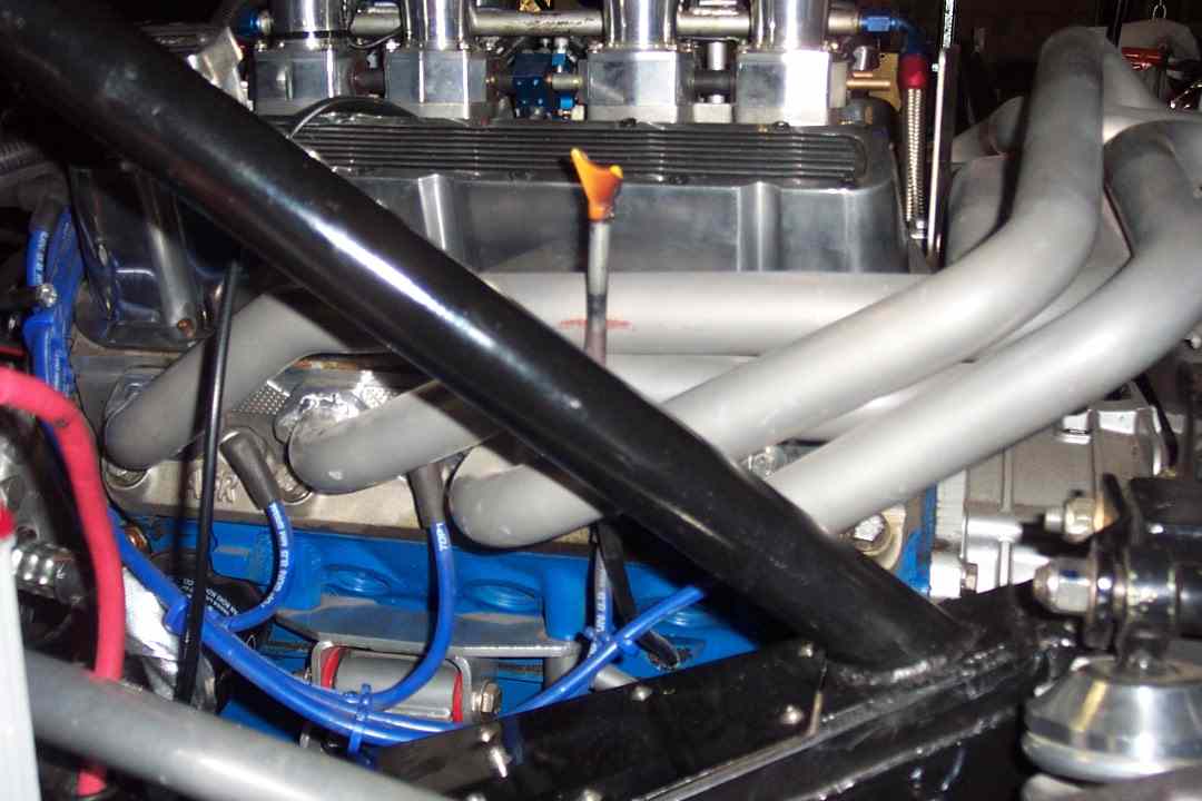

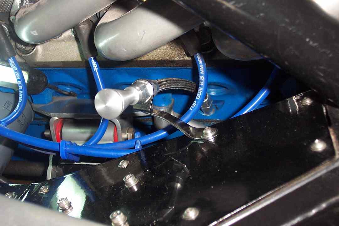

Dipstick Replacement - My original disptick was something from a Fairlane or F100 - stuck up between the headers, no idea of calibration & ended up with a melted plastic handle - absolutely useless !

Sorry about my spelling in the last post - what a Dipstick !
Thanks to Colin D, I now have a nice Lokar flexible job that is all alloy and actually reads correctly ! The trick is that if you get the Lokar Part # ED-5004, it is specifically made to fit in the side block entry point of the SB302 - therefore, calibration is unnecessary as the markings are correct for the oil level height relative to the crank, regardless of the size of the sump - you just fill until it is right !
Kind Regards,

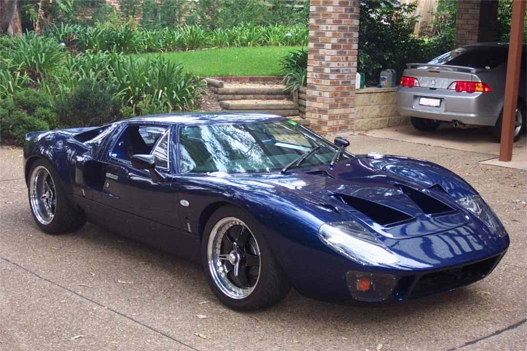

A very quick update - lots of fun & dramas since the last post :
- Cut & buffed the paintwork (such a simple phrase !). Once I had got into this, I remembered why I had kept putting it off ! One round of 1000grit, one of 1500grit, one of 2000grit, then machine & hand buff, then polish - I never want to do that again !
- Gearbox out for a rebuild - new synchros & a taller 5th. What I got back was no 2nd gear & a really noisy new 5th !
It has now gone back for rebuild#2 - no further comment required !
- While the box was out, I replaced all the dubious rose joints in the rear with aircraft-quality teflon ones from National Bearings. Major reduction in clunks & rattles, but I still have a problem with the AVO shocks as the bearing housings in the end hoops are slightly oversize (I can run two layers of teflon plumbers tape around the bearings & still push them into the housings by hand) - I am trying to figure out a fix for this.
- The seats went to the upholsterer during g'box rebuild#1, but wharf delays prevented the arrival of the leather hides. Hopefully they will be here in the next day or so & I can get the seats done during g'box rebuild#2 !
- I had the exhaust system recoated in ceramic silver, along with a whole bunch of other brackets, bits & pieces, etc. That looked great until I had a fault in one of the igniters that left me limping home with 2 cyls not firing - the unburnt fuel load going into one of the CAT's got things bright red hot, so the new ceramic finish is now ruined on that side. As always, 5 steps forward, 4 back !
- In between g'box rebuilds #1 & #2, I had to have the car ready to be centre-stage at Castrol's big launch event for their new oil "Edge". In spite of no 2nd gear, we made it & it was well worth while. The GT40 drew far more interest than all the Jap street machines & drifters - it was surprising how many young petrol-heads found it hard to believe that the design is 40 years old !
At the Castrol Edge launch :
