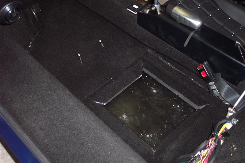

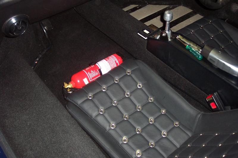

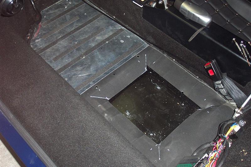

I originally had a sheet of closed-cell foam over the whole floor area, topped off with a 2mm aly sheet, then the carpet.
To cater for the dropped floor pans, I cut out the seat section from the foam & shortened the aly floor so that it only covered the sections in front of the seats. (The strips on the aly floor are just stick-on non-skid stair treads - to stop the carpet slipping around).

Then similar cut-outs on the carpet, with the flaps going into the seat-pan - heated & folded down. (The extra layer of carpet in the front sections is just a "floor-mat").

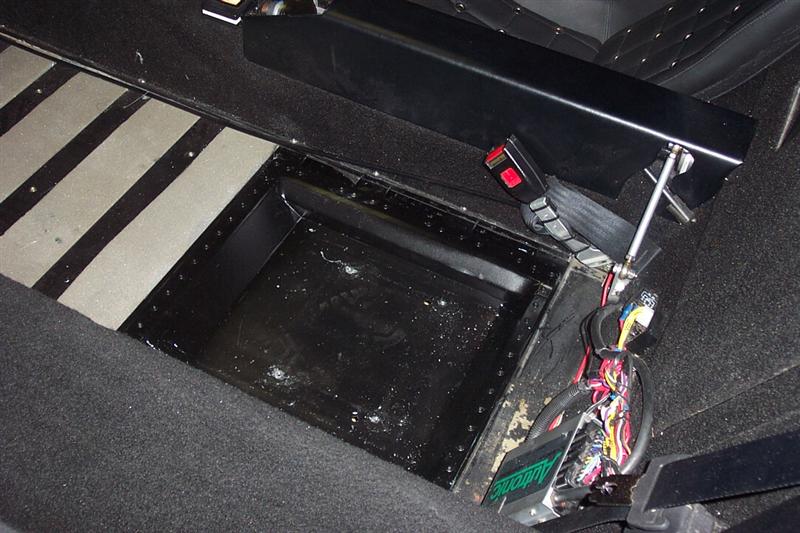

The finished product - the seats nicely hide all the carpet & rubber cuts, and the carpet stays flat courtesy of the heat-folded flaps (done with wife's hair-dryer !).
Apart from a huge improvement in the driving position for me (seats back 1/2" & down about 1 1/4"), I'll now be able to take some of my "more bulky" friends for a ride !!

Yep, Henry does good work. His idea for fixing the seats was to machine up 4 x circular "buttons" for each seat - about 6mm thick & 30mm dia. These are recessed into 12mm holes in the floor from below & welded in place.
The buttons have 6mm threaded holes to accept s/s "coach head" philips bolts coming down thru the seats, & the ends are machined off as you suggested. The underneath of the button is chamfered so as to "glide" over speed bumps !
I originally suggested 2 "skid plates" running fore & aft, but welding them under the new seat pans would have created nice little rust nests in the void between the plates & the seat pans. Next, I suggested cutting the plates into the seat pans & butt welding - so Henry came up with the "button idea" - less work, no rust voids, & thinner by a mm or 2.
My radiator came with the part-started car - I believe it is a Commodore one, but that it was modified by DRB - Peter Ransom should have the clues on this.
Hope this helps a bit.

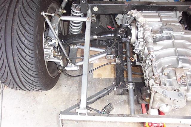

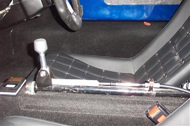

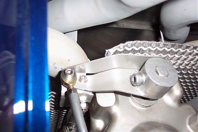

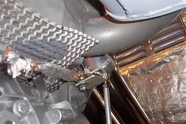

These are some pics of the G50 gearshift setup for Henrick.
The original cable setup ran over the top of the gearbox & connected to the top of the boss on the gearbox shift shaft. However, the heat from the CAT's melted the cable sheath, so I ran the new cable along the side of the gearbox & connected it to a bracket on the end of the boss's lever.
To stop any bending of the lever fore & aft, I welded a strengthening plate across the top of the lever & boss.
It all seems to work fine, & no melted cables !
Henrick, let me know if you need any more pics, etc.

Beautiful work, and I like the idea of that stiffening plate to take out any flexing in the in/out motion.

Hi Peter,
Thanks a lot!!! I believe the pictures shows very well the design!

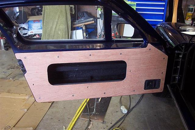

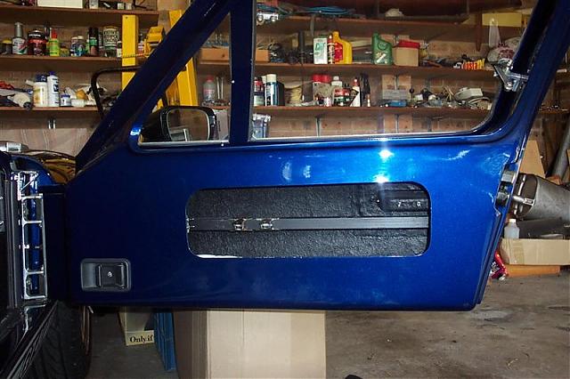

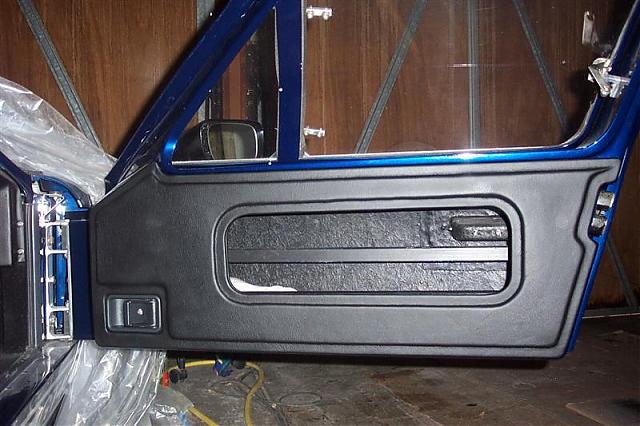

1. Inside Door Trim Panels
After sorting out the seating in the car, the next project was to get the inside door panels done. After much thought, Mike Cooper (the guy who did such a nice job on the seats) came up with a design that we were both happy with.
Stage 1 was for me to make up the panels to the correct shape & fit them to the doors. The panels were done in marine ply, & I set about 15 x 4mm c/s bolts into them (epoxied into place). The bolts pass thru holes in the f/glass inner door panel, & all is held in place with wing-nuts - you can't see them, but they are dead easy to install/remove. I also made up some re-inforcing bars out of 1/2" aly angle - these run the full length inside the doors, along the bottom edge of the cut-outs - these were bolted in place 1st, then the door panels go on & cover the bolts. Apart from stiffening up the lower edge of the cut-outs (making a useful "door-pull"), they also provide a mini arm-rest area which does not intrude into the cabin.
Once we were happy with the whole setup, Mike worked his magic & covered the re-inforcing bars, the edges of the cutouts, & the door panels in the same leather that he used for the seats. His really smart suggestion was to put some fairly hard foam on the cabin sides of the panels & to trim it back some 5/8" from all the edges. Once the leather was glued over this, it provided a very nice "character line" around all the edges & so he ended up achieving my goals for the panels :
- No visible fixing screws or fittings
- Some nice edging to get away from the "flat panel" look
- A useable arm rest
- A strengthened bottom edge of the cut-out which can be used as a door-pull
To finish the doors off, I'll carpet the inside storage area & Mike will run some leather over the side-intrusion bars that are visible thru the cutouts.
See following pics of progress so far .....
(Mike has also done the centre tunnel in the same leather, with beautiful double-row stitching along the shoulders. He is working on the g/shift boot, & I'll post pics as soon as I can.)
The next installment (Wheel Spacers) will follow as soon as the rain stops & I can take some "after" pics !
Kind Regards,
Peter D.

2. Wheel Spacers, Etc
I was not all that happy with the DRB factory-recommended wheel offsets - there was way too much "overhang" of the guards over the wheels - the tyres just did not fill the guards & look "right".
After much help from you guys in a separate thread on this subject, I finally decided that "correctly engineered" wheel spacers were going to be the only viable solution. So I had a chat with Jim C (Forum member) & he was happy to make up a set from billet aly. After lots of measurements, we settled on 3/4" spacers front & rear, & Jim did a brilliant job - perfect recesses on the inside to accept the boss on the hubs, & perfect bosses on the outside to mate with the recesses in the wheels. Longer wheel studs were fitted, & we ended up with a setup that was indistinguishable from a wider hub - all vertical plane loads are carried by the bosses/recesses, & rotational loads are carried by the studs which are virtually an interference fit thru the spacers. Talk about precision engineering !!
I reckon that the car looks much better with the wheels stepped out so that the tyres fill the guards, BUT, there was a problem !!!
On almost full right lock, the left front tyre
