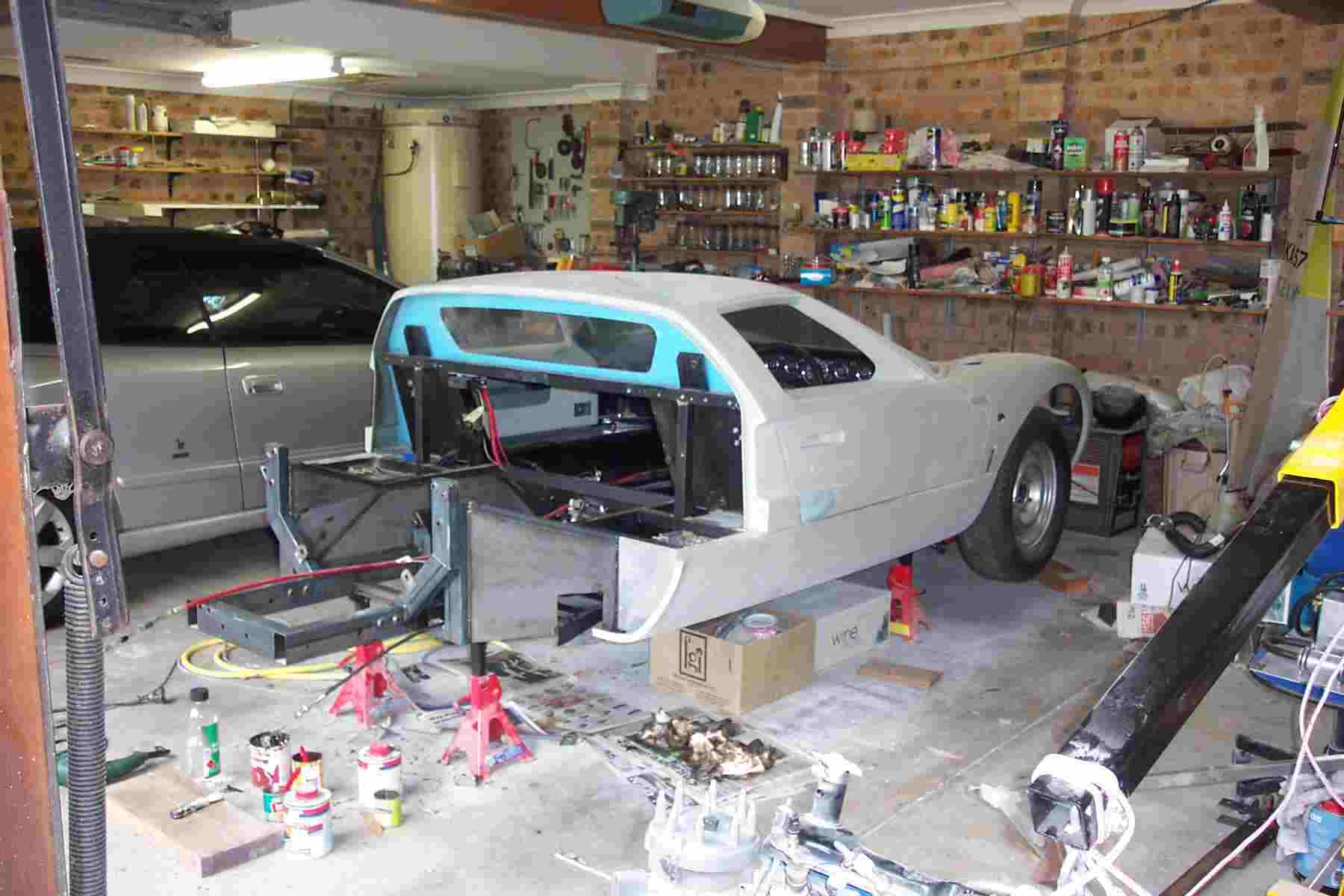

I'll try to post some progressive pics & comments, starting with the "raw material", through to the present time.
This first pic shows the car pretty much as I got it, but with lights, latches, etc roughed in :

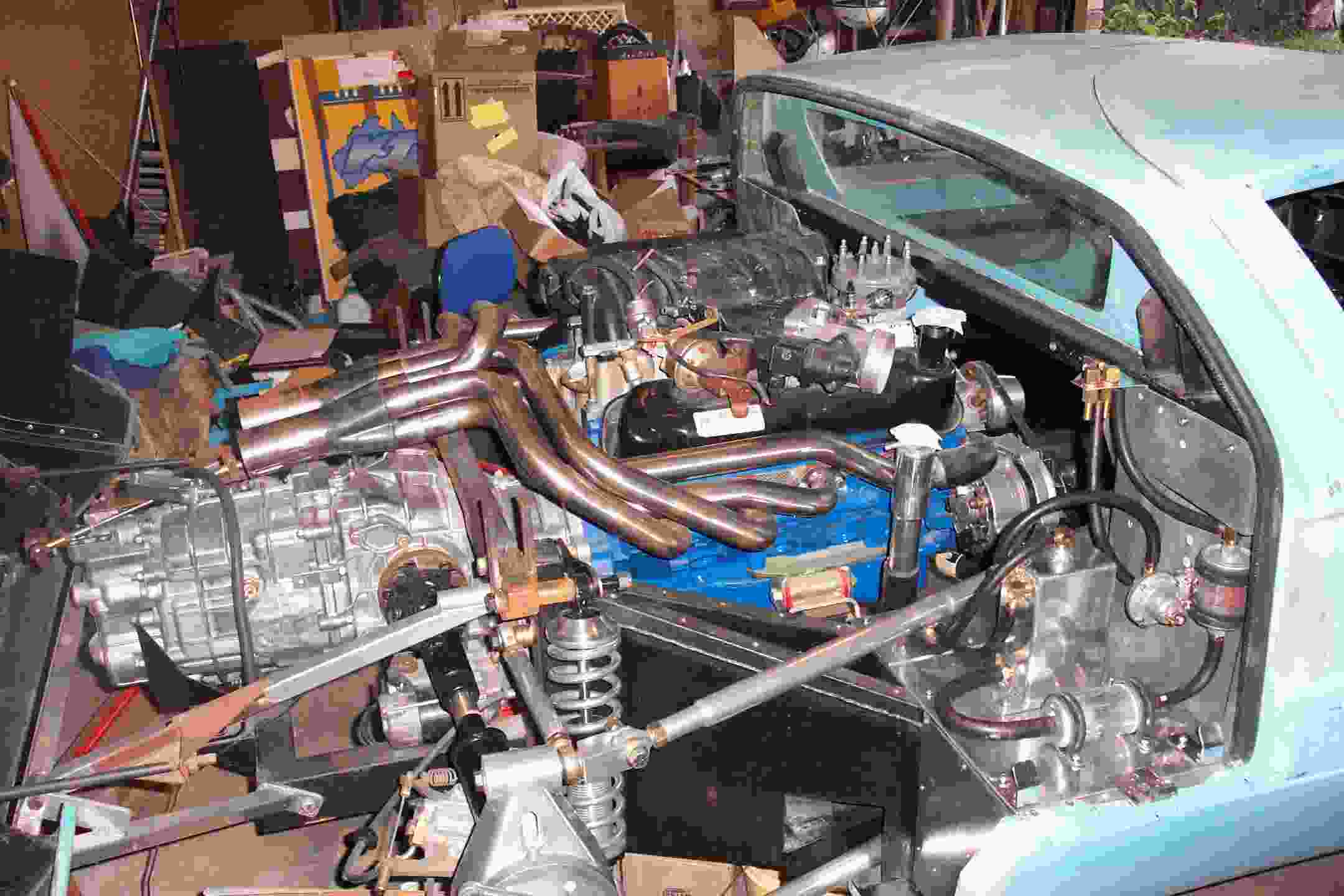

This next pic shows the engine bay with most components test-fitted - note the rust everywhere !

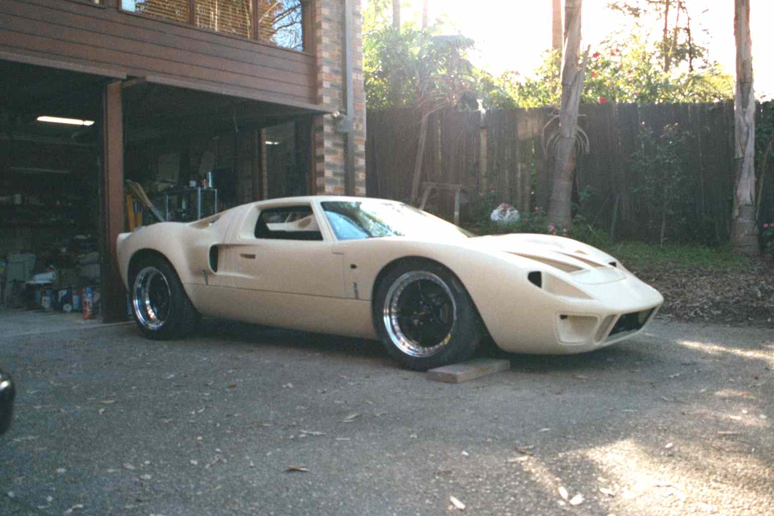

At this stage, I have most of the body prep done - there is about 10metres of chopped-strand-mat over various parts in order to get panel gaps & curvature right (& about 6 months of glassing/sanding/glassing/sanding) !!
The previous owner had kindly covered the whole of the inside front & engine bay with bitumen paint - this took some 2 months to fully remove so that "real" paint could be laid on (this was not a fun time - permanently black hands & clothes, & a wife nearly ready to have me certified) !!

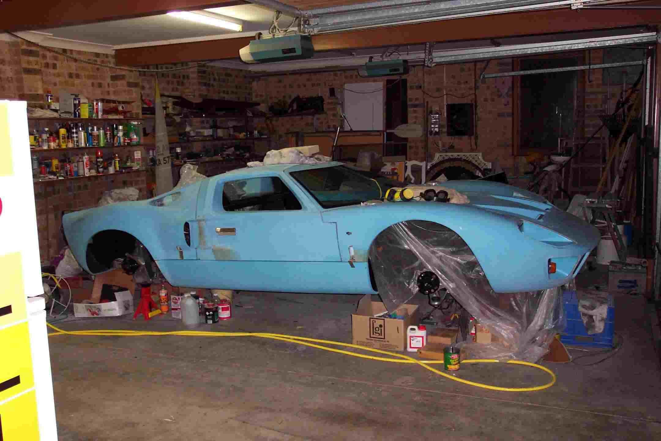

Nearly all the body-work is finished here - I didn't like the idea of "eyebrows" pushing the door tops down in the centre of the roof, so decided to "fix that". Six months later, I had reglassed & machined back the underside edges of the door tops, tilted the doors inwards about 5deg, built up the outer parts of the door tops & leading frame edges, & fixed all the scoop alignments. Eyebrows would have been much simpler !
This pic shows the car after all this & painted with grey Spies Hecker "Raderal" - a spray polyester resin filler that looks after pin-holes & provides a nice even base for the final flat-stick sanding.

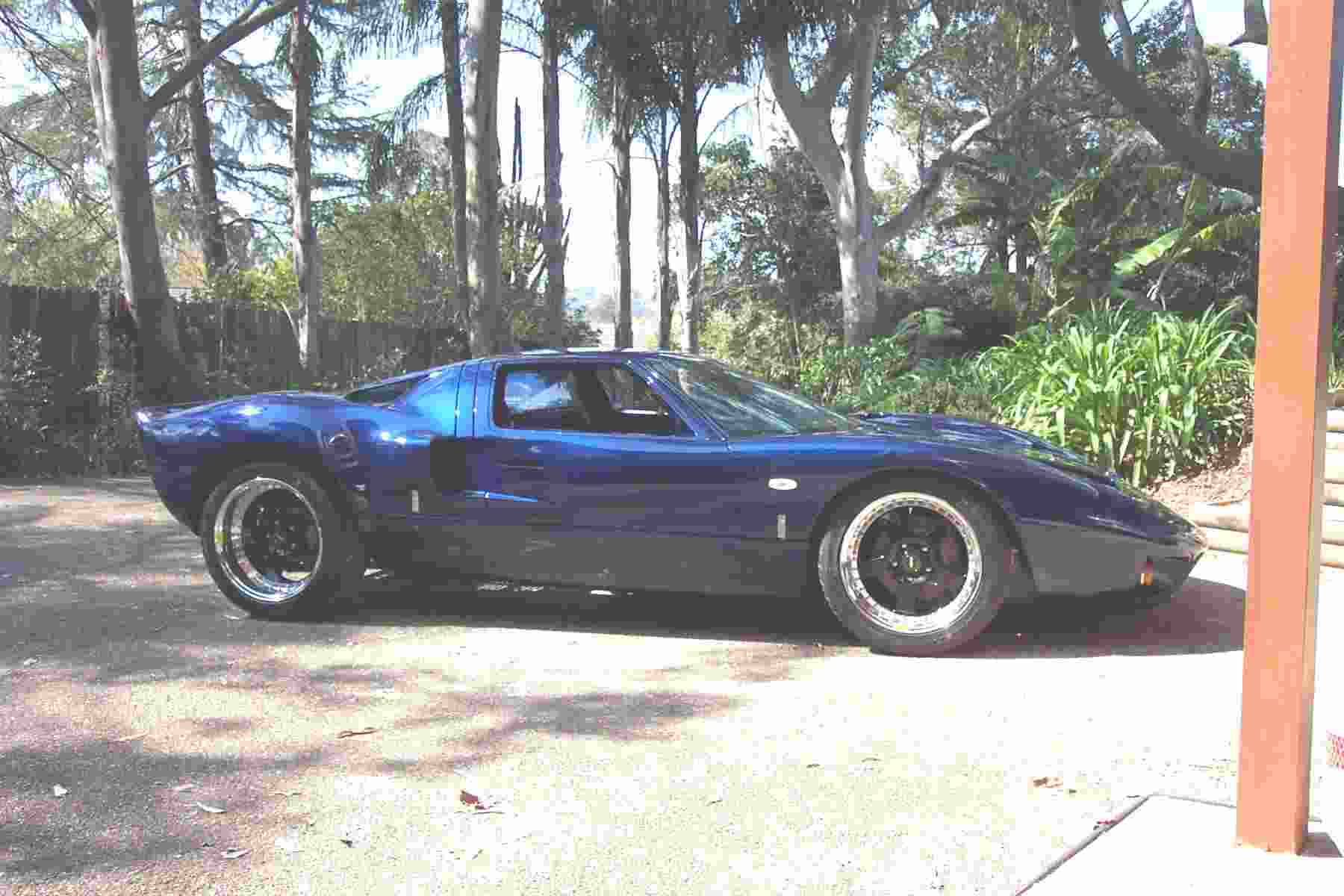

After doing the polyester resin filler & the primer, I decided that the 2-pack clear-over-base was going to be out of my league, so the car went off to a professional. "Not too bad a job for an amateur" he says - then we go on to run a guide coat over the car & spend 70 hours filling over 200 small defects that this revealed ! After touch-ups with the primer & a final smooth-over with 800 grade dry, we hit the painting - Scott did the spraying & I did the paint mixing / gun cleaning, etc. 12 hours later, we had 4 coats of base colour & 4 coats of clear on.
At this point, I was so glad that I didn't try to do the final paint myself !
This pic is just after painting, with some of the lights, latches back on :
