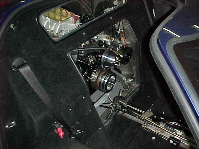

Ok, We are making a little bit of progress. These just in from the guy's at S/C Motorsports in Mustang Oklahoma this morning. Here is a shot through the bulk-head. The pulleys were a B&@#% to sort out. The motor is a 28 ounce imblance, the crank was drillerd for a four (4) bolt pulley (4 bolt is normally found on the later model 50 ounce cranks) and the car was sent with a serpintine belt set up, but a V-belt for the AC. All the serpintine stuff went into the trash and we called March Pulleys. After about ten (10) days, this was sorted. Next, was 'fixing' or perhaps correcting the AC bracket. That's all done now, everything lines-up and looks great. Can't be long now... Nothing is ever simple huh?

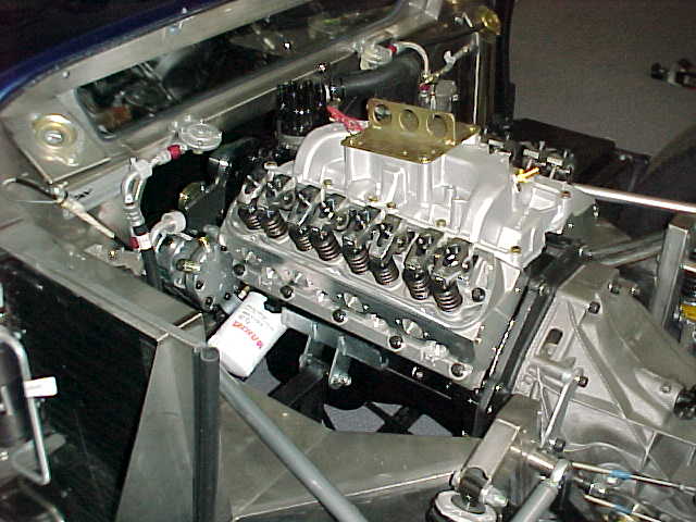

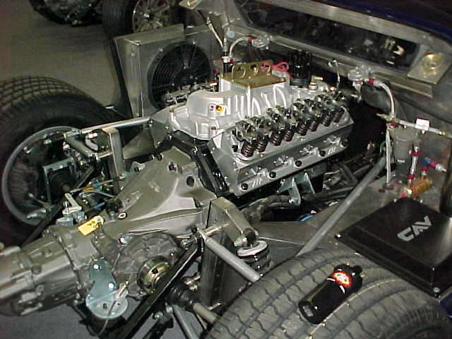

Shot of the right side of the engine bay. Engine & Transaxle went in as a unit. The transaxle is one of the CAV hybrids with the better R&P ratio. Hope it was worth the extra $$$. Halfshafts in. Getting close.

Lastly, a left side shot of the engine bay. The oil filter will be tight. Should have gone with a remote mount filter & oil cooler. Guess I can always do that later.

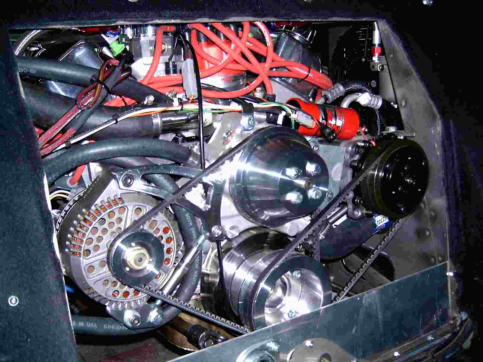

Cars looking great! Attached are pics from our 347/ZF CAV MONO. Oil Filter clearance is no problem on these cars although there are lots of places where an extra .25 would help!
We use March Pulleys and Alternator Bracket. Fits perfect and excellent quality.
We modify the CAV supplied A/C bracket to make it turnbuckle adjustable just like the March setup for the Alternator. Works great, simple cut and weld to factory bracket, a couple of rod ends (left and right hand thread) and your home free.
We modify the CAV supplied A/C bracket to make it turnbuckle adjustable just like the March setup for the Alternator. Works great, simple cut and weld to factory bracket, a cross bar between the water pump and back of the bracket (Cross bar not shown) a couple of rod ends (left and right hand thread) and your home free.
