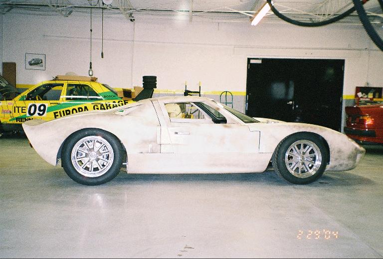

pic ...ooops try again

Alain, How do you like the Team 3 wheels? Did you buy the center cover with the wheels and, if so, how does that look?
Did you buy the wheels direct from Team 3 or one of the distributors?

What size tires?

I ordered them through Richard Oben at North Racecars.
Richard buys quite a few wheels from Team 3, and it only took a little over a week to get them.
The pic doesn't show it very well. (I don't have a digital camera),,,but they do have the bolt covers and they look great.
I used to have PS engineering wheels on my cobra, and the Team 3's have a much nicer finish on them.
fronts are 16x8 with sumitomo htrz 205/55,,,
and rears are 16x9 with 255/50s.
I thought about it for quite a while and am very happy with deciding to use 16 inch wheels.
I just don't like the low profile look that the 17s have. They look "out of place" on a 1960s period car in my opinion,,,,,
and since trhere is no decent Z rated street tire available in 15 inch,
I decided to use 16s and give up a little rear width (the widest I found was 255), but keep a decent looking sidewall height.
The tires were pretty reasonably priced too.

Does Team 3 make 16" knock on's. My MDA should be showing up in about a month and I'd like to find a set of 16" Halibrand style knock on's. The car already is being shipped with the pin drive hubs and spinners, I just need to find the wheels. I definitly like the look of the 16"s and like the Halibrand style over the BRM. Who's selling them.

Team 3 only sells lug-wheels. As far as I know, Phil at PS engineering and Lynn Park at Trigo wheels are the only ones making pin drive wheels in the US. However, Trigos are only available in 15" and I am not even sure if PSE has 16"s.
If you need contact information I can look it up.
