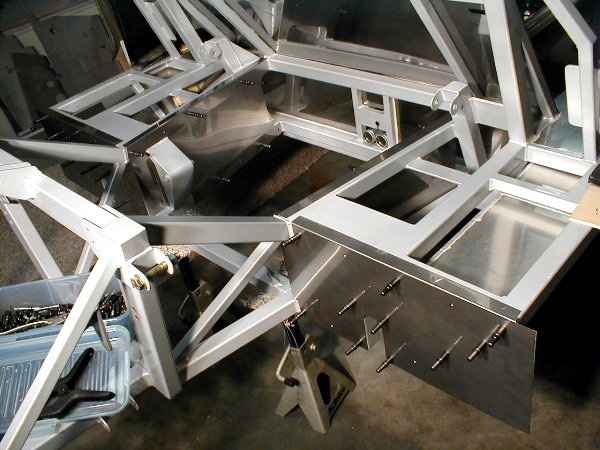

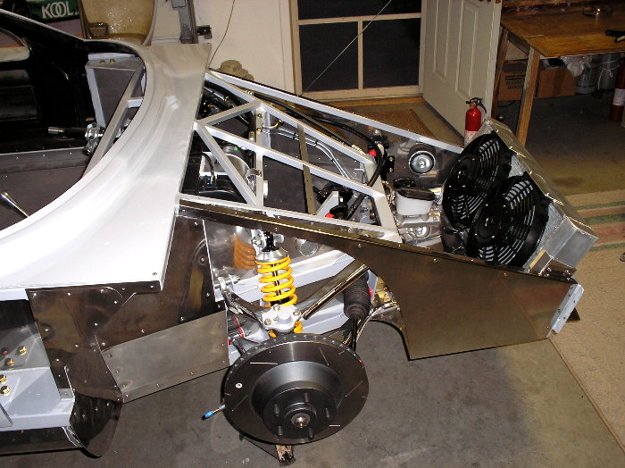

Well its been a while since I posted . I thought Id be done with the most of my sheet metal by now . I took a little break from the car , Got caught up on the house chores , took care of my other vehicles needs, and thought Id get back on the GT . Then the flu hit me, then when I was over that,I was lifting up one of my antique console radios and twisted wrong while lifting,,, ouch. So Im on the mend and just starting to work on the car again.I made my radiator tray today and that was about all my back could handle.
Since I last posted I made the radiator side panels (I call them sail panels). I cut new ones from sheet and they extend all the way up the upper front tubes instead of stoping 2/3 the way up. Also I have finished locating,drilling , and countersinking my seat hold downs.I am using flush fasteners coming up from underneath.
So I guess I can finish the side tunnel next to the drivers seat and locate my pedals and go from there .Oh I almost forgot,,, the sheetmetal that sticks out on the aft edge of the front wheel wells I am covering with that foam slotted pipe insulation covering. After ripping my legs open numerous times because its hard to see when your walking around the car I dug some of this spare stuff out of my attic. Havnt hurt myself since [img]/ubbthreads/images/graemlins/smirk.gif[/img] and dont crash into it either . Highly recommended .Regards Dan

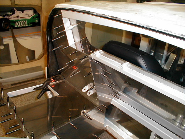

Well I have been getting back on the GT . I made a new front bulkhead panel and secondary bulkhead panel. The ones that came with the kit had a few holes in the wrong place , so I cut new ones. I also just finished making the drivers left hand console today . The side panel is removable and I made an extension on the front and a new panel on top. Hopefully I can run everything I need to through that fwd angled "channel " If not I'll modify it. That way when the dash is in place you wont be able to see any plumbing going through that area. I also shortened the aft end at the top so it doesnt come into my side rib area and is about even with the seat back, seems like this wont catch my behind [img]/ubbthreads/images/graemlins/shocked.gif[/img] , when I swing into and out of the car. [img]/ubbthreads/images/graemlins/grin.gif[/img]

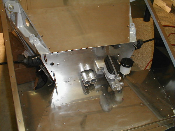

Have the master cylinders tacked on temp. After I Finish making the last holes for the brake lines in the bulkhead I'll shoot and seal it on.

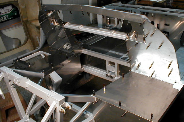

Well got some more done today. I made a new R/H sill rear panel, (the one from RF has a hole in it for a RH drive car shift linkage).Got the left side done and the inner lower engine panels. Still need to polish them and shoot them on, but will hold off on that to help with the plumbing job later.

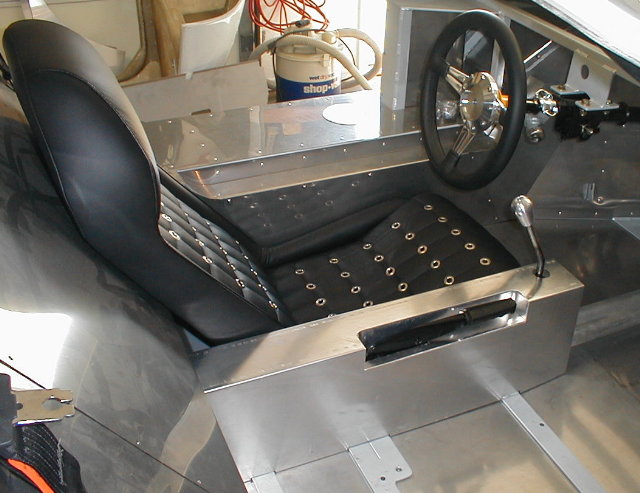

Wow , where did 2 months go ?? Well I finally have been working on that center console . I located the parking brake in the same fore/aft position, but instead of mounting it on top of the structure ,I bolted it below the R/H tube. I still should have room for the shifter cables .
I then made the height of the console about level with the driver's L/H console. When seated in the car my right elbow has a good resting place if I wish. The hole for the shifter will be trimmed larger at a later date .I feel very nice and "snugged" in , reminds me of one of my past formula cars. [img]/ubbthreads/images/graemlins/cool.gif[/img]

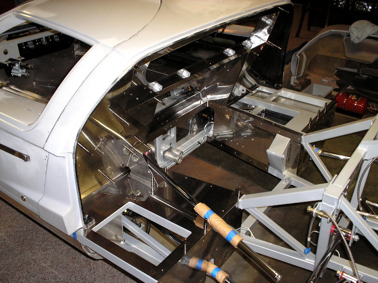

Thanks Rolf, hope all is well with you and yours. Here is a pic of current front Dan. A/C is also hung and lines hooked throughout except to condenser.

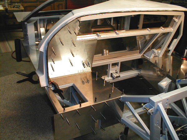

And the rear 3/4 as it sits. The "D" panels are not shot on , nor the tops of the area above ther rear tanks. The door handles / latches are fit and have to get the aft part welded up to size before I shoot the rest on. The under side fuel plumbing is 95 % done on both sides as well.

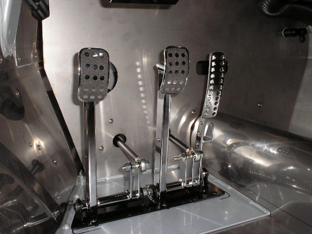

Here is my modified RF "early" pedal box. When you move it to the LHD side the push rods don't fully line up with the "ears" on the pedals. I added a third ear to the brake pedal instead of just off setting it. I then swiss cheesed it to give the gas pedal a different look and then radiuses the other pedal pads to give them a more round corners. The non skid was removed, trimmed down and hole punched. I am going to get some more and redo the non skid .Note , FYI temp fasteners in the rod ends just to get things "tacked up" and will be adding spacer inbtwn the ears.

Dan,
I did the same off set with my pedals. That is the best set of pedals I've seen in an RF. That is one outstanding creative effort. I wish I had thought to do that.

Thanks Hersh, I wish I would have drilled the holes in the brake and clutch pedals too , then maybe make slightly larger holes in the non-skid and that would have looked better. If I have anything else plated maybe I'll drill them and take them to the plater again. [img]/ubbthreads/images/graemlins/crazy.gif[/img]

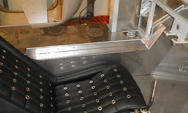

Re: Roaring Forties #091

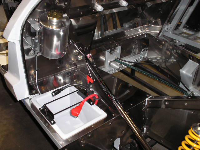

Well I have ran my bleed line through the console, then over into the L/H side and up to the tank. I polished the tank, did a final polish on the D panel, and the aft sill panel and finally shot them on. I made a small bulkhead panel just inboard of the battery box and mounted my mega fuse junction block to it . I removed the bracket that held my tank valve and mounted it to this panel also. Keeping the mega fuse box under the sill will give a cleaner look .All premade cables still shoud reach and some actually be a bit long,,, may shorten the hot lead from the switch to the fuse block. [img]/ubbthreads/images/graemlins/1poke.gif[/img]
