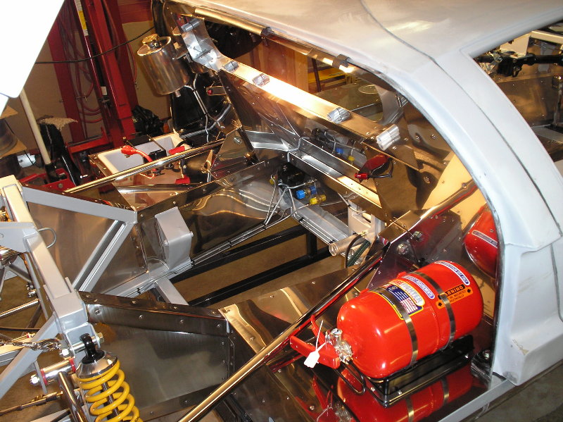

Other side done and SPA fire bottle mounted and lines and nozzles done in engine compt. and fuel tank/pump areas. Stll need to route pull cable and lines in cockpit . [img]/ubbthreads/images/graemlins/beerchug.gif[/img]

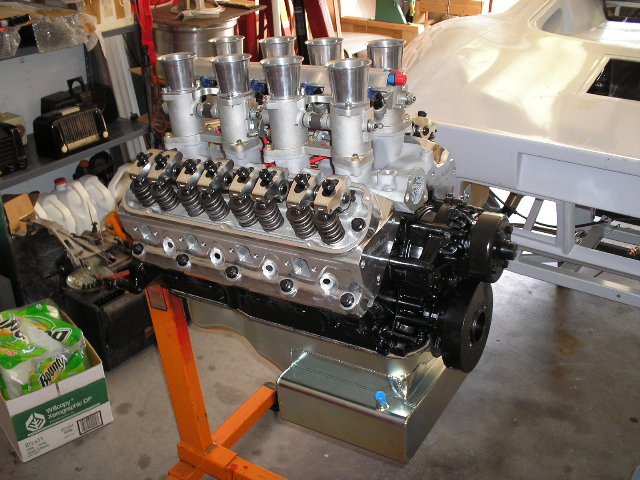

347,self assembled,,,massaged edelbrock performers,scorpion rollers,moroso pan, x303 cam,,,, TWM is just sitting on top of completed long block. Need to machine my "bleed ports" from the aft end of the intake so I dont get the air pockets in the top aft end of the heads .

A man of so many talents. Looks very sweet Dan. [img]/ubbthreads/images/graemlins/cool.gif[/img]

Dan. Looks great, Have you sat in the car yet with your transaxle to see how it all fits together?
Which Moroso pan did you use?

Hi Dan, it's their 9 qt street strip road race pan.Part # 20503 . I have not put the motor in and the gearbox. I sat the block only in once with the oil pan on to make sure it would clear the cross member. One thing I did notice during putting the motor together. I could only bolt the oil pump to the block opposite of the normal place, and the oil pan could only be bolted on backwards as well. When I flipped the engine over I also discovered the hole for the distrib was cast in the wrong location as well. I am hesitating putting the motor in as I don't know which way to face it ??? Ha-Ha
Thanks Hilly , but I wish mine had color on it like yours and my motor was still laying in pieces,LOL !
