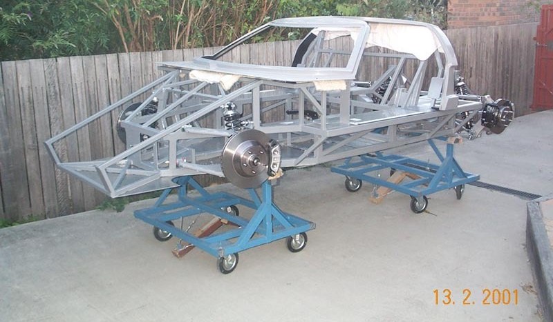

I thought it was about time I posted a few pictures. I will do this gradually. The first picture is the painted chassis. I painted it myself with a brush. This turned out not to be the best way to do it but all well that ends well, I guess. In the picture I had test fitted the suspension before most of the paneling was done. The suspension came off again while the panels were fixed. At this point I was ringing RF very regularly. The telephone support provided by everyone at RF has been well documented on the forum and is as good as people say it is.

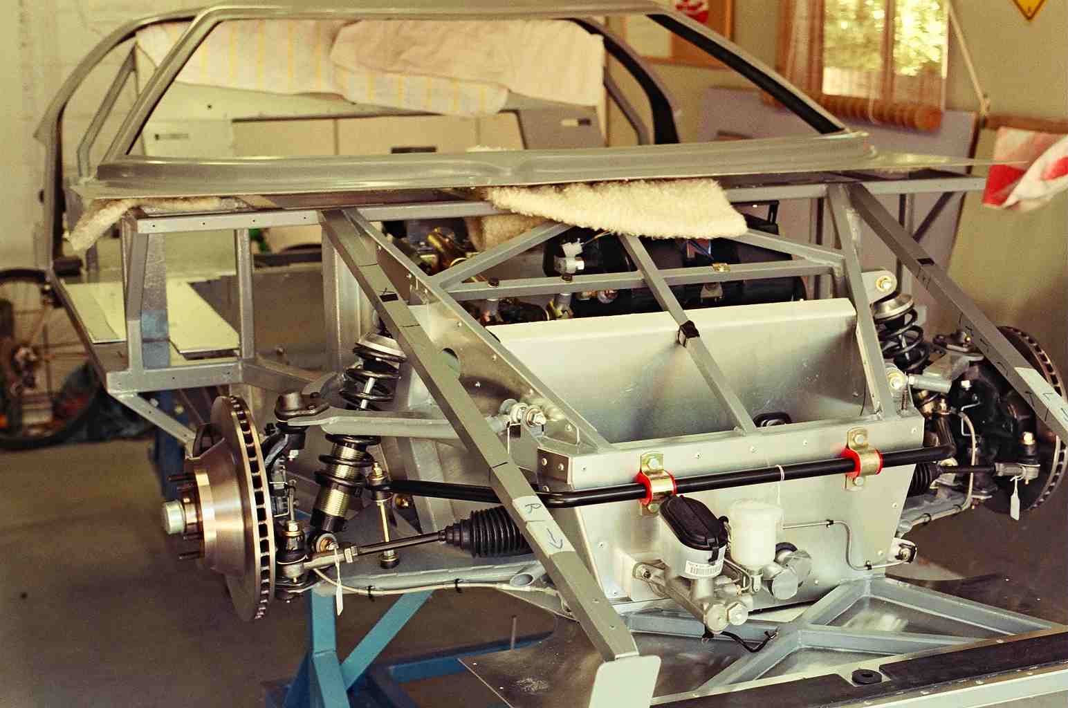

Well the pictures work at least. Some time later some more of the paneling had been fitted and some of the functional bits, steering brakes and suspension were in place. Still asking lots of quesions, and getting lots of answers. Is starting to take shape a bit, at least it looks less like a bathtub than it did when the panels were all temporarily fitted.

John,
Lookin' good ! I like those dollys you have so you can roll the chassis around.
You need to get busy on that thing like a lizard drinkin' flat out! [img]/ubbthreads/images/graemlins/grin.gif[/img] [img]/ubbthreads/images/graemlins/grin.gif[/img]

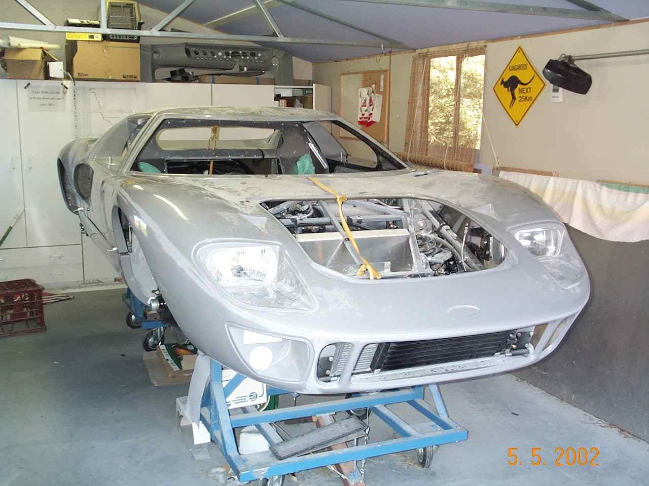

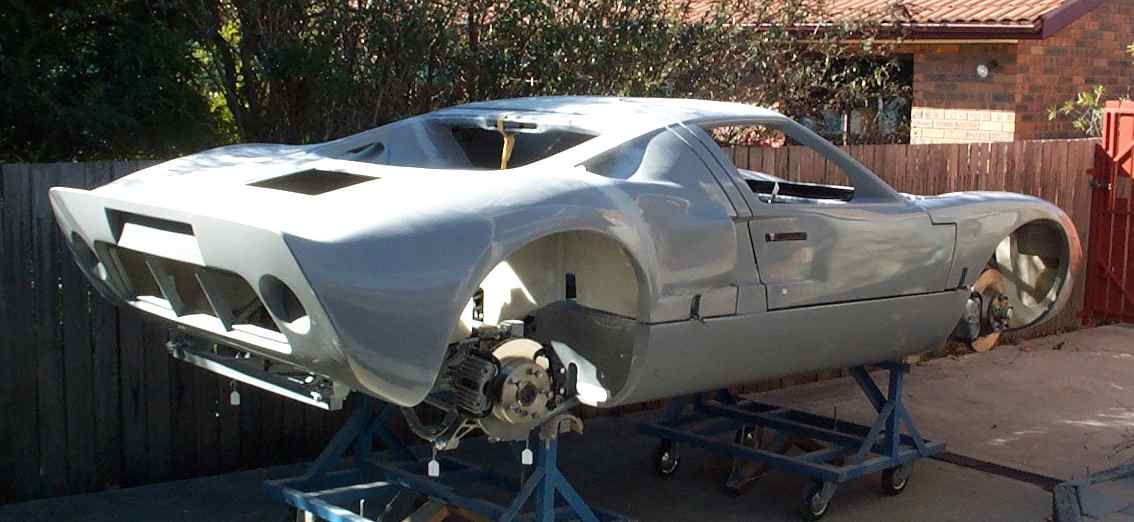

We move ahead to having the body on. I don't know about everyone else, but I thought this bit was hard. Its relatively easy to grab a drill and start making holes but its harder to be sure you have the parts in the right place.

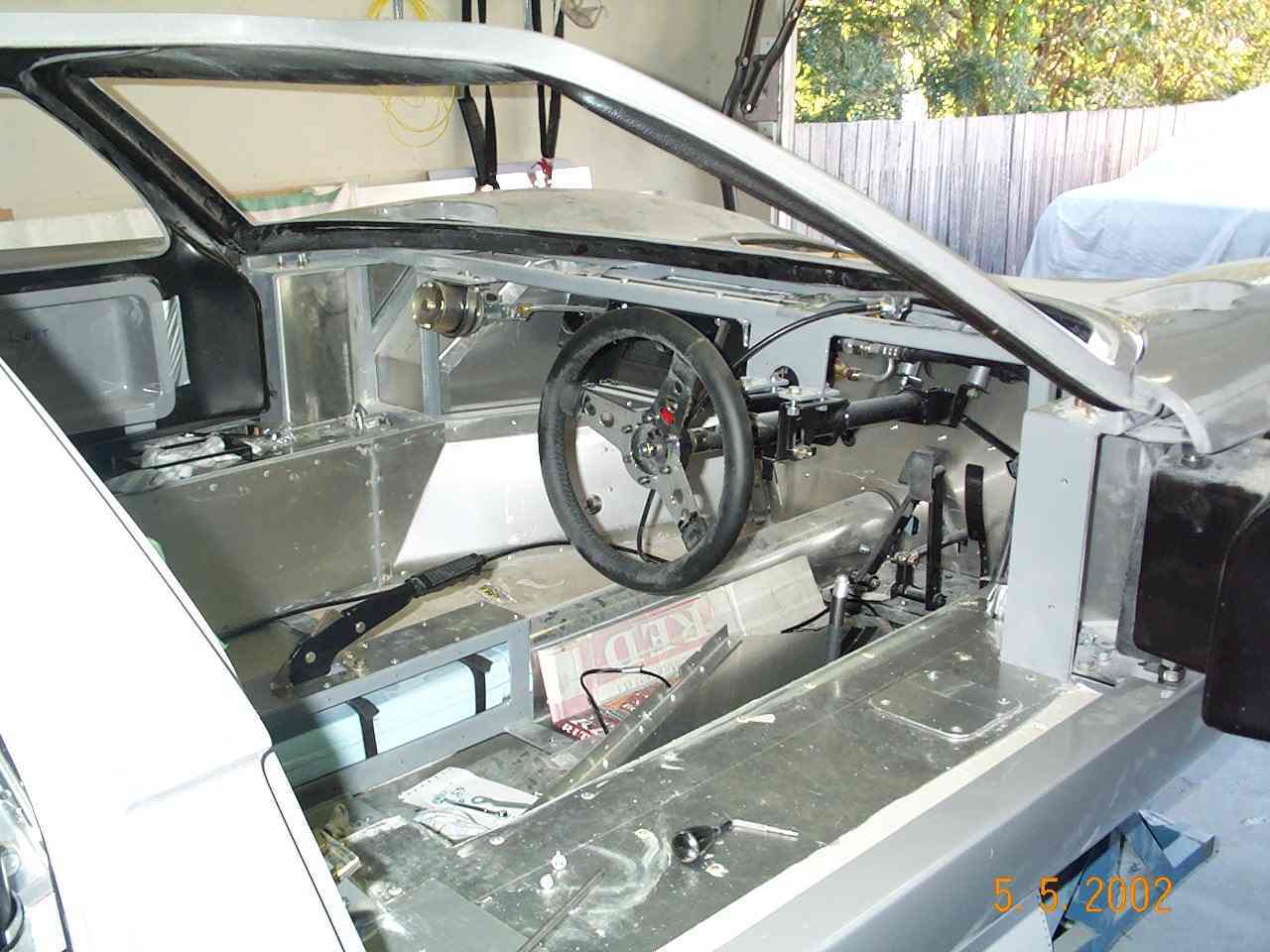

RF were still getting a lot of calls at this stage too. These were being handled in the usual manner (really well). It was still the most difficult part from my point of view. Still all's well that ends well. An I think it did come out OK in the end.

Re: Roaring Forties #24
WOW!! Now that's progress! [img]/ubbthreads/images/graemlins/grin.gif[/img] [img]/ubbthreads/images/graemlins/grin.gif[/img]
I know what you mean about drillin' them holes John. It
seems to be going nicely now. Keep it up and you will be
dodging those speed cameras before you know it.. [img]/ubbthreads/images/graemlins/wink.gif[/img]

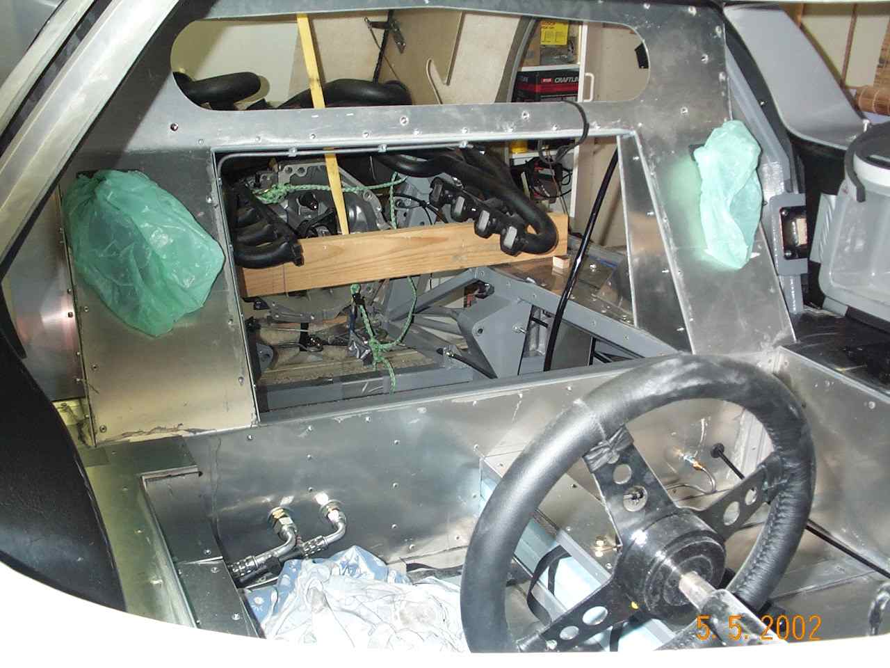

The next bits are inside views with the body and most of the panelling in place. By now I'm getting tired of cleaning the dust off everything. At least its starting to look like a car now.

And the back of the cabin.

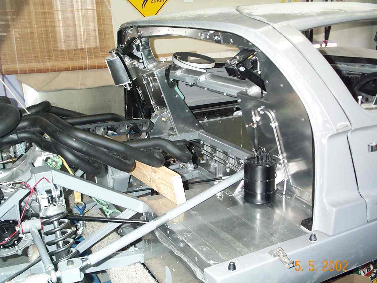

And the engine bay. Still lots of work to do here, but it seems to be coming out OK.

John-
How does the cockpit seal against the spider?
Bill D

Rep Power: 9 John Lind is on a distinguished road
Hi Bill
At the front it will just have sealant between the spider and the chassis rails.
At the rear there are 2 different types of rubber seals between the aluminium firewall panel and the spider.
On the sides there is a simple edge strip on the metal panels which seals against the fibreglass.
At the top there is a larger pinchweld seal (a bit like a door seal). This fits on the firewall panel like the sides. The only real difference is that it is larger so that it can fit into a recess which is in the bottom edge of the spider. The recess is to allow the rollbar, which is part of the chassis, to fit into the top of the spider.
I hope that makes sense
Regards
John

Old 11-10-04, 12:05 AM   #17 (permalink)
Join Date: Jan 2003
Location: Chairman dept of Surgery, Mc Cullough-Hyde Memorial Hospital, Used to fly a T-33, looking forward t
GT40: Oxford, Ohio
Posts: 186
Rep Power: 7 rbrunckhorst is on a distinguished road
Just curious. Are you painting the exhaust pipes black?
Thanks Dan. Yes the green air bags are the high performance ones. Don't settle for the white ones.
John

Posts: 147
rbrunckhorst
The exhaust system is ceramic coated (jethot etc.). Its supposed to limit the heat radiation from the exhaust. It seems to help a bit with the temps under the rear clip but it's not as good as I would like.
Regards
John

Posts: 2,381
Thanks John. It makes sense and is perfectly clear.
