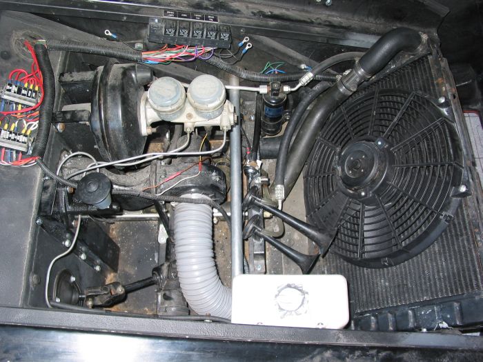

Re: GT40 Australia #32 - Time for Rebuild
Just thought I would include a photo under the front clip. Wow, what a mess. [img]/ubbthreads/images/graemlins/smile.gif[/img]
Needs a tidy up and decent detail. Should look the part then. Another job to add to the list.
