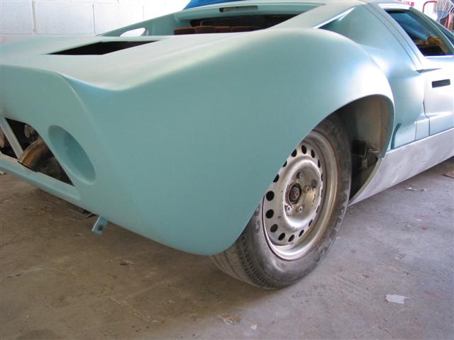

Rear shot...I have just finished trimming up the guard lip to match the lip on the guard. The lower sill had to be built up to match the clip, so ended up with a very wide guard lip on lower sill.

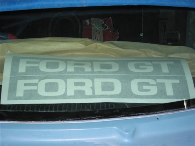

Some more photos of some of the more interesting stuff I've been working on.
Here are the decales for sill stripes. These are reverse templates and writing will be spray painted on and of course the stripes masked up. Haven't decided whether I'm going the twin stripes on new GT or wide and 2 narrow stripes each side of old GT's. Decided that I like the lettering the way it was done originally(solid), so meant that the template could be ordered at least.
I'll leave the decision about the type of sill stripes, to the very last minute. [img]/ubbthreads/images/graemlins/grin.gif[/img]

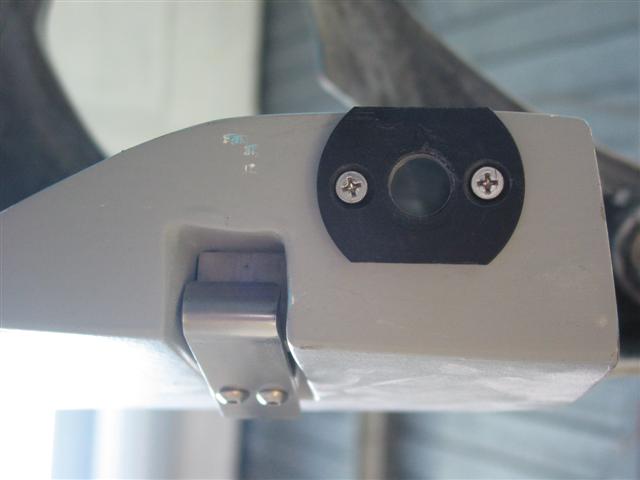

Photo of spigot bush(female part) on the front clip. Earlier I posted a photo of male part of spigot.
The spigot bush is made from nylon and has a raised centre area that locks into clip and gives spigot some extra depth. I bought spigot kit from DRB factory.

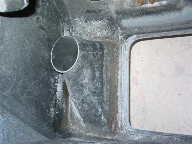

Here is a photo of front brake air intake ducts that were glassed onto the body. DRB GT40 comes from factory(and by looks of it hasn't changed) with housings glassed in to mount indicators in brake duct holes.
I've decided to retrofit brake ducts. Did not buy the factory kit as I wanted 3" brake hose. So made up some ducts from mould supplied by local brake shop. I've started to regret the decision of 3" ducts as these were very hard to squeeze into front clip, fingers crossed I can engineer the 3" hose into the equation as well. [img]/ubbthreads/images/graemlins/confused.gif[/img]

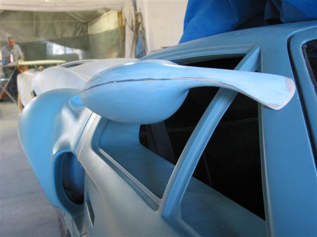

And finally the mirrors fitted. These are the high mount DRB mirrors, available in manual or electric form. Mine are manual. May not be original looking, but they give fantastic vision to rear. You can actually see over the rear clip and help with rear vision directly behind the car, even when setup for standard rear vision for lane changing.
I considered these essential once the Gulf guards were fitted.

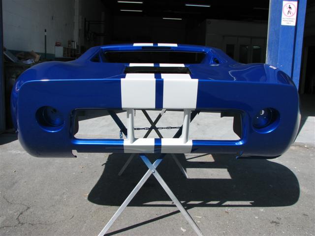

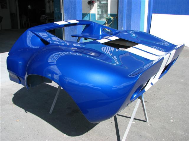

More delays, I've been sneaking in some last minute changes. But now it's finally getting final paint.
Here are a couple of shots of the rear clip painted.
Subaru WR Blue Perl. Paint Code - 02C
Subaru Artic White Perl stripes (has white base and separate perl/mica coat, then put clear on). Paint Code - 36J.
Stripe Width: 170mm with 40mm gap.
Also paid a bit extra labour to get stripe edges rubbed back so that they would be semi-smooth - no hard edges.
As you can see, definitely not building an original looking GT40.
Will post more when I have more photos.
