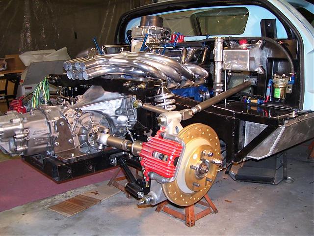

Well the T-3 is finally done ( for sale !), so I can get back to work on the
DRB. It's also for sale (two daughters in college), but realistically I don't expect to sell it until it's at least driveable. Car buyers tend either to want
projects they can invest their own sweat equity in...or they want to just
hop in and drive. Not a big demand for expensive cars that don't run.
Anyway the suspension is in, brakes are in, engine/trans in, and now starting on the wiring. The DRB of course is based on the G50...but having (3) 016's
laying in the garage I decided to go that route instead. A simple notching
of the rear cross-member and raising the engine a bit did the trick.
You can see the shafts angle forward slightly...but not too bad.
Happy Holidays to all.
MikeD

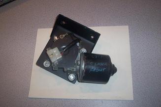

I spent nearly all Winter on the wiring...combination of insufficient
will power...ice cold concrete floor...and my back hating to crawl
under the dash. Anyway it's done and I'm now testing the circuits,
and of course I've hit a snag....the wiper motor doesn't work.
It was supplied by DRB...presumably from a passenger car...maybe a "Lazer" ?
Does anyone have any idea ? Hopefully there is a crossover to a US made car,
although I'm a bit worried since the wiper is stamped "made in Australia".
I'll post a photo as soon as my daughter returns my camera !
Thx
MikeD

Hey Mike
I used a laser wiper motor/ laser steering column/ laser wiring harness so all works well. If you want a Laser wiper motor let me know and I'll post you one if you like.:)
Dave
That would be GREAT ! I'll be happy to cover your costs.
Here's a photo of my...it's stamped with:
AB09267350-AA
12 volts (duh)
Preslite
And as you can see..in blue marker it says
KE (?) Laser Front
What kind of vehicle is that ?
Who was/is the maker ?
Thx Dave
