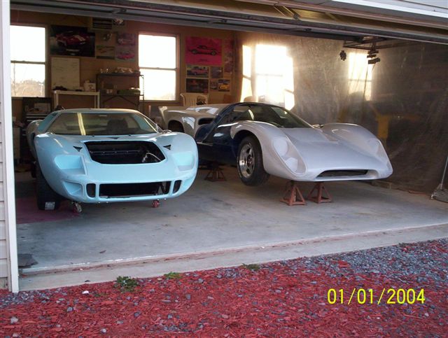

I apologize for not posting sooner, but I'm embarrassed
over how little progress I've made so far. Hopefully things will move a little quicker now. Time will tell.
Thanks to Dave Harris for use of his casters.

Here's one of the reasons the DRB has been delayed.
There's quite a bit of similarity between the two...
hopefully that will result in some efficiencies on my part.
Again...time will tell.

WoW Mike, that is a garage to envy already.Imagine how it will look when those two beauty's are finished. [img]/ubbthreads/images/graemlins/ooo.gif[/img]

What's that yellow car, hiding behind curtain #1?
Fatal Attraction is offline

Mike, you are a very, very naughty boy - posting a pic like that ! It got me thinking that if I clear out all of the cr*p from the GT40 build, there would be space for just one more project ! What's happening to me - aaaaahhhh !
I wonder what is the correct collective noun for multiple sports racing cars - a "brace of racers", a "pride of prototypes", a "herd of historics", etc. ?
Absolutely bloody beautiful !!

The yellow peril behind the plastic is the T-3.
It's been banished to the cold side of the garage.
That's another reason the DRB hasn't progressed.
It took me an enternity to get someone to complete
the exhaust system (stiffed by George) at a reasonable
cost. And the rear clip must be repainted, which
will have to wait until warm weather returns.

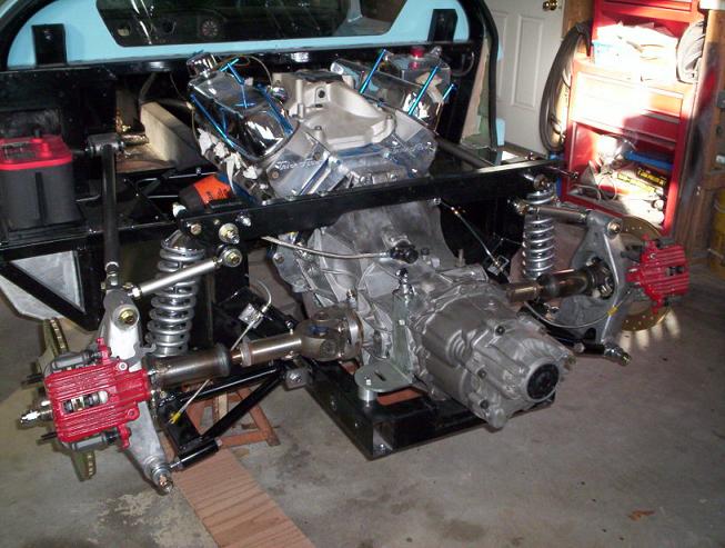

Well the T-3 is finally done ( for sale !), so I can get back to work on the
DRB. It's also for sale (two daughters in college), but realistically I don't expect to sell it until it's at least driveable. Car buyers tend either to want
projects they can invest their own sweat equity in...or they want to just
hop in and drive. Not a big demand for expensive cars that don't run.
Anyway the suspension is in, brakes are in, engine/trans in, and now starting on the wiring. The DRB of course is based on the G50...but having (3) 016's
laying in the garage I decided to go that route instead. A simple notching
of the rear cross-member and raising the engine a bit did the trick.
You can see the shafts angle forward slightly...but not too bad.
Happy Holidays to all.

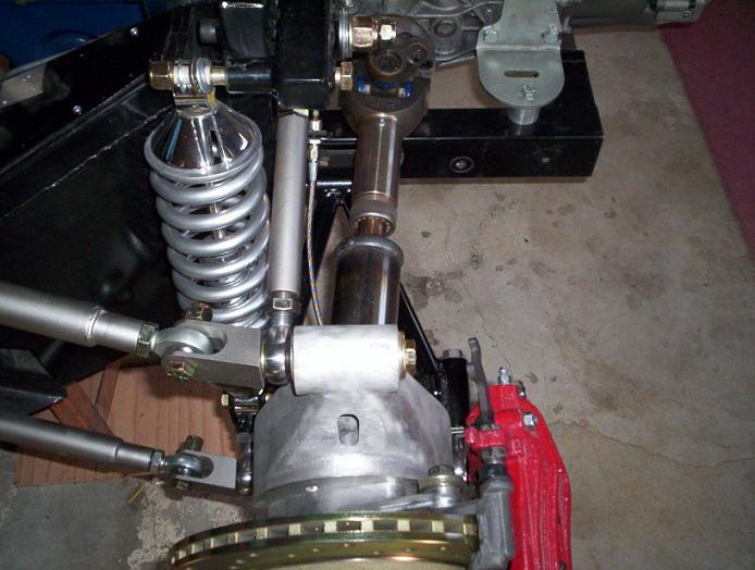

1988 rear calipers with built in parking brake...
