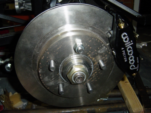

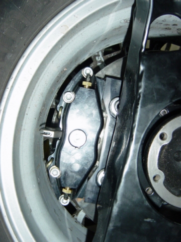

Well they're on - Wilwood's Powerlite Rear Handbrake caliper. A BIG THANK YOU to Frank Catt, who very kindly came up with the bearing carriers.

And for all of you who are interested, here's what it looks like with a Granada 15" wheel on from the inside.

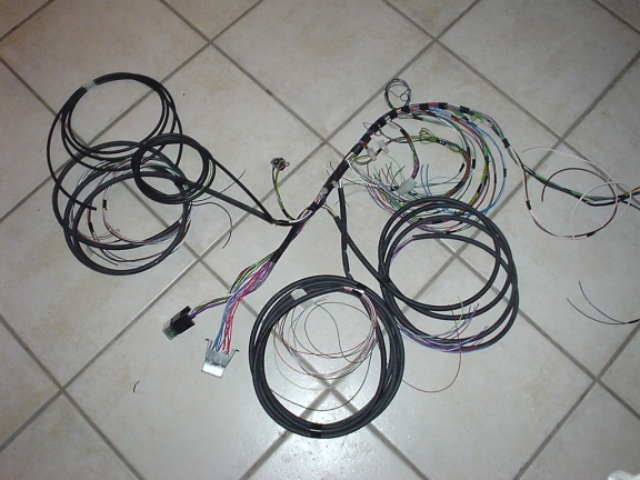

Well the wiring loom arrived yesterday... oh what fun I am going to have over Christmas :O)

Brakes are looking good Brett, and a lot of good progress in general. I dont envy you the wiring job, and esp over Christmas, you shouldnt Drink and Wire.

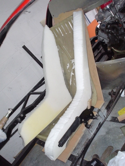

Well Christmas was disaster and had no time and then skiing throwing myself of off-piste cliffs . Luckily I didn't damage myself this time,so I managed to get a few hours and start to look at how I was going to trim the seats I got from Brian M. I think the upshot is that I will probably build a small centre section to house the handbrake, and also provide some lateral support. Any one got some good tips on trimming?

Good quality trimming means paying money. Average trimming you can probably do your self.IMHO. What are you going to trim with? Alcantara is one material quite easily done at home by her indoors. Real leather or suede
needs real expertise.

I have the same seat shells and the recline angle is not adequate. I fabricated a metal wedge to raise the front. Be sure you are pleased with your seating position before you commit to covering them!
Dave M
Dave,
I'll probably do the trimming myself with Alcantara. My mother-in-law is a former seamstriss, so I may be able to puusuade her with some pattern making... hopefully .

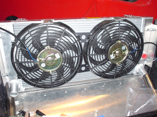

Managed to get in the garage to night to finish of fitting the fans to the radiator.
Neal,
What thickness foam did you end up having on the seat bottom? Thanks

3/4" high density on the bottom. Not much cush for the tush but sufficient.

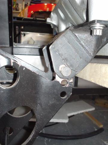

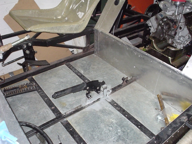

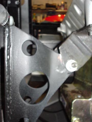

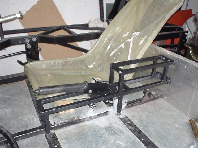

after having to do that very necessary job of tidying up this morning, I didn't have much time to what I really wanted. Putting the handbrake cables in. So I came up with a piece of inspiration (well to me anyway). When I bought the chassis off Roy Smart, he installed some of his engine mounts, which allow you to lower the engine. My goal has always been that I would have the engine sitting at the lowest setting no matter what. It gives approximately a 1.5" lower position in the chassis.

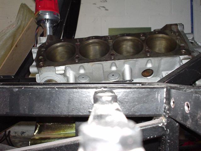

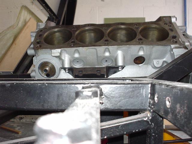

So after a bit of huffing and puffing, I finally managed to getthe engine back in. Its not actually a problem, but the Audi gearbox front casing that attached to it is! I always knew I was going to have to modify the rear. Now I really know. Hopefully you can see the before and after of the engine. I tried to sit the camera in the same position on the sill. You'll have to excuse the angle for the moment on the block!
