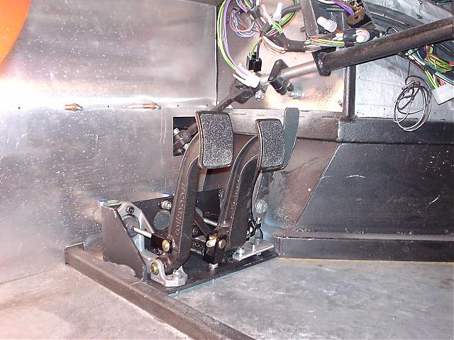

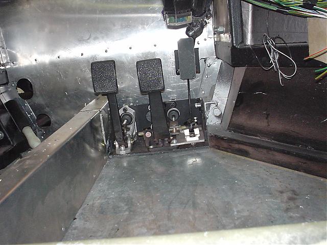

Made the pedal box this weekend and finished it off tonight. Just got to make the brackets to attach it to the chassis to allow it to adjust slightly.

The pedal box more formally in place, with the beginning of a centre tunnel...

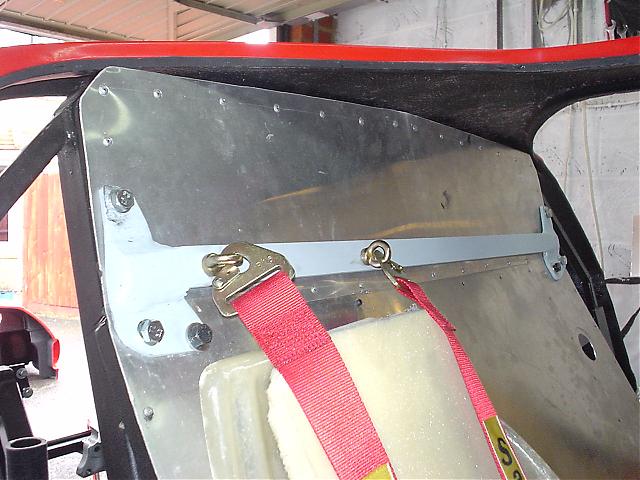

Harness bar done, just have to get it powder coated

Hi Brett,
It looks as if you have a similar problem to mine when I bought my car - the shoulder harness eyes aren't vertical. This means the harness has to twist before it can lie flat.
The answer is shim washers. They fit between the eye and the harness bar and can be peeled off at, I think .005" increments. You fit the minimum thickness to allow you to rotate the eye the minimum distance to get it vertical.
I probably have some left over - e-mail me.
Tony Hunt

Thanks Tony,
I'll see how it comes back after powder coating.

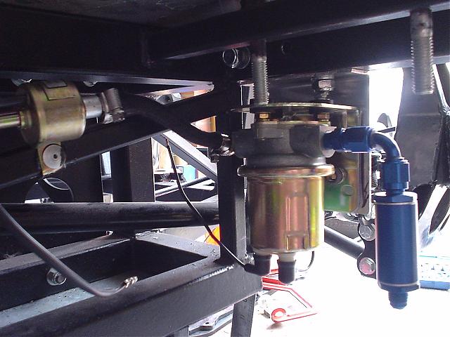

Progress slow, but at least in the right direction Started to put the fuel pumps in and will finish them off after lunch.
Got a call from Helix yesterday saying my drive plate was ready. I am hoping that CTS can get my transmission together next week now, so I can see if this experiment of Kennedy 016 plate to an 01X box will work...

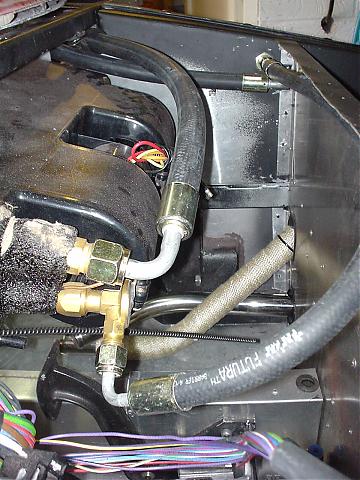

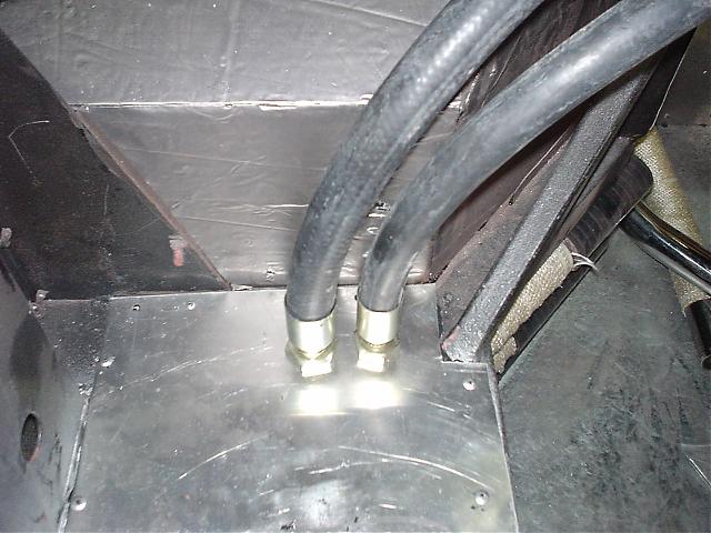

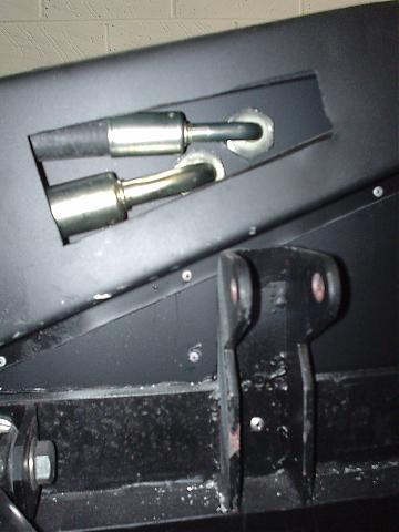

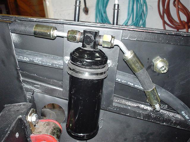

Thanks Simon, started running the aircon hoses this afternoon, and found that I need a couple more connectors the way I have run it.

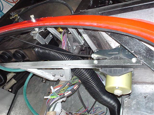

Anyway, wiper motor mounted along with the drive, though I will wait to do the final tubing until the spider is mounted.
