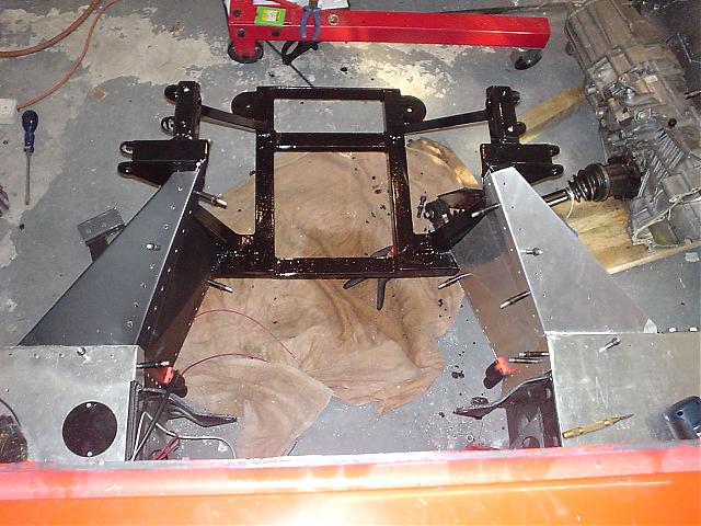

Step forward that great metal surgeon Dr M Sollis and

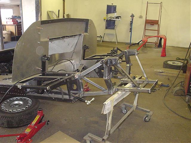

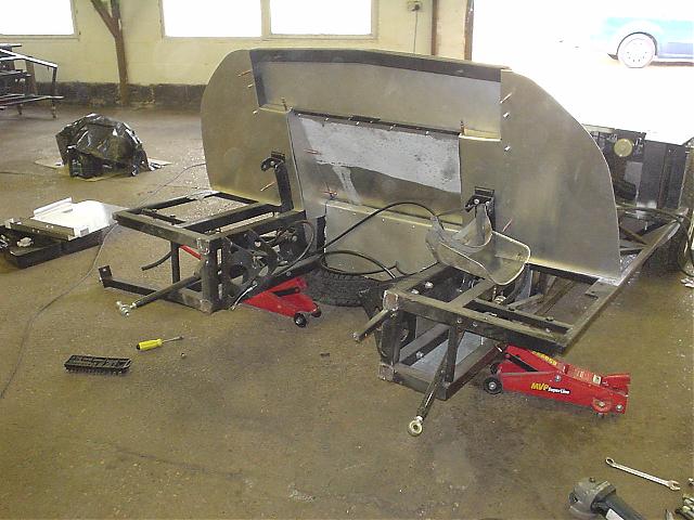

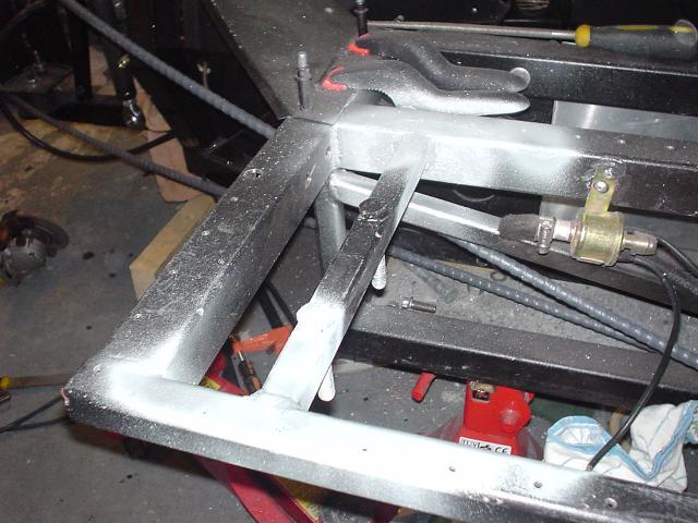

a newer improved looking butt, to put things back on the horizontal... also with the new arms and mounting points, the shocks I am using are sitting better. They used to slightly foul the rear uprights, now there is no such problem

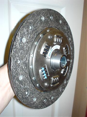

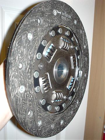

Well the revised Drive plate is back from Helix...

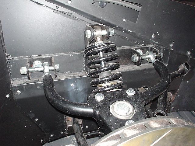

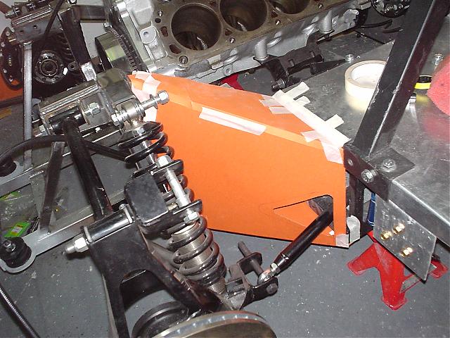

Not muach done this weekend. Mainly chanignthe front upper arms to Rod end items instead of the Polybush ones, and started to template the back of the car for the panelling.

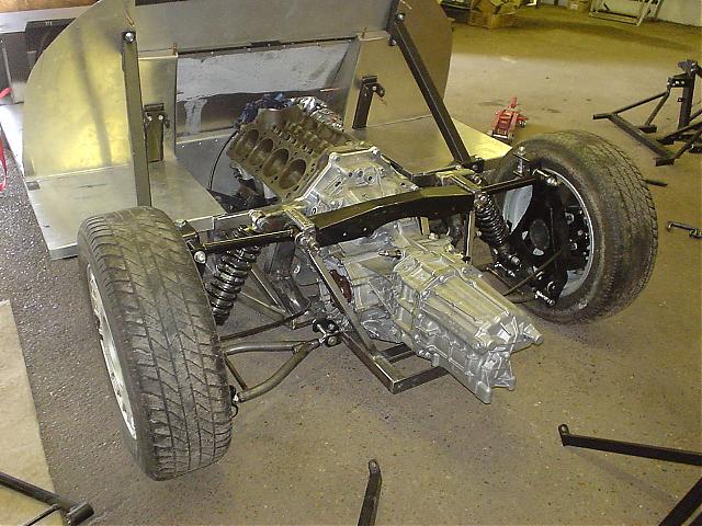

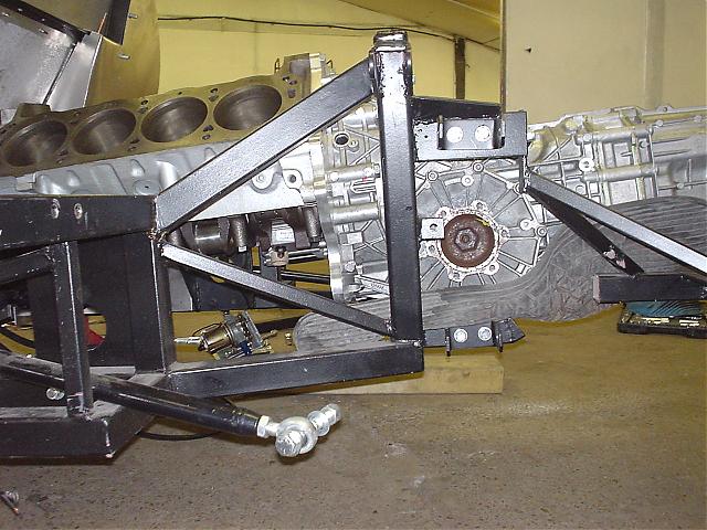

Hadn't realised that it had been so long since I had posted...

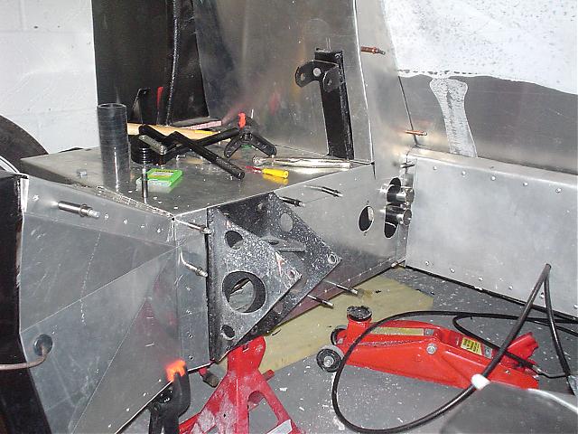

Have spent time making the gearbox mounts and getting the engine level. Also have taken the block back out so I can finish the engine bay panelling. I have also artifically made the rear of the car llok wider a bit more like the originals, rather than following the frame only.

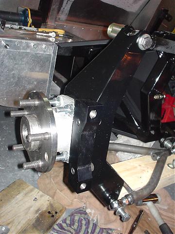

Well an exciting day, for me anyway, I returned home from work and had a box waiting for me. My new replacement rear uprights. I had done a swap with someone who needed mine. So this means that the whole rear end of my car will be SouthernGT... So I spent some time tonight and got one roughly on to see what it looks like

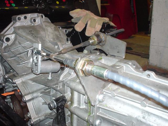

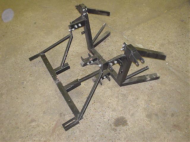

Wow, nearly a whole ten months between posts for me... well at least I have an excuse of somesorts, as I have been building this (well someone else did the bricklaying); this has resulted in me compeletly gutting the bottom floor of the house! Anyway, I finally managed to get some time on the garage today, and have decided that from now on its Saturday house work; Sunday garage work...

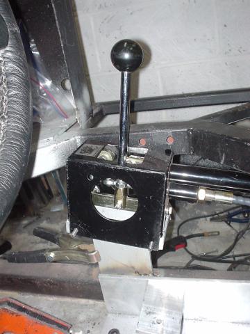

I finally finished off the basics of the gear shift (a sorry needs to be said to Fran for me being a grumpy git earlier this year). It's still got to be tidied up a bit, but everything shifts OK and I can find all the gears 1 through 6 and reverse is OK, but I may have to find a way to replicate the Brandtwood push down. Man its nice to be working on the car again instead of tiling, building door frames, kitches, toilets......

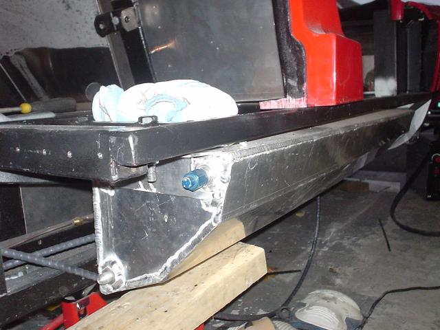

I also managed to keep on going and managed to get one of the fuel tanks in, but I still need to fix it propoerly. Had to move the rear rail onthe GTD as the tank was slightly a tad too long and I wouldn't have been able to do the nuts up!
