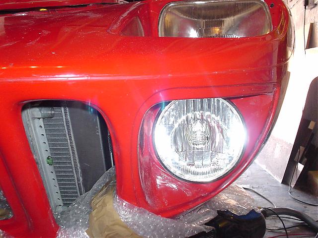

Well after spending two hours cursing Kennedy this morning I decided to see if my other task for today would turn out as disasterous... not so. Been down to my local engineering shop this morning to get a 5 3/4" holesaw and a little fettling on the edges with the stone grinder and volia the lower driving light apertures are done. Just got to fix them in now!

Nice lights Brett, they look superb! Do you have a part number & source for those driving lights?

VERY nice!! Glad you could recupe from the KEP disaster.

The lights are from SVC. I picked them up at Detling last week. They are £30 for the pair plus you have to buy the shells. The ones I've got are the H1 variety. The other comes with a H4 and side.
