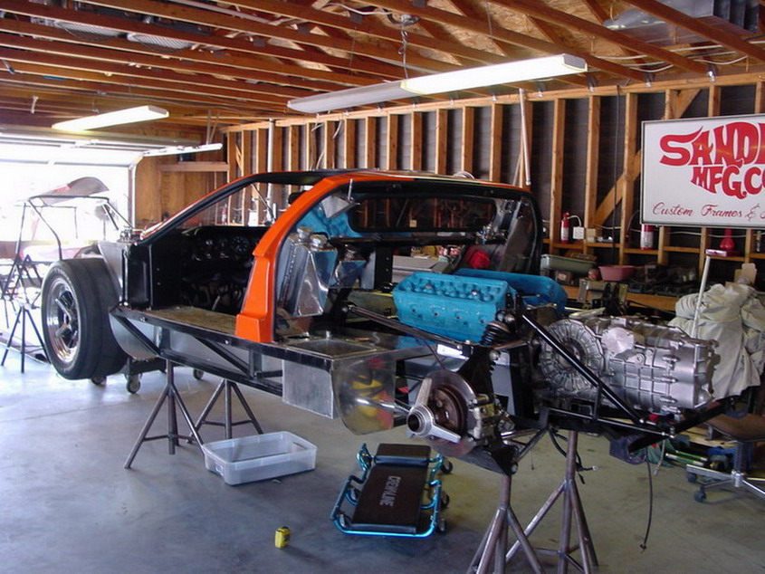

Doc, 'had nothing better to do' haha. Probably should have left it the way it was, it was running real good. Just decided to swap out to a 351w\G50 drive train and that is now leading to brakes, new aluminum paneling, paint, ect. You know how it is, since your doing one thing might as well do 'this' and 'that' while you at it [img]/ubbthreads/images/graemlins/crazy.gif[/img]
Chris, Porsche G50\52 and it gets my 6 1/2" oil pan within 1/4" of the lowest chassis member [img]/ubbthreads/images/graemlins/cool.gif[/img]

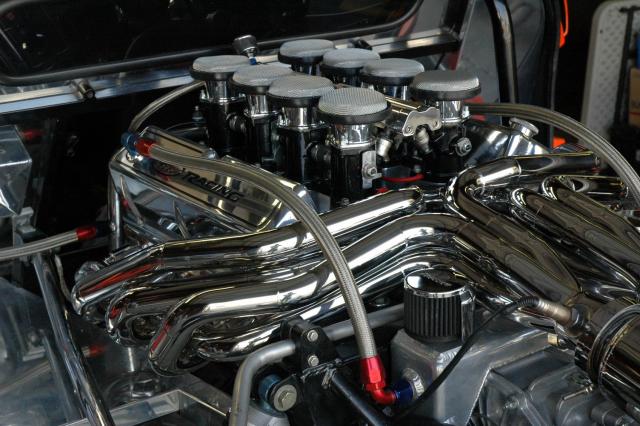

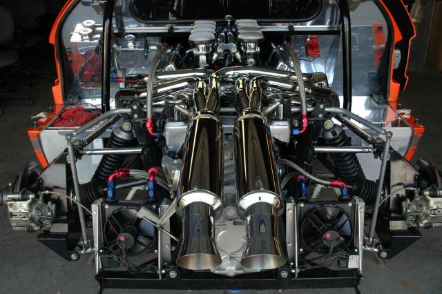

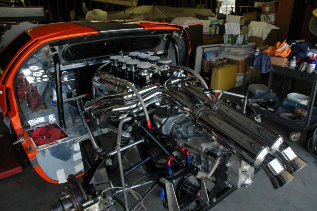

A bit embarrassed, due to the elapsed time, I am finally back with an almost completed Tornado GT40. Although without a car, I have been here with you guys all along, consistently checking in. As noted above, the tear down date was 6-14-05
A very long story short – done to date:
1) engine build 351\427 Alum Dart, from scratch
2) TWM eight stack injection
3) AEM ignition controller
4) G50\52 build by California Motorsports (supporter)
5) CMS cable shift
6) 930 CV’s and new half shafts
7) new aluminum gas tanks, built in swirl pots in each for EFI
8) trans oil cooler with fan and pump
9) engine oil cooler with fan
10) lowered motor cg
11) new aluminum radiator
12) leather dash and sills
13) new paint – (twice – don’t ask)
14) undercoating
15) interior insulation
16) roll cage mods, powder coat
17) fuel pumps (2), fuel filters (4)
18) New custom BOS stainless exhaust, Burns mufflers
19) Custom electronic speedo - era correct
20) Upgraded air condition and fans
21) New plexiglass
22) Misc chassis and body mods
The only thing left untouched was the suspension, soon to be replaced as well. With some luck I will be testing on the road within the week

Looks fantastic, I really like the oil catch tank. Very cleverly packaged! Is that two transmission oil coolers or is one for the engine?
Really nice work!

I think I would add a bit of insulation around those breather lines (header wrap works well) around those breather lines where they come in such close proximity to the headers..
Love the detail... A stunner!
