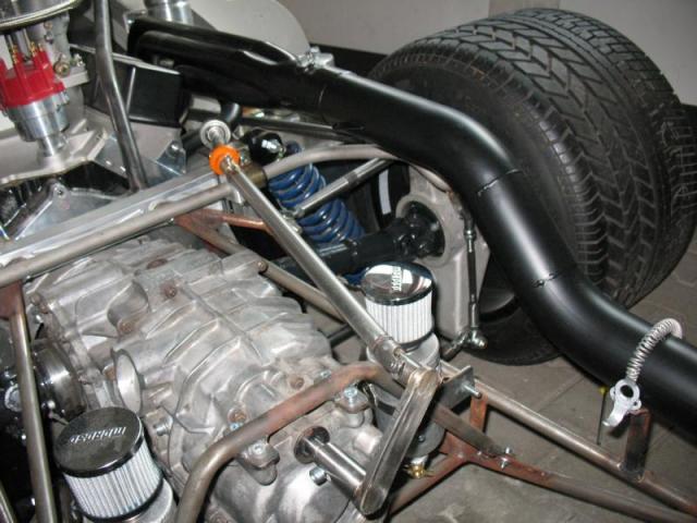

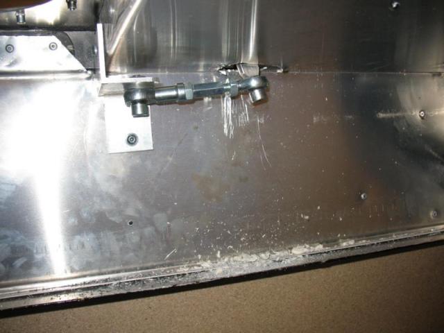

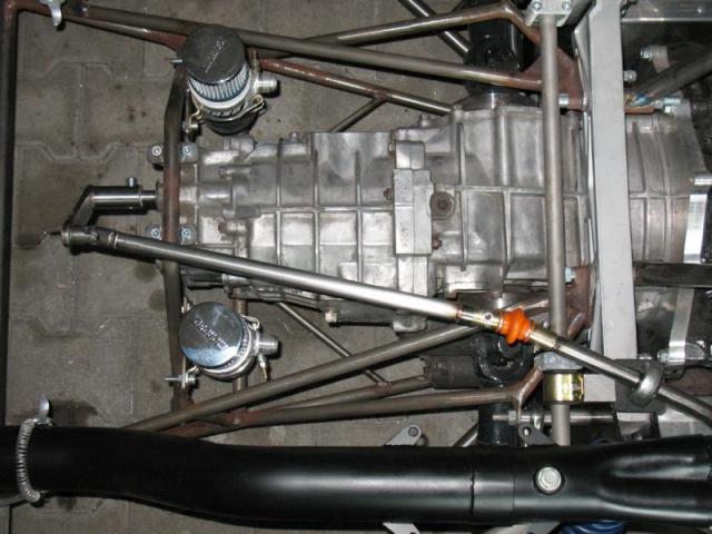

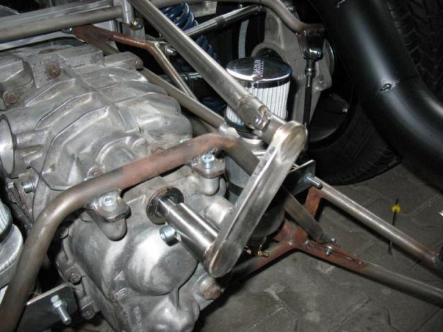

hallo russ, hier meine getriebeschaltung für ein g50/00 porsche getriebe. alle gänge lassen sich super durchschalten auch der rückwertsgang . du solltest flugzeuggelenke nehmen und nicht die einfachen wie auf dein foto.
gruß aus germany meinolf

Looks good Meinolf. Very similar system. Aircraft joints are good but the joints I am using are more than adequate for the job required, and are only a fraction of the cost. Cost, weight and effectiveness are always the main considerations with this build.
By the way, looking at the distributor in your photo. I think you've got your motor in backwards!

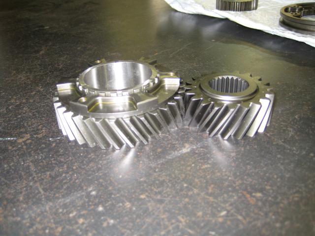

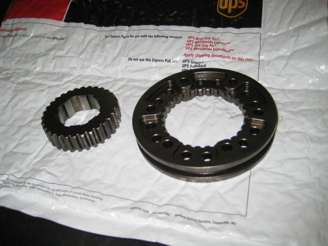

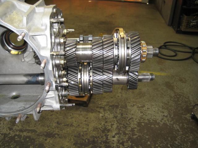

Here are some pics of the Albin's dog change conversion for the 930 trans.The center case needs to be clearanced in the area of the first gear drive gear.With a taller ratio,the larger gear will contact the case,although not much material needs to be removed.

Dave, I haven't had the good fortune yet to "tolerate the 930 shift quality" That's a joy that awaits me!
Interesting photos of the Albins setup..... Typical Porsche though, nothing simple....
If my memory serves me right all the dog boxes that I have seen (30 yrs ago LOL) just have the drive taken by the dogs, but in this setup it looks as though there is an additional set of splines alongside the dogs that do the actual driving. I would have thought that would have the potential to cause a baulk, but obviously not. It looks like the dogs must engage first in such a way that the splines then line up and slip in. I guess that takes some of the (un-noticable) power on/power off backlash out of the system.
Nothing like making a simple item complex/expensive!!

Go back to the simple version Russ, those splines on the 'gear' only locate the dog ring to the gear, serve no purpose in gear engagement or backlash reduction.

So why have them splined? If they engage they must reduce the backlash in the dogs. Otherwise a simple shoulder/recess would suffice to locate the dog ring and gear...

The reason the dogs are splined onto the gears is servicability. If I ding up a dog or two then using the threaded holes in the dog,thread bolts into them and push the dog off the gear and press a new dog on. The Albins gear ratios cost $850 each and dogs and dog rings only $100-$120 each . This is along the lines of Hewland ratios at $150 for used or $295 new,but when a dog is worn out,the pair must be thrown out.

Thanks Dave I didn't realise they were a two piece item. Makes sense. As a matter of interest though, do the splines on the dog engage with the splines on the gear? It looks like they may, unless the dogs don't move that far. Albins could be killing two birds with one stone here?

There is no relative movement between the dogs and the gears once the dog is pressed onto the gear.The slider is the only moving(sliding) part to engage the gear. The slider slides on the hub the same way Hewland does. Yes, you can re-grind the dog to make is usable,only up to the certain point before you don't have enough dog left .

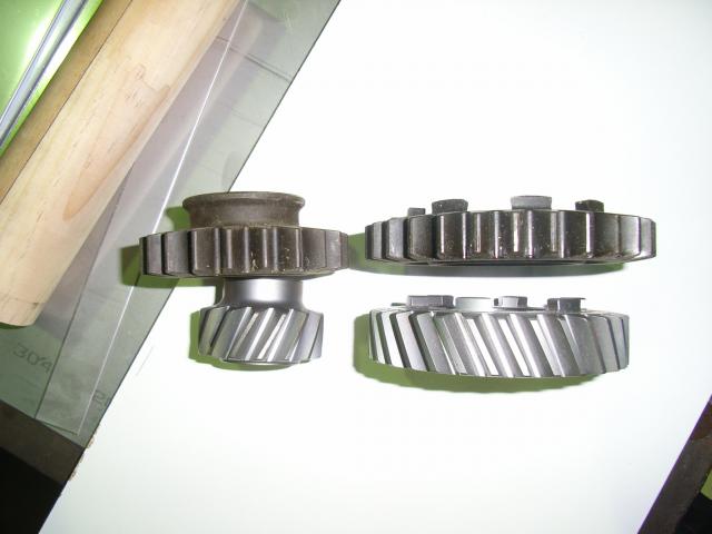

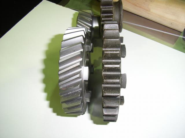

I found some pictures comparing a gear set from my Hollinger and from the VGC, thought they may be of interest
Hope things are progressing

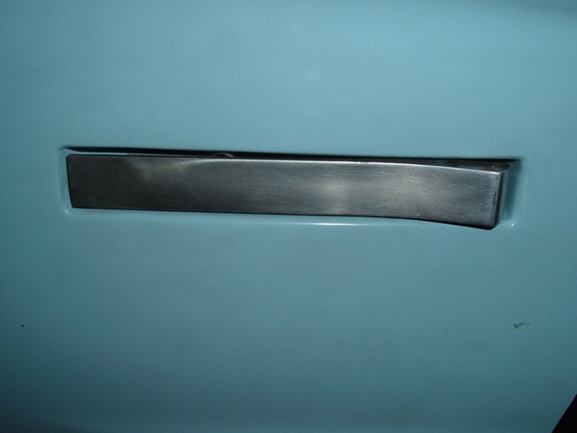

Whilst I have been finishing off the electrics, Lim has been quietly working away machining the castings for the door handles and fuel caps and mounting up the door handles. There is a minor issue with microporosity which doesn't show up until the item is polished. Lim is working with the casting guy to try and get perfect castings. Lim is a perfectionist and is treating this casting process as a learning experience. He uses his 80x magnifier to check the quality. Me? I think they look good the way they are!

80x magnifier for checking casting quality ? Phew, thats one item you better leave at home next time you visit me. Im working out how to apply a vacuum pump to my transaxle to prevent the leaks!!
