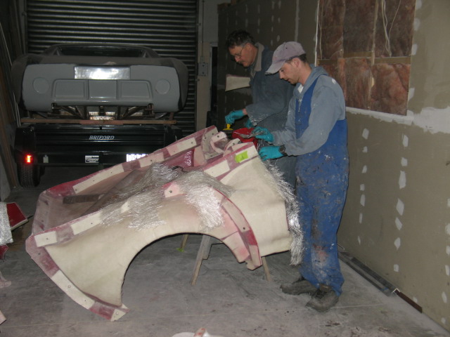

An interesting site. The uprights are not in the configuration that I need and if they were I think the price would rule them out anyway. We're not really reinventing the wheel , it's more a case of designing something that will accomodate the bearings, brake calipers, offsets and suspension mounting points that each of us wants to use.Thanks for the link.
After building the molds we had to make some minor mods to the rear clip mold as the plug this was taken off had been shortened at the front which I didn't realise until after we had built the mold. The pic shows Ash,one of my enthusiastic helpers, extending the front of the mold. The mold for the rear clip is the most complex on the car and had to be made in eleven sections to enable the body to come out.
Regards

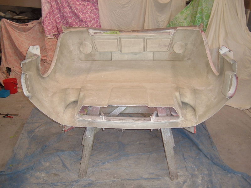

The rear clip not yet released from the modified mold, photo taken after the air intakes have been glassed in to the main part of the clip. Mounting points and inner panels will be glassed in later.

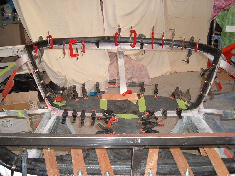

The inner and outer spider sections need to be bonded together. I used Plexus MA425 for this. It has only 30 minutes working time, it takes about that long going flat stick just to do up all the clamps!! The strong plastic butterfly clips tended to slip on the fibreglass so some W&D paper was taped on to give a bit of grip. The outer spider section is lying in it's mold and the inner is bonded up to it to ensure the correct shape.

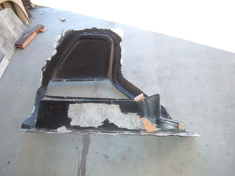

Does any one else make stuffups?
Here is the result of glassing up the door inner by mistake before it had had it's six coats of mold release wax!! Fortunately damage to the mold incurred in releasing this inner was able to repaired in a matter of hours. It was a worry when we were trying to release it though. Big hammers, wedges, scrapers, grinders!
