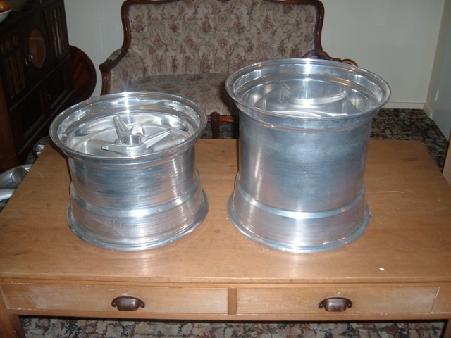

Well hopefully here's the promised pics of the PSE wheels. (Thanks to Paul Thompson for his well written and easily understood post on posting pictures)

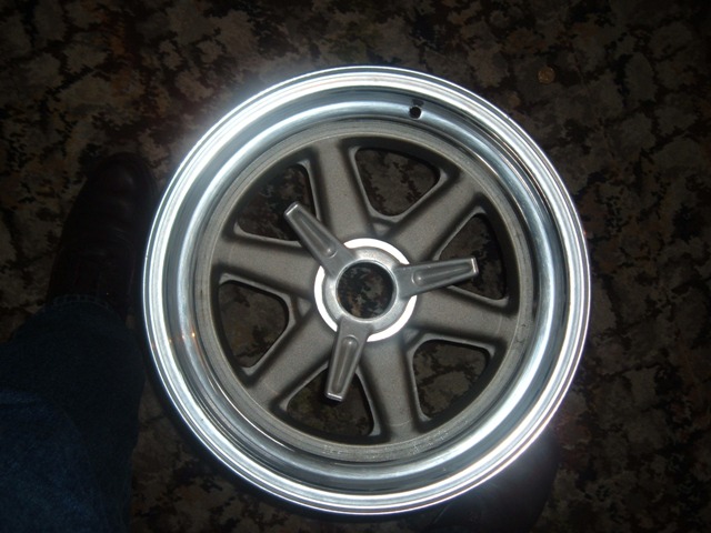

Re: Kiwi scratchbuilt
Pic#2

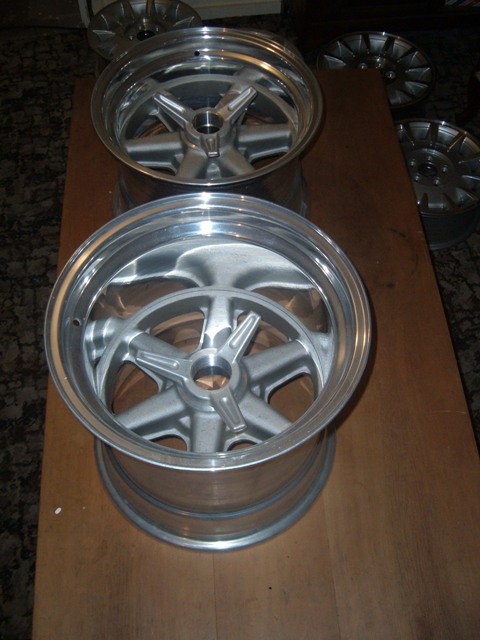

End view

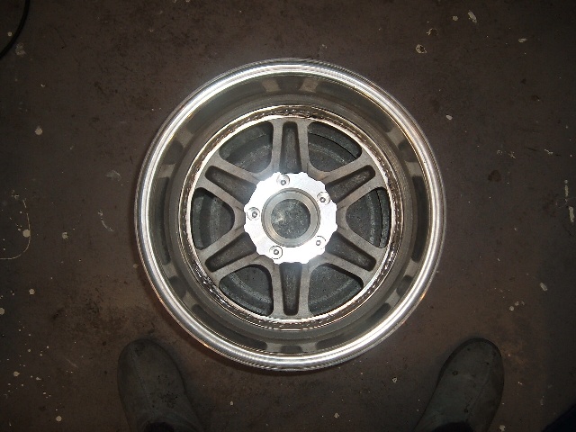

View of back of wheel

Russ-
The pictures of your wheels look great! What are the sizes?

Posts: 1,377
Bill, They're 15", 10" front, 14" rear.
Nobel Man,,
The 14s on the rear are "ORGAZMIC". It would make my 17 X 12 Compomotives look like a bicycle wheel. You MUST post photos once the tires are on those bad boys. [img]/ubbthreads/images/graemlins/cool.gif[/img]
Congrats,,,, I want to get these wheels,,,but no job,,,,and a lazy A$$ is preventing me from doing so [img]/ubbthreads/images/graemlins/frown.gif[/img]

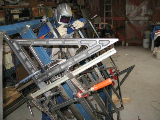

Up close and personal. A rotating bed makes it relatively easy for working and welding. Using a TIG here. The cast iron square in the foreground is one of two that Lim made before we started work on the chassis, as a tool and diemaker he is extremely talented and painstakingly meticulous. [img]/ubbthreads/images/graemlins/smile.gif[/img]

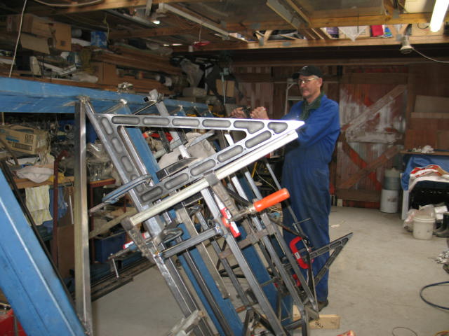

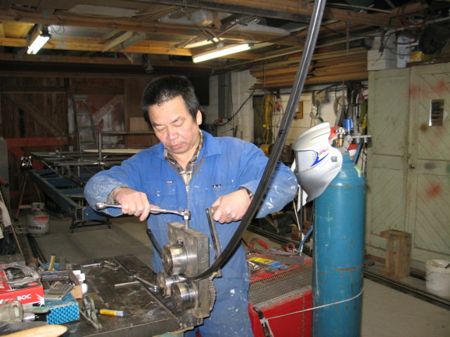

Here Lim is forming the curve to support the front of the spider. Another homebuilt device of his!

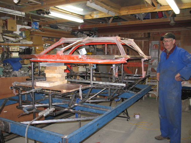

Here is the chassis so far with the spider mold sitting on it checking everything is OK. This is the point a couple of weeks ago when I decided I needed a body before I could do any more to the chassis. I am held up at the front until I decide on a rack, at the rear until my trans arrives and I really need to have the spider to get rollcage placement, spider mounting points and door hinge supports. So, back to the fibreglassing for a few weeks!
