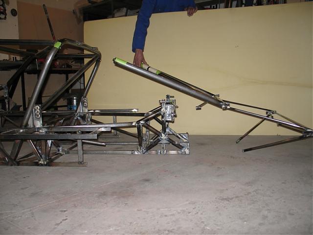

Damn, Jac Mac
I never thought about getting it out!
You should know better than that .
Actually the muffler will have to come off (2 bolts), then the whole rollcage backstay assembly which includes the crossbar between the shocks, and the rear body support framework, all one unit, has to be removed (4 nuts and 5 bolts).Then 4 bolts each on the front and rear motor plates and she's out. I removed the complete motor with plates, exhaust and trans last night in just a few minutes. Of course you still have to unhook fuel lines, drysump lines, electrical connections and throttle cable.

Originally Posted by gt40fran View Post
Russ,
are you planning on radius rod style rear suspension??
What do you plan on attaching to???
Looks really tight for an intake too.....no Webers for you ..eh!
That looks like a really easy tube chassis to repair... .......I know..I know I couldn't resist...
Fran,
All these awkward questions.....
Yes, radius rods. You can see the part completed mounting points attached to the top of the chassis rail and the rollcage hoop. I have incorporated three alternative pivot points depending on ride height, antisquat etc.
Similar setup for the lower radius rods. Because of their outboard positioning I have gone to parallel links on the bottom rather than an A arm in order to eliminate the inevitable bump steer that would have otherwise occurred.
You know we kiwis can't afford Webers or injection! You're right about the chassis, but that's an irrelevant consideration coz it's never going to need repairing!

Re: Kiwi scratchbuilt
does that mean you are never going to finish it then?
I did notice your triple mounts but I am surprised you want them...
Seriously...I would expect that you have your geometry sorted and not need to make such drastic changes..
What is the reasoning behind such large increments

So I presume you will be making the inboard /chassis attachment points with the same three positions..so as not to compromise your camber gain ....?What about your roll centers, shock attachment points etc etc etc if not using new locations....??
There are so many small things to think about when designing your own set up and then actually making it happen with a clean sheet of paper takes some dogged determination....(I should know...jeez)....keep it up!!!!

[quote=gt40fran;207969]So I presume you will be making the inboard /chassis attachment points with the same three positions..so as not to compromise your camber gain ....?
/quote]
Exactly Fran, you've got the picture. Raise the chassis an inch, drop all the pickup points an inch. Roll centres don't change, suspension still works within its designed range. Change the springs and maybe the shocks. The only thing is the mass centroid is higher, and driveshaft angles change, and you're getting more air under the car, but all that's pretty much unavoidable when you raise the car anyway. Compromises.....compromises....
Nevertheless I can't think of a better or simpler way to cover most of the bases, given the scenario.

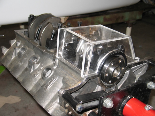

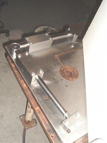

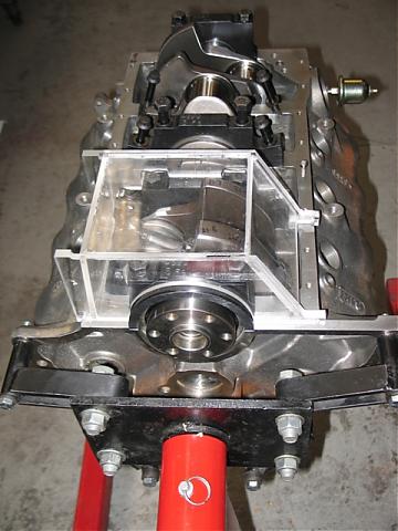

Well, Lim has undertaken to cast the sump (as well as doing the majority of the machining required for this build). There are several criteria for this sump...
1 I want to keep it as shallow as possible.
2. It needs to allow the use of a LHS front mounted 928 starter to work on the small 930 ring gear.
3. Because there is the thought that we could possibly sell a few of these precision made kiwi castings it needs to accomodate the largest stroke possible bearing in mind the other criteria.
4. It must clear 4 bolt caps.
So the mounting of the 928 starter is the limiting factor and Lim has decided to make a mockup of the rear section of the sump in perspex so we can see and measure the clearances that we have before making the actual pattern.
We are aiming for a wall thickness of about 6mm, any thicker is too heavy and any thinner makes it difficult for the molten alloy to flow satisfactorily.
So the actual pattern is going to be crafted in 1/4'' steel plate. It looks as though we can build this sump to accommodate 4.1, maybe even 4.25, strokes, depending on components used.
Below are some shots of the perspex mockup, the actual full pattern will of course have radiused corners etc where required.

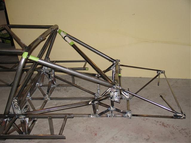

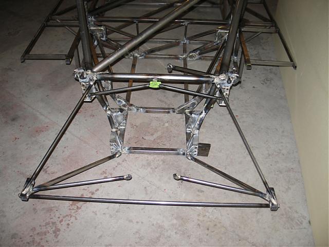

Since you mentioned it Jac Mac.......
Here's the rear chassis and removable subframe.
Cheers,

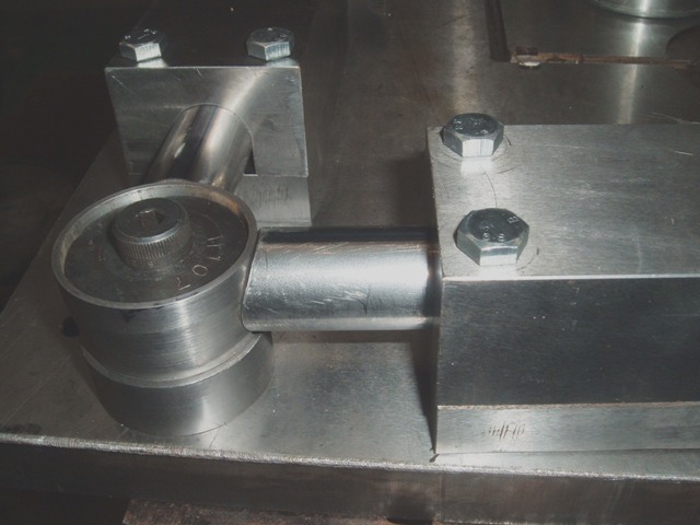

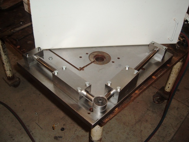

Some pics of the front bottom arm. Sitting in the jig about to be welded up
Russ

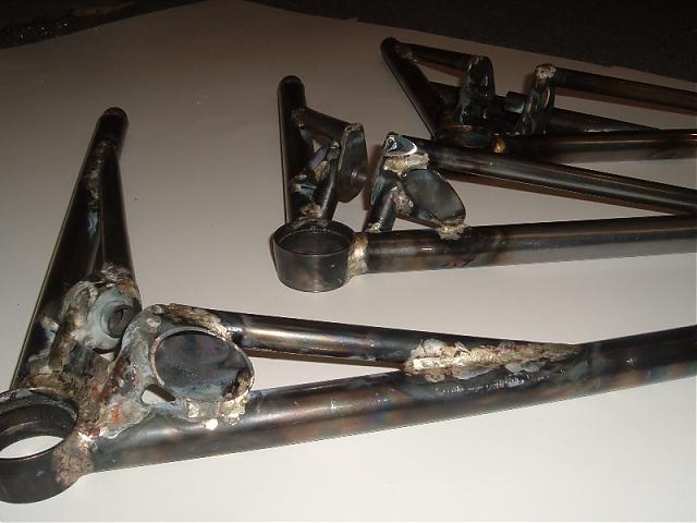

The lower arm went through three different iterations before I was happy with the design. Mainly the shock mounts and rim clearance issues. The first one I built was just used to play around with.That's the one at the back. From there the first real attempt is the middle one. And the final refinement shown in the front .
These arms are shown upside down, the shock eye is below the arm not above it
Russ
