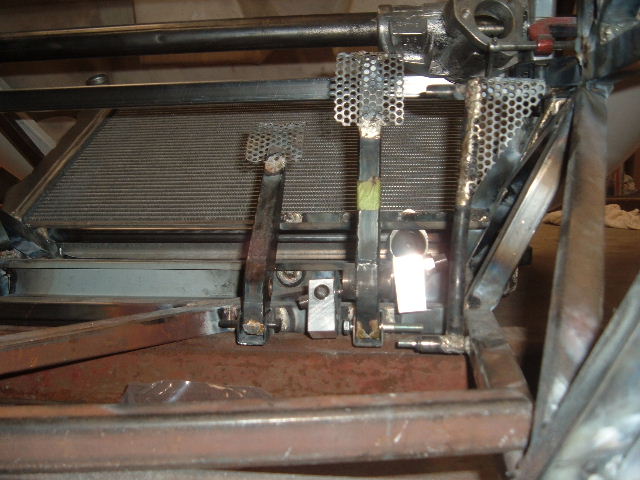

Pedals made and mounted.

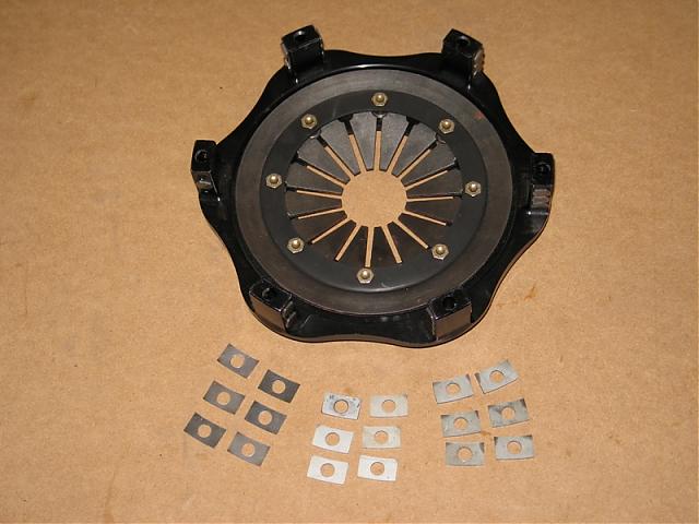

Nearly Christmas and work continues apace. Should be a heap of goodies that were bought in Aug/Sept arrive on the boat in the next week or two. Also a few things recently ordered that are being air freighted in just so I won't run out of things to do over Christmas.
Working on the motor/trans at present. It's the first time I've prepared an American V8 so what I don't know will fill a book!
Anyway, recently got the new reciprocating assembly back from cracktesting by my mate at the airways NDT facility. All good, so in for balancing (internal of course) last week on a Sunnen DCB-750. Not much to do, one slug of Mallory. All Lim's flywheel/clutch machining was spot on and in perfect balance.

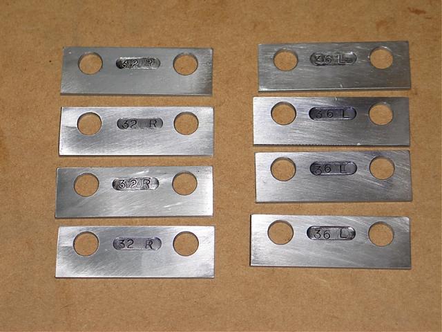

I have increased the step on the triple plate clutch from 3mm to 5mm and will initially fit 2mm shims under the cover to achieve the correct setup pressure. We have machined three sets of shims , 2.0, 1.3, and 0.65 and will fit these in turn rather than replacing clutch plates as the friction faces wear. Should get four times the life out of the plates. And I haven't even got a Jewish/Scottish ancestry!
Below is the clutch cover with the three sets of shims.

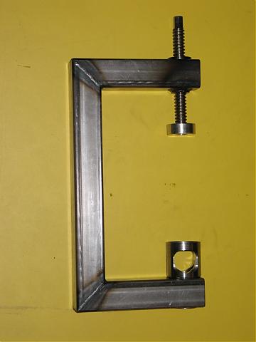

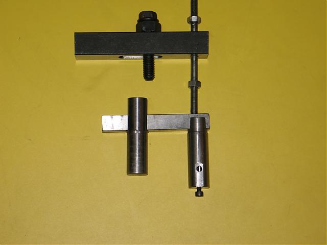

My heavy duty off the shelf spring compressorwas not man enough for the heavy springs and munted itself after compressing half a dozen! So we turned around and made our own with an aluminium sleeve over a bearing so it turns easily and won't mark the valve head/combustion chamber. Works a treat, nice and simple.
Name:	spring compressor 010.jpg

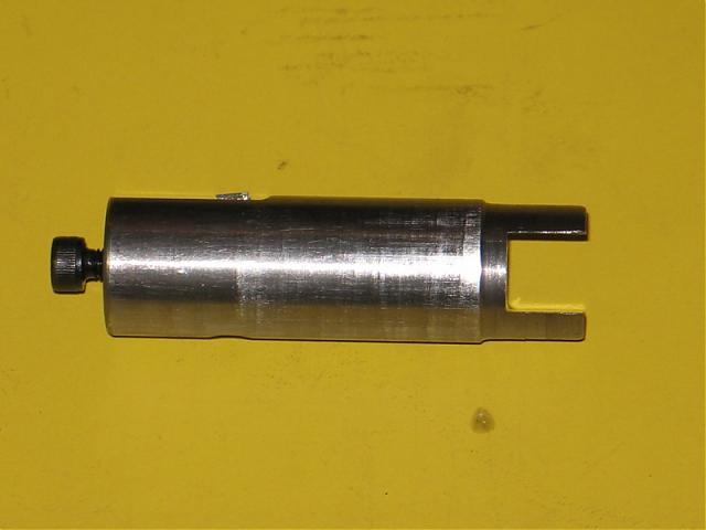

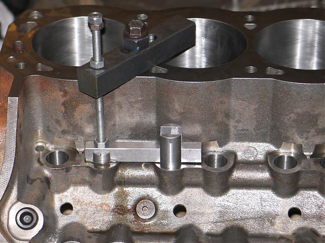

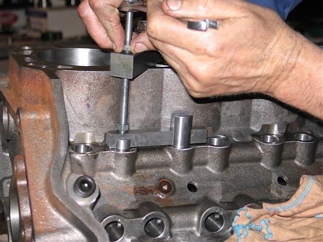

Work continues on the motor. After seeing Satan's TS 875 build thread, I had to do a quick search on standpipes to find out what they were, and then a quick email to Jac Mac to find out WTF they did! Did I mention I know nothing about motors? Anyway after some clarification, standpipes have been made and fitted. There was also mention of lifter bore mods for oiling the roller lifters....
Whilst I was quite happy to scratch away at the lifter bores with a hacksaw blade in true Kiwi fashion a la Jac Mac, and no doubt it would have worked fine, Lim threw up his hands in horror and said we need to make a tool for that.... Photo's are of the Mk1 tool which did the job. However when we designed the tool we didn't realise the lifter bores were not parallel to the cylinder bores, so the Mk2 tool has a pivoting fulcrum under the lift nut to accommodate the angle.

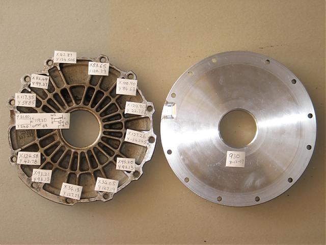

Today I have finally fitted up the 928 front mounted starter and assembled the flywheel/clutch/ring gear and offered up the transaxle and set final clearances on the hydraulic release bearing. Everything's going to work a treat. Photos later.
Billet side plate for the 930 has been machined so everything is slowly taking shape. Stick on tags on the original are XY co-ordinates for the hole centres for the mill. Saves doing a drawing, just take a photo.

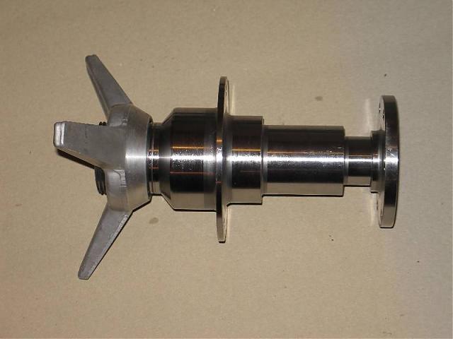

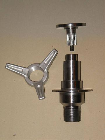

Rear hub axles have been made both sides. Machined from billet. We had to farm out cutting the splines. The spinners are forged alloy supplied by PSE.
Quite large differences in the machining tolerances for the threads between the PSE supplied articles and Lims Vintage supplied spinners. We're getting used to this now though and have learnt to check everything and machine to suit.

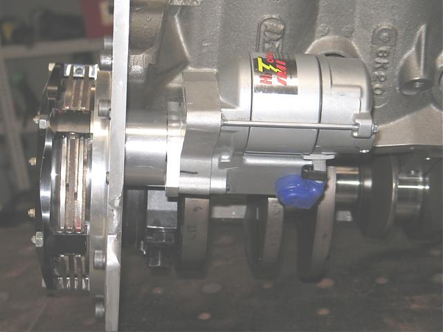

The starter/ flywheel with these Porsche trannies is somewhat of a mission but I have trodden a slightly different path on this one.
Primary concern was that I wanted a light and compact flywheel which really dictated a forward ring gear. I spent a lot of time looking at how to extend the starter nose forward to suit using the standard Porsche mounts. In the end there were too many problems to surmount and space was tight too.
So I decided a forward starter mounted off the adaptor plate was the best way to go. This made my new Hi Torque starter redundant because the direction of rotation is wrong when it is turned around. So I ordered a new 928 unit from 928 Motorsports.
Anyone in NZ want a brand new, unused, Hi Torque 930 starter at a good price? Fits G50 as well I believe.
I initially wanted to fit it to the LHS because of the dry sump lines on the RHS but after already doing a chop on a couple of chassis tubes it became obvious that configured that way there just wasn't room as my motor sits really low in the chassis. So had a really close look at the RHS and found I could just fit it in and the drysump lines too.
In the end it was quite simple to do and you can see how compact the flywheel is.

It necessitated machining up a new mounting plate with threaded holes for the 6mm mounting capscrews. New plate on left replacing old on the right.
