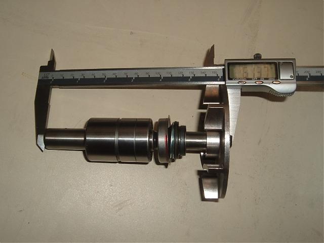

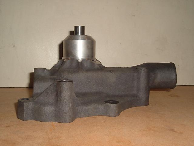

I have started playing around with fitment for the dry sump pump, waterpump and alternator which will all be mounted on the front motor plate. And the belt layout, pulleys etc.
First up it's obvious the brand new waterpump is miles too long. Time to turn it into a Kiwi shorty. So, strip it out and see what scope there is for shortening. This is what we started off with, 6.137" long.

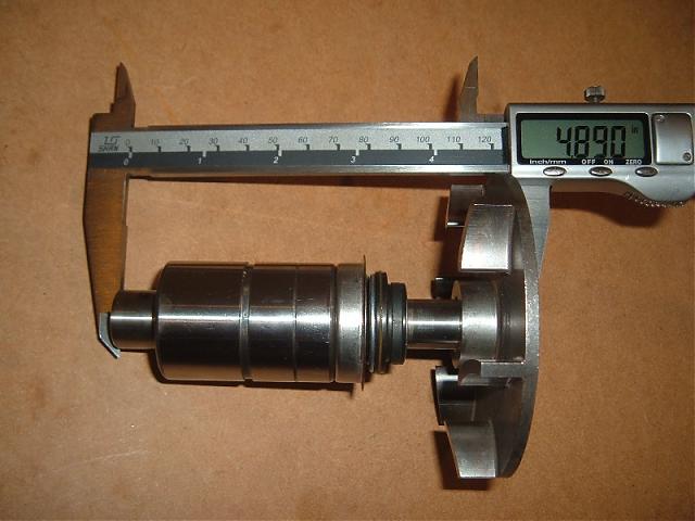

Well, not too bad. There's scope to trim it back by 1.25" which will be just about right. The bearing can go rearwards in the housing. The seal and impeller can be pressed forwards to maintain their positions relative to the housing and the nose of the housing and the front and rear of the bearing shaft can be shortened up to suit. QED. Finished length 4.890". In actual fact, if I'd needed to, I could have trimmed it back another 1/8''.

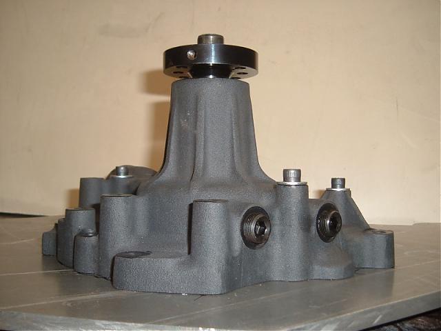

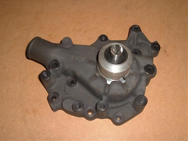

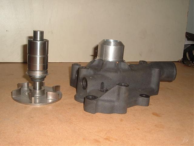

All ready to go together. As a little bit of added security I decided to locate the bearing with a 3mm grub screw engaging the existing groove in the bearing. The screw shows up better in the flash shadow than it does on the actual pump. I also took the opportunity on reassembly to close up the impeller to housing clearance. I have never liked the big gaps found in most factory waterpumps. Final overall length of the pump to the front of the shaft 4.9". This means I won't need to put a power bulge in the firewall to enable clearance for the pump or for belt replacement. Sweet!
Not bad considering the extra length that Porsche have in the 930 from the driveshafts forwards and the extra 10mm that the motor plate spaces the pump forwards.
