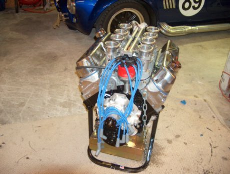

Rep Power: 4  | Re: Sabre #16 gets an engine Here are the specs of the motor from what I know so far.
351W production block stroked to 408
Eagle 4.00 crank
Scat h-beam 6.200 rods
SRP dish pistons
comp cams hyd roller 236-242, .555-.576, 110 ls.
Brodix track 1 heads cnc full port.
TWM Stack injection
FAST XFI control box
When Keith and I first talked he said he was going to use the afr 185 heads. dont know why he swithed them out as I have not had a chance to talk to him yet.
Keith tells me it idles at 800 rpm and is very smooth throught the entire rpm band. Should make a nice motor.
Here is a pic if I can get it to work. |

Rep Power: 4  | Re: Sabre #16 gets an engine Here is another pic of the TWM. |
