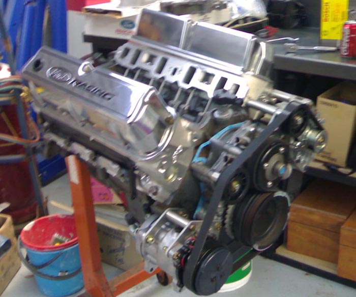

The last of the nasties are just about done, ie the wiring to the efi fuel system.... Pain in the A
The dash will be going back in for the final(hopefully) time on Saturday, windscreens next Monday, engine and transaxle the following weekend - well at least that's the plan but you know how plans have a way of changing themselves....
Peter, I like the " 'Just' an engine " comment as I know what a pain that was for you. There are some unknowns there for me too which I get the feeling will turn expensive before too long
Below is a shot (fuzzy) of my completed engine (minus manifold).
Bill.

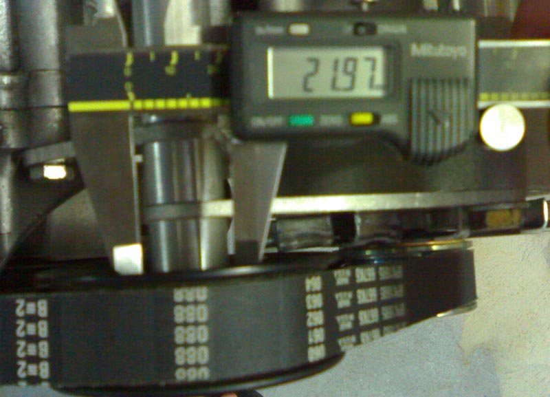

Since you have just done the front dress on the engine perhaps you could answer a question for me. What bearing do the idler pullys ride on? I can't seem to find anyting that fits in the bags of parts for the idlers.

Hi Peter
The 2 idlers came with a whole bunch of nuts, bolts, brackets, a belt and 2 aluminium bearings for the idlers. The bearings were a very simple push in type, slightly different in length. I'll take some detailed shots and post for you

Peter
I checked the bearing and the boss that it rides on. The bearing is made by NTN Japan, part no: 6203LH
The boss is 21.97 millimeters in diameter. The drivers side idler on a LHD car has a slightly longer boss, which extends out the back of the idler by exactly 20 mm. The other one extends 12 mm.
I've attached a photo - the measurement is accurate.
Hope this helps

Bill,
Thanks for your time and effort, that gives me just the information I need.

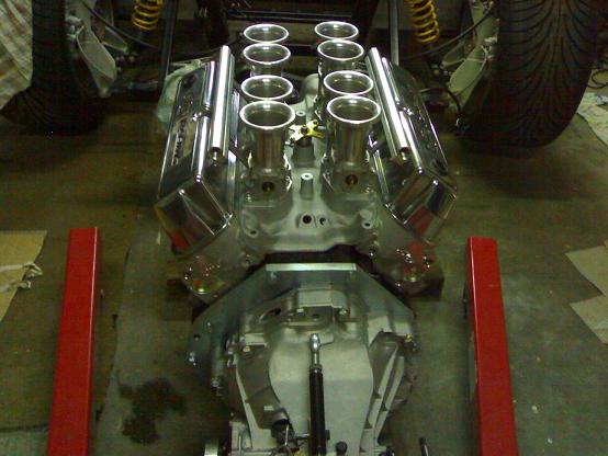

Here's the motor getting ready to install in the car!

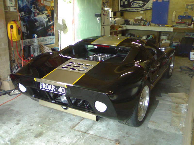

Well, the engine install took longer than I anticipated - I knew it would...
Thought I'd post a few shots to show its new heart....

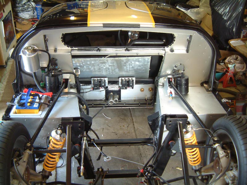

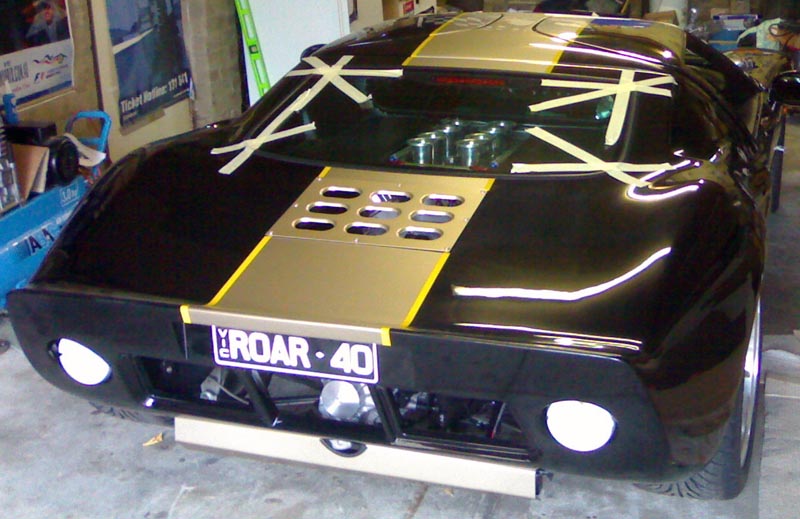

I've bled the brakes, clutch, filled and primed the oil and filled the water system in the car. Final testing of all EFI items almost complete along with some minor finishes and hopefully I'll be able to start the damn thing this weekend.... Oh yeah - must remember till put some fuel in too :-)

You must be expecting a righteously mighty rumble to stick safety tape on the glass!

Re: Roaring Forties # 61
You should see what I've done to the garage door.

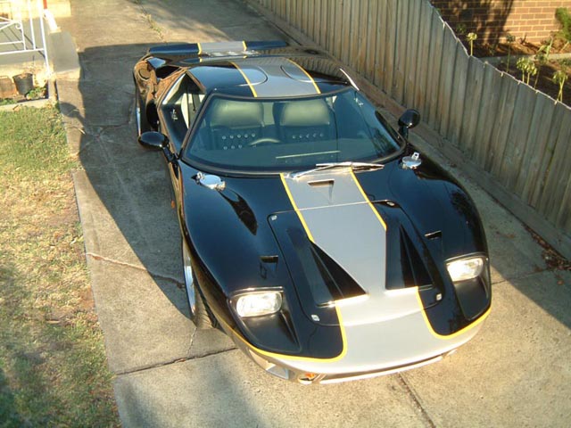

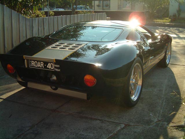

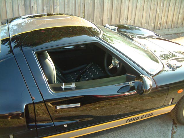

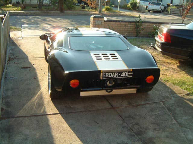

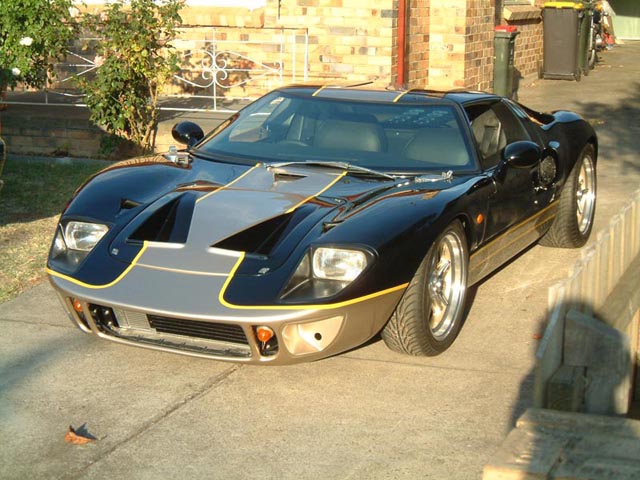

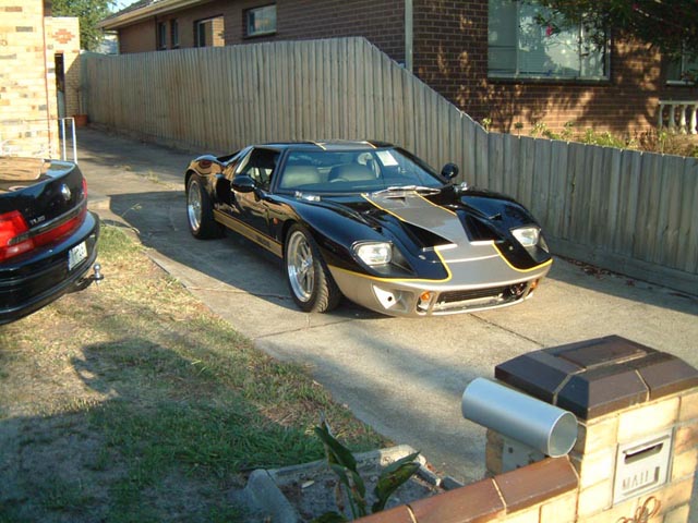

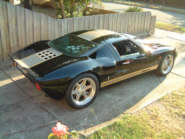

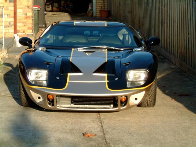

Well the car moves under it's own power now and I am on the verge of putting it on the street for testing.
It was perfect conditions to take some happy snaps, so whilst the car is not yet fully complete, this is what it looks like:
