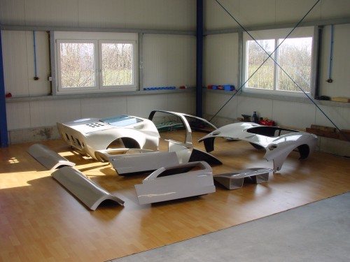

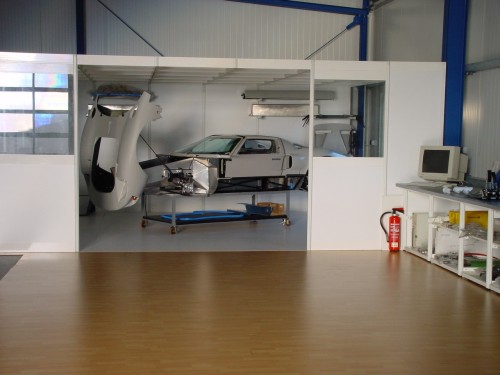

Our new workshop is now finished after some problems and delays in the building permit. Some remainder-work stands still out however we hope to have settled everything until next week. [img]/ubbthreads/images/graemlins/banana.gif[/img]

Our plans are to finish everything till June (Le Mans Classic). The body is now in the paint shop for some baking – to out-sweat the moldwax. After that we start with the dirty work.

GT40 in the “Dust cabinet”.

the "dust cabinet" is an exhibition stand we do not need any longer and the floor remained from one of our fairs. Very easy to keep clean and we hope the dust will stay inside.

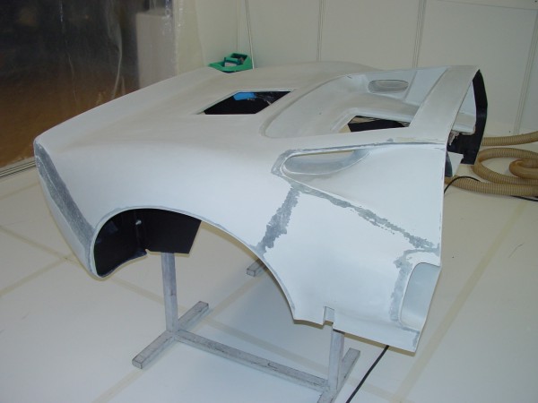

Today I got the body back from the paint shop. The parts have been baked for one hour at 60° to out-sweat the rest of the moldwax.
Although we had washed the body and degreased it with a special wax remover there was still a lot of wax left in the gel coat. After the baking you could see many small white drops of wax on the surface of the body.
To remove the wax we first used a Scotch ultra fine pad with “Standox Plastic-Cleaner antistatic”.
After that we cleaned the body again but used the “two towel method” - in one hand a towel with “Standox Plastic-Cleaner antistatic” and a dry one to wipe off the solvent in the other hand.
This should eliminate any problems with the wax.

Reinhard,a product that I have found excellent for removing that Wax Residue is Standox Silicone Remove,when used in a two cloth application this product is absolutley fantastic the product number is 27/86786

I have used the Standox Silicone Remove only on steel panels and primer/paint yet. A very good product but a bit pricy – as usual with Standox. The Plastic Cleaner Antistatic was suggested by Standox as especially for fibreglass to me.
I think the two cloth application is the only way one should use these products.

Russ the Standox Silicone Remover will remove virtually any wax or silicone release agent i have ever come across.It is the only product i use as a final cleaner ,and yes reinhard i agree that it is expensive but when used correctly it is very cost effective.

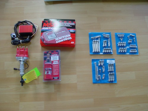

Old 12-22-05, 04:34 AM   #13 (permalink)
Join Date: Oct 2005
GT40: Germany
Posts: 51
Rep Power: 3 Reinhard H. is on a distinguished road
Re: German MDA
Must be Christmas!

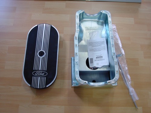

Another package arrived from Summit Racing with some goodies for my engine.
MSD ignition parts, Ford oval air cleaner and a Moroso T-sump oil pan.
Its funny I am getting always nervous when I see the UPS truck.
Reinhard
Reinhard H. is offline

Ford Oval air cleaner and oil pan

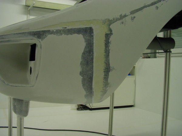

Old 01-03-06, 01:48 PM   #15 (permalink)
Join Date: Oct 2005
GT40: Germany
Posts: 51
Re: German MDA
Hello,

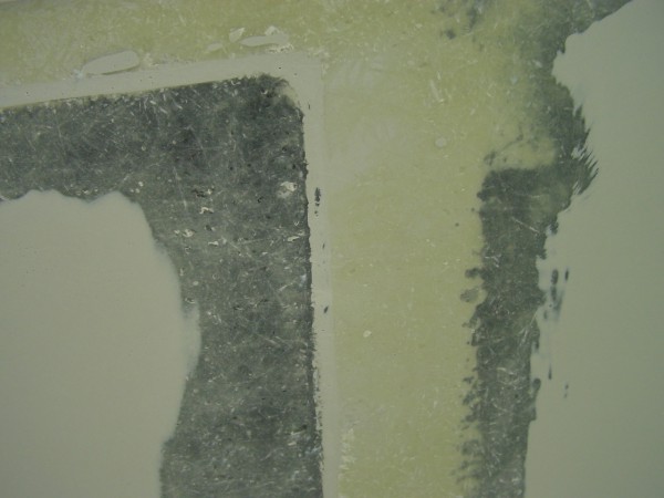

I started grinding the seams yesterday. Things went really fast with the “Rotex” grinder and 60/80 grit papers. Found some Air pockets and removed most of the high spots – the front and rear body clips came out very smooth. [img]/ubbthreads/images/graemlins/beerchug.gif[/img]
The only thing I was astonished was the gel coat in the seams of the front clip. You can see a big stripe of gel coat in the seam and the gel coat also extends between the layers of glass about 2 inches into one of the panels. Some gel coat in the seams is not uncommon but I have never seen it extending under the glass. [img]/ubbthreads/images/graemlins/banghead.gif[/img]
Has anybody had the same problem before? Any ideas are highly appreciated.
Reinhard
Old 01-03-06, 01:50 PM   #16 (permalink)
Join Date: Oct 2005
GT40: Germany
Posts: 51
Re: German MDA
Another view. The white between the black glass is the gel coat
Old 01-03-06, 01:52 PM   #17 (permalink)
Join Date: Oct 2005
GT40: Germany
Posts: 51
Re: German MDA

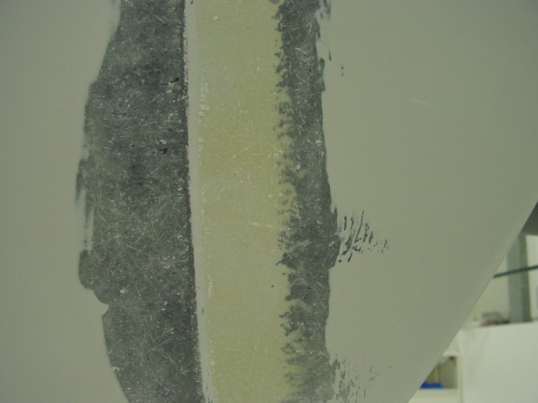

The gel coat stripe goes from one side to the other along the nose. The rest of the seams are OK.
Old 01-03-06, 01:56 PM   #18 (permalink)
Join Date: Oct 2005
GT40: Germany
Posts: 51
Re: German MDA
At the rear clip I have the same problem.
The gel coat stripe goes from the left rear wheel well over the spoiler lip to the right rear wheel well. The rest of the panel is OK.
Old 01-04-06, 01:08 AM   #19 (permalink)
Join Date: Oct 2005
Location: <br />
GT40: Melbourne Australia
Posts: 24
Rep Power: 4 Allan T Knight is on a distinguished road
Re: German MDA
I've had the same thing on some Cobra bodies Reinhard,and its no real problem provided that the gelcoat is prepared properly,remembering that the gelcoat is harder and not as porus as the fibreglass.I would suggest sanding the gelcoat with 60g before applying your filler and allowing the filler to thoroughly before sanding so as not to peel the edge back which could lead to adhesion problems down the track.
Regards Allan [img]/ubbthreads/images/graemlins/beerchug.gif[/img]

Old 01-04-06, 02:40 AM   #20 (permalink)
Join Date: Oct 2005
GT40: Germany
Posts: 51
Re: German MDA
Hello Allan,
I have seen this also on some Cobra bodies (Factory Five) but they had the gel coat only in the seam and not between the layers of glass.
We usually take a grinding stone to remove the gel coat and fill the void with short strand fiberglass filler. I am a bit afraid because of the amount of Gel coat. Gelcoat can not be used for anything structural, it tends to crack.
Maybe I will grind it a bit more and glass a thin mat over the seam.
Regards
Reinhard
