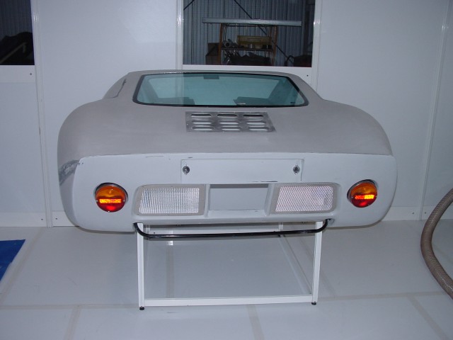

GT40 in the “Dust cabinet”.
Thanks Chris,
the "dust cabinet" is an exhibition stand we do not need any longer and the floor remained from one of our fairs. Very easy to keep clean and we hope the dust will stay inside.
Reinhard
