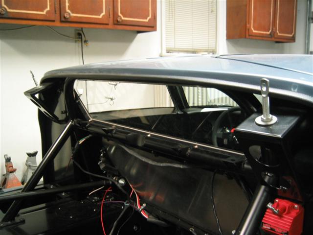

The boys are right, Bill - quite a piece o work you've assembled there!
As for the harnesses, STRONGLY recommend you attach them to the roll bar as you noted. There's not a better place in the car to attach them to on the off chance (perish the thought, please) that you'll be truly in need of them.
To shift gears ever so slightly, the clear panel between the cockpit and the engine bay... is that the plexi panel Fran supplied with the car, or a true glass panel which you mentioned in a post many months ago?

Thanks Dutton. The rear glass is Lexan supplied by Fran

Bill,
no Eye bolts.....loop around the cross bar of the roll bar.
I suggested another solution for the guys that have a bolt on harness preference...Pantera1889 used it on his car ...hopefully he will be kind enough to share a picture or two.....

Originally Posted by gt40fran
Bill,
Here you go. Let me know if you need a more detailed picture.
