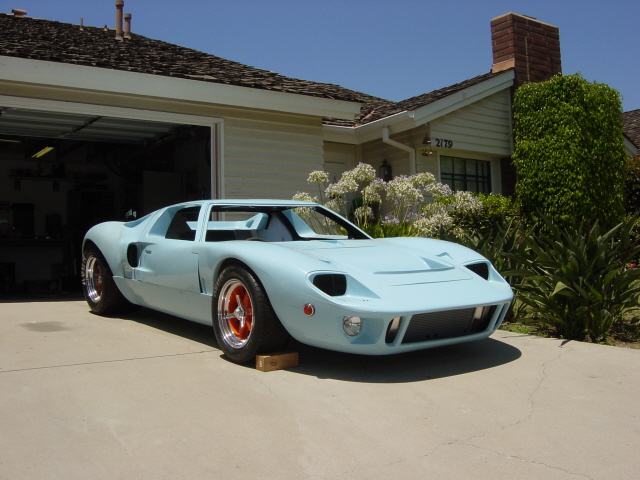

SWEET!!!......Congrats Bill, I look forward to the day my SLC makes it to the same milestone.
Looks a little different from when I visited you......way different
