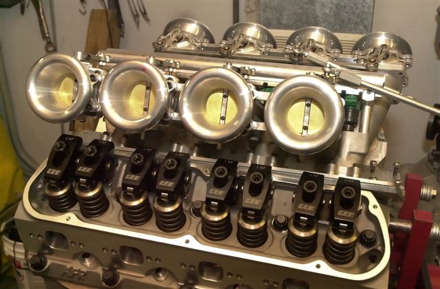

Olivers Ride RF with ZF
Fidenz's Alum. Flywheel

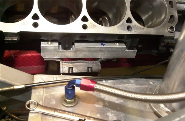

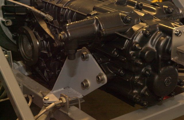

ZF Mounts
Johngt40 is offline
Old 02-05-06, 06:49 PM   #7 (permalink)
Johngt40
CURRENTLY BANNED
Join Date: Jul 2005
Location: 86 Grad IIT Chicago MJR. Mathmatics/Physics
GT40: Il.
Posts: 454
Rep Power: 0 Johngt40 is on a distinguished road
Re: Olivers Ride RF with ZF
ZF fabricated mounts
Johngt40 is offline

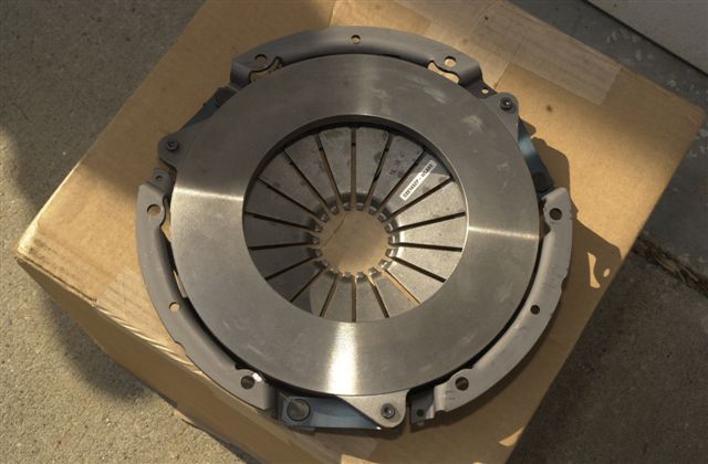

Fidenza's new clutch
Johngt40 is offline

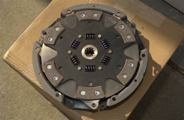

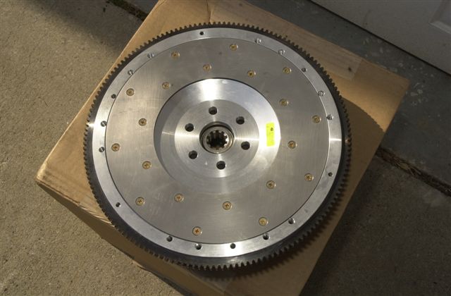

Fidenzas Disk
Johngt40 is offline

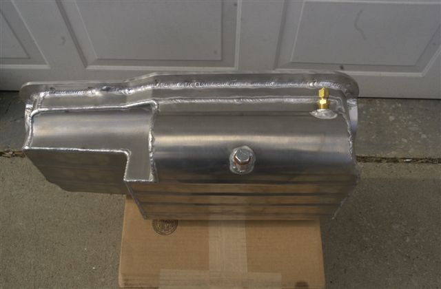

Armond's custom size oil pan..This was shortend a little more than normal gt40 size.The engine was lowered to fit the ZF. The pan was made a little shallower so it won't stick out the bottom.
Johngt40 is offline

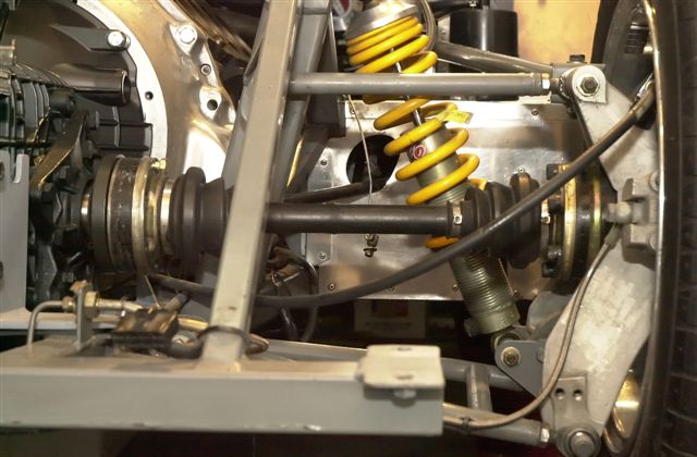

John
Are you sure the ZF is up the right way? My cross shaft is at chassis level and cover plate over crown wheel is on top.I see the c/v flanges so it looks like you've got the M1 ZF upside down. Shoot me down in flames if I'm wrong though.
Ross
ross nicol is offline
Old 02-06-06, 04:14 PM   #14 (permalink)
Johngt40
CURRENTLY BANNED
Join Date: Jul 2005
GT40: Il.
Posts: 454
Ross,
This is a pantera box not the m1 box. Do you like how level the axles are positioned ...You can't get any better than that.
regards John

Oliver,
I don't know if there is any truth to the following but I'll throw it out there.
In regards to half shaft angle\cv's they are designed to have some angle on them, even if very slight. Either fore\aft or updown\down or cobination is necessary so they always have some working contact on them rather than perfectly centered with no angle (of course extreme angle is not acceptable either).
Anyone to confirm this?

Oliver,
I think what Ross may be referring to is the lower a-arm. On my car the lower control arms are almost parallel with the ground. I believe if you set the ride height you will see something different.
Looks like some nice stuff you have there, would love to see some more pics.

Excellent looking parts, the manifold is a very nice looking part. What size are the butterflies in the maifold?
Good stuff!
Sandy
Sandy is offline
Old 02-06-06, 08:01 PM   #19 (permalink)
Johngt40
CURRENTLY BANNED
Join Date: Jul 2005
GT40: Il.
Posts: 454
It is 50mm Throttle bodies With Motec EFI The cross ram is a custom built item and is not availiable in the USA This is a special order item.. There are only 4 of these crossrams that exist in the world for a ford 302 ther are other home made jobs but nothing compairs to to the craftmenship of this intake. The cost of the intake and throttle bodies alone is more expensive then most what people put into there whole motors. The intake is still under devolpment and once completed by the end of this month, I am going to have a Motec tech tune it. I'm still learning on EFI Motec and don't want to burn the motor up. The block is a Dart Alum 302 AFR205 all steel bottom all titanium top end stroked 331 roller cam built by DSS. This motor will hold 1000 Hp. Although it will be only around 500to 550 bhp. Good for the long haul.

John Are you sure it's a Pantera box? cause those c/v's are not a usual item on a Pantera.Also the
shifter is out the top left on a Pantera and yours is not.Mate, I'd be checking the number of forward and reverse gears, unless you have already done this or checked the internals.The pic of your car appears it is not at ride height as the lower arms are in droop.If that is correct your driveshafts should be down too.With my car at ride height the lower arms are nearly horizontal and the d/shafts are pointing down a little and go through parallel and up to bump when cornering.The output shafts for correct GT40 orientation of the transaxle are above the input shaft and yours are not, as in the Pantera.I don't want to see you carry on without correcting this as it's alot of changes to make.Of course your shifter will stick out the LHS when you invert the box and you will have to swap this as I had to do. Have a look at any pic of a ZF in a GT40 John and you'll find I'm right.The C&P cover plate is on top with round ears for chassis mount.That plate is underneath on a Pantera where yours is now.Also the Pantera shifter box is on the top left and when you flip the transaxle for GT40 use it becomes bottom right exactly where you want it.The only problem is the Crown wheel in the Pantera box has to swap sides and oil drain holes drilled between sections.It's the cross shaft and c/v's that convince me it's an M1 box.One last thing though if the carriers for an external clutch shaft are not present it's geared up for an internal hydraulic unit, another clue to M1 origin.What I'm saying is it's definately upside down and you should correct it now!!!!!
Hope this is good info for others too.
Regards Ross
