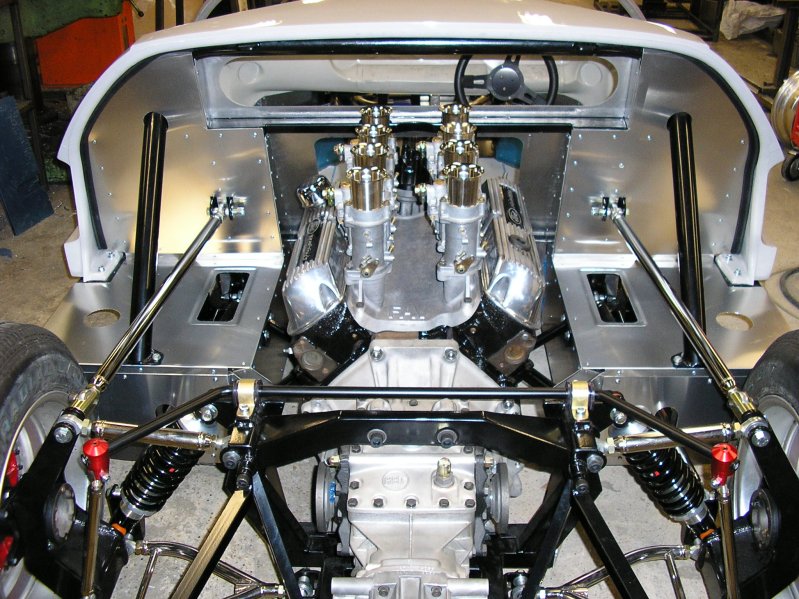

Re: southern gt
That's the first car I've noticed where the ZF top plate ears mount in front of the cross member.
Any reason why this is different?
It looks fantastic!

Re: southern gt
Ron, the reason its different is clear in the photo, it not only makes a lot more room but also allows for much better alignment of the driveshafts, Frank

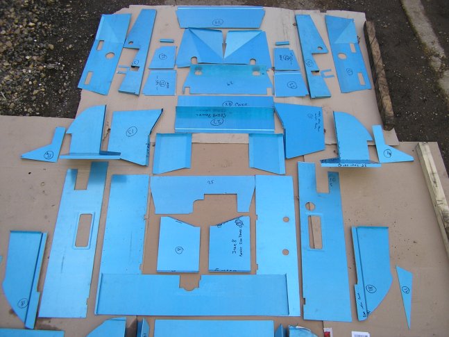

Panel sets are preformed and ready to fit.
