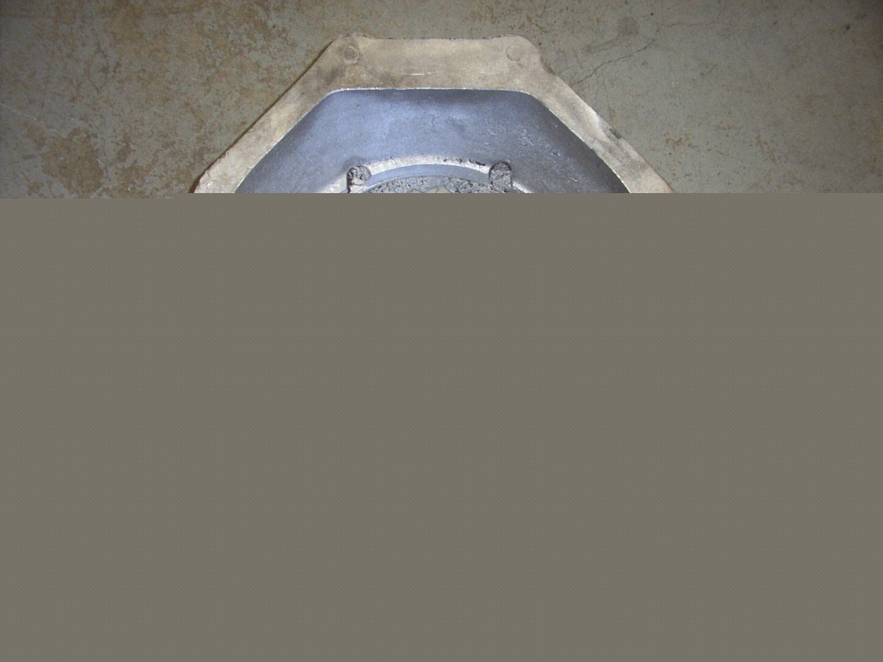

Glad you started this Frank. I've been trying to find the post where you asked for measurements and details on the bellhousing.I think you've already ordered one but here are some pics and measurement for you anyway.
Ross

Re: frank\'s kva
oops forgot to shrink it

Re: frank\'s kva
#2 Bellhousing is 4" deep

i didn't order it yet but planed to do so
here is a picture

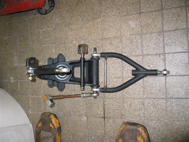

Old 09-26-06, 12:11 PM   #20 (permalink)
Frank Beuker's Avatar
Frank Beuker
Silver Supporter
Join Date: Nov 2005
Location: the netherlands
GT40: kva
Posts: 434
Rep Power: 7 Frank Beuker has a spectacular aura about
Re: frank's kva
The new underarm
