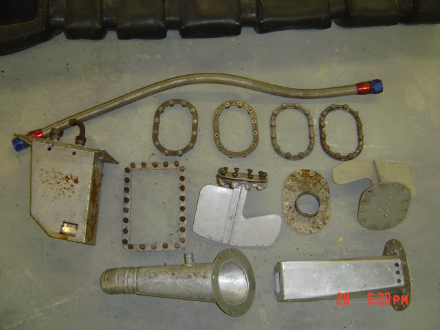

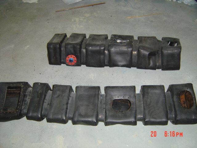

I will be fitting the Bag tanks with a single right hand fuel filler cap and cross over feed pipe. New foam will be installed and was supplied and cut to original GT40 Pattern by Premier.

the fuel fittings need a clean up before fitting but here they are.

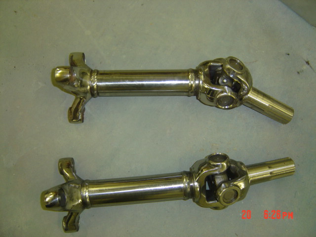

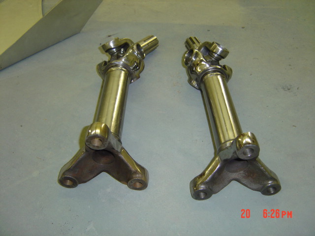

Drive shafts new from GKN will be fitted with new Rotaflex couplings.
Chris Melia is offline

Drive shafts.

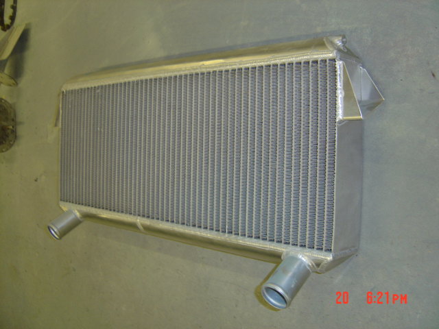

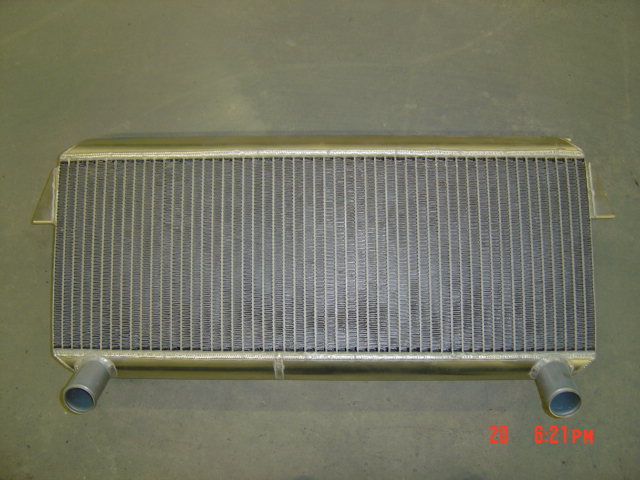

When I got the car, an original radiator matrix was with the parts, so I took it to Docking engineering at Silverstone to have the Tanks and mounting brackets fitted.

Radiator

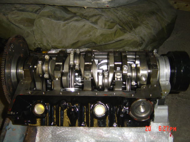

The engine is a Ford Motorsport 4 bolt main, 346 stroker with forged pistons 1/4" over stock H beam rods. The steel crank is internally balanced, Roller cam with vernier adjustable belt drive. The reconditioned Gurney Westlake heads will be fitted after Mathwells supply a set of custom head studs. Original set of IDA Webers will service the induction.
The block had to be clearanced to allow the stroker crank and rods to rotate.

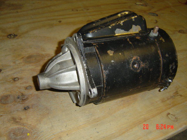

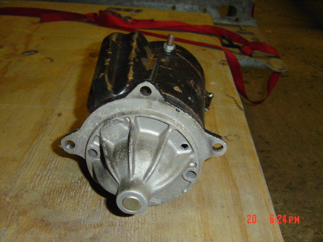

Reconditioned original spec starter.

Old 03-20-06, 02:05 PM   #30 (permalink)
Chris Melia's Avatar
Location: UK
GT40: England Suffolk
Posts: 1,688
Rep Power: 24 Chris Melia is a glorious beacon of light
Re: Chris Melia\'s Mono \"Raiders of the lost Arc\"
Starter mount

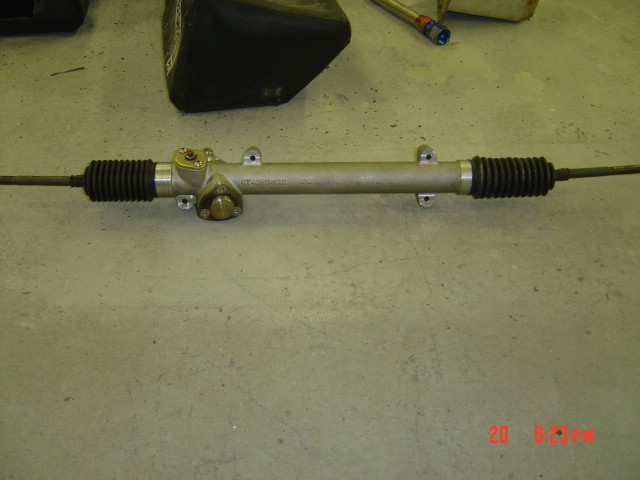

Fully assembled steering rack.

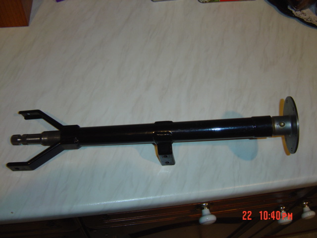

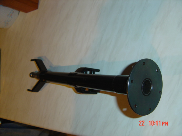

Hi Guys
here is the steering column ready to fit with new bushes and powder coating
