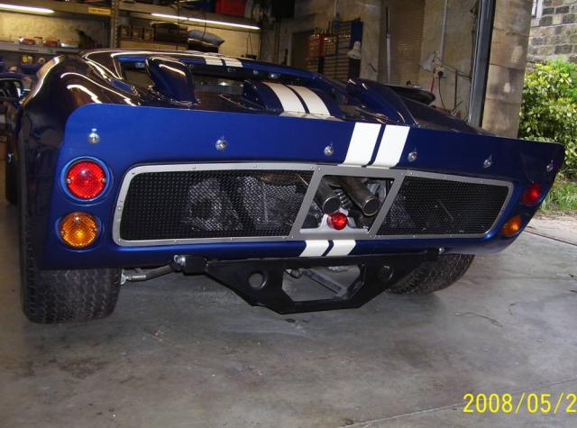

There has been progress on fitting out the rear clip with the temporary SVA rear lights, the heat protection for the underside and the final position for the snorkel ducting that will be linked with flex duct.
Here are a few shots. Wire them up next

The rear clip gets heavier as it is built up, and now its painted I can't single handed lift it into place.
Fortunately I had a little help from friends. Martin Mike and Alan came over from Lancashire for a visit, they assisted, thanks guys!
Here are a few shots of it in place

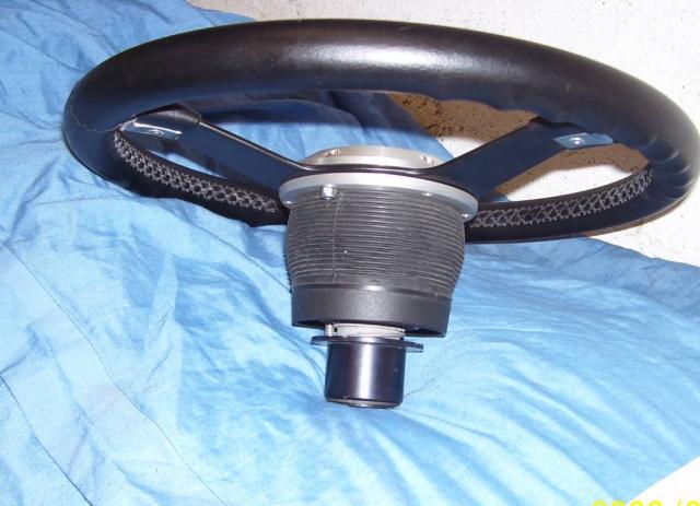

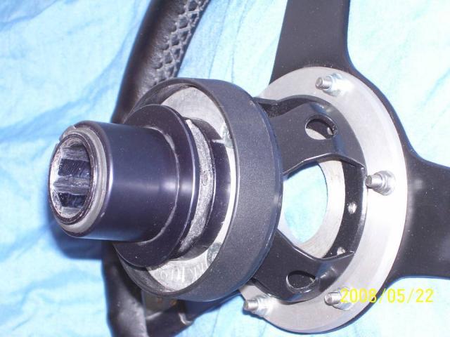

It's time to sort out some SVA issues. I have fitted a removeable steering wheel, I believe this will need to be locked in place and require tools to remove it also a collapsable boss. I will also add the Mountney pad for the center of the steering wheel.
Here are some pics of the collapable hub I have grafted onto the removable boss, you can just see the locking bolt that locks down the relaese ring.

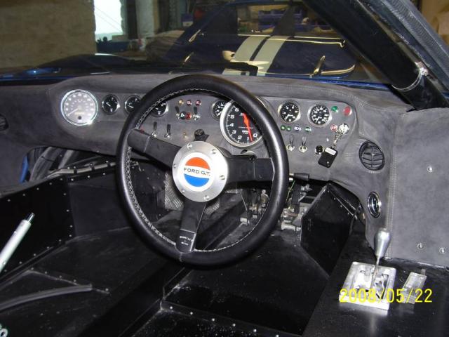

There is also a shot of the almost complete dash, I think everything that has flick switches are in the 'exemp' area.

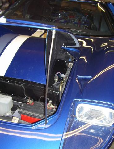

I have made a front vent support for the hinged panel. I made up a plastic clip to snap onto the Dzus fitting at the botton and a socket at the top that the top Dzus locks into, it will stow in a couple of terryclips.

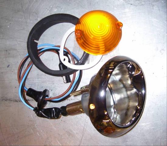

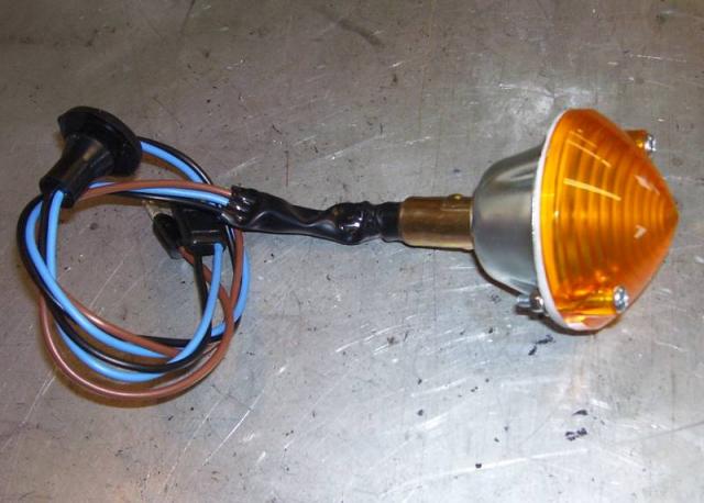

Anyway I have the front indicator lights from a 65 Mustang and have stripped off the chrome surround before and after photos attached.... anyone want the chrome bits?

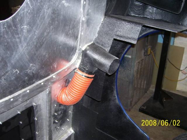

The rear brake ducts have the connecting high temp hose fitted
