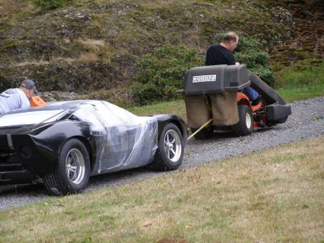

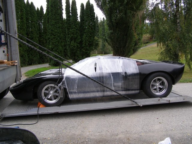

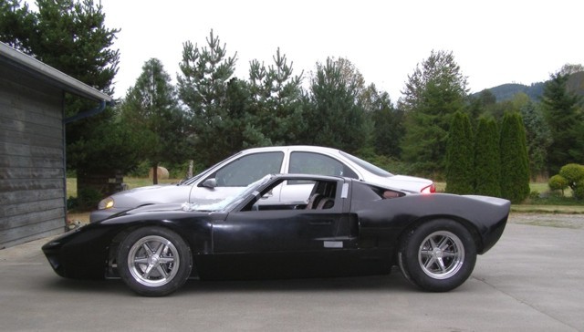

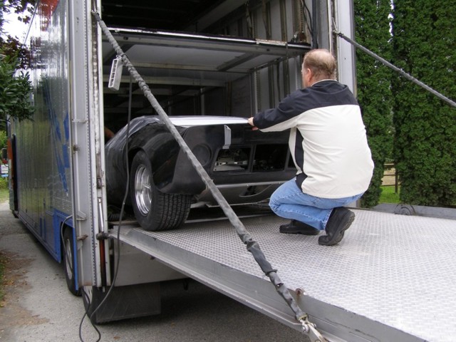

Well boys, here we go. I can’t wait!
What you see here is the foundation for a Mk 1 Road carn. No doubt you’ve all read about, if not seen for yourself, the remarkable starting point Fran Hall and his team at RCR has provided for builders. On the off chance you’ve been on a hunting trip for the last year or so, the quality of the body work and chassis are artwork; the chassis welds could bring tears to your eyes they’re so good, and the bodies, well, they’re just plain exceptional. It’s no wonder the backlog of work at RCR continues to grow.
This build thread will be on hold for a few weeks whilst I ensure that my bride is happy in her new home… paint, carpeting, so forth. Once that’s in, we’ll get started. I figure a couple more weeks.
Until then, here’s a couple shots of the arrival (I'll bet you had no idea a lawn mower could pull one of these up a hill) More soon…

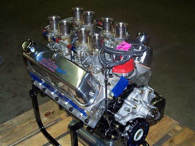

Maybe six weeks ago I shipped off the carbs and an oil pan from Armando’s to Keith Craft Racing Engines. I’d heard nothing but good things about them, the quality of the engines and how they stand behind their work. Well, three weeks ahead of schedule and just last Friday, I received a call from Tony at KC announcing that my new 331 is finished, dyno’d and is ready to be shipped. Although I was a little disappointed in the 435 horsepower figure, I was very pleased with the 450 ft-lbs torque which is, by the way, nearly equal to the 427-equipped Corvette I had some years back – and destined for a car weighing at least 1000# less!
More soon,

Having survived a two and a half year build I appreciate your situation! I'm sure your rookie builder will do a fine job!
Your HP seams a bit low. Any specs on the camshaft in the bling blanger?

Neal – The cam is Crane roller, #TFS-51402001 (Intake 542 lift / 286°, Exhaust 583 lift / 294°); the heads are AFR 185’s. I’ve since learned that the horsepower ‘issue’ may be more closely related to the 48 IDFs on top - they're not IDA's. When I discussed my preferences with KC prior to placing the engine order, I’d hoped for results a bit closer to your 8-cyl monster. What I didn’t know then was how Webers have a real affect on those horsepower numbers, and what I still don't know is how IDFs match up with IDAs. Had I opted for a 4-bbl carb, I was told this engine would easily make it to 500 horsepower. Oh well. I’ll just have to suffer with this underpowered boat anchor for the time being.

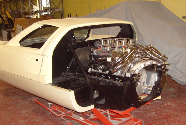

Wow. Where did a year go? Time to dust this off and bring the story up to date.
Since my last post on this build thread, the honey-do’s are taken care of and the new job, while still mentally exhausting most days, has become far more manageable. The property, though, is still more than I bargained for. I never, ever imagined mowing so much grass.
Earlier I mentioned that I’d gone looking for some help and ultimately found someone who I know will be a great partner with this project… Fran Hall and the RCR team. I’m doubly grateful for their help now. Bear in mind that the RCR business, when Fran committed to helping with this build, was only growing in leaps and bounds… had the RCR business climate then been as robust as it is today, I don’t think Fran would’ve/could’ve committed his team to the task. Thanks Fran, for your help with this. You know how much this means.
Over the summer and fall of '07, Fran and I talked a number of times and at some length about the specific hows and whys of this build. He was a great source of information and offered great feedback along the way. Eventually, we had a plan.

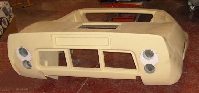

One of the first orders of business was to modify the tail section to the early 4-lamp rear light setup, so Frans bodywork team went to work on it. Having an original tail section hanging in the RCR shop made for easy reference; in no time it was done and the primer was applied.
And then the engines first test fit…
