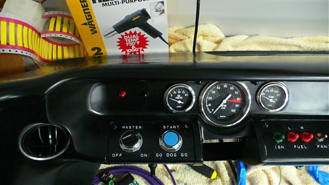

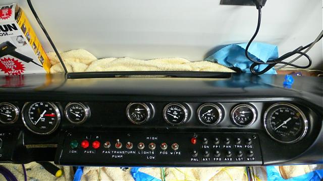

Here are some of the 'mostly finished' dash and labels. I didn't go the route that BillD did, just too lazy, I ended up just getting a Dymo Embossing labeler from Ebay and going to town.
Pic 1 Left Panel - Bottom of panel (squeezed in the horn button)
Pic 2 Left Panel - Master On/Off, and "Go Dog Go" (starter) button
Pic 3 Right Panel - Switches
Pic 4 Right Panel - Breakers
And no the 'Wipe' button is for the Window

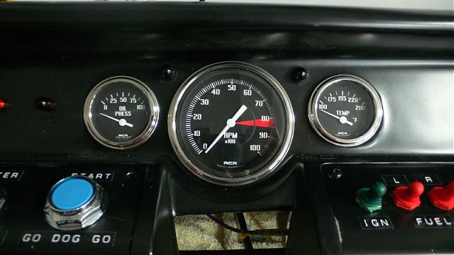

Overview of the dash. You can see the new style RCR gauges.
