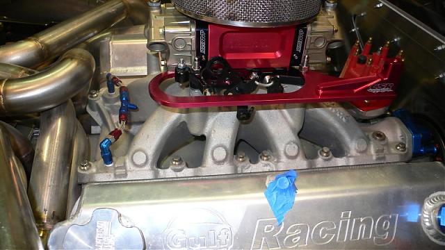

Here are a couple of the front radiator hose setup, and the air bleed returns from the back of the manifold. Just drilled and tapped a 1/8" pipe on each side and used a -3 all around. I had some trouble with the Earl's all aluminum -3 hose fittings after stripping out 2 before I realized that you can't actually tighten them up. Poor design with the amount of threads, aeroquip next time. Last shot is the Knock off tool. It will work for the front's but not the back due to the large offset. I'll likely machine a hex on the back for a huge socket and see if that and the impact will do the job. Last one is the stainless tank vents.

Please explain your approach for the coolant bleeder. Will it be a manually opperated valve which is periodically checked, or will you be plumbing it to a coolant tank?
