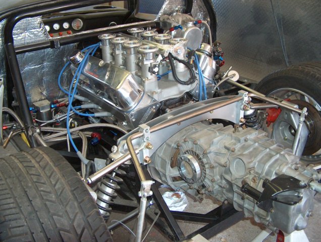

I am still making progress. I finally got the trans in and mounted. Started looking for the brake set up lynn uses but so far no luck finding it.
Here's a pic with the engine and trans in.
