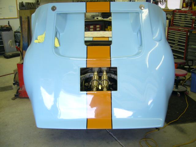

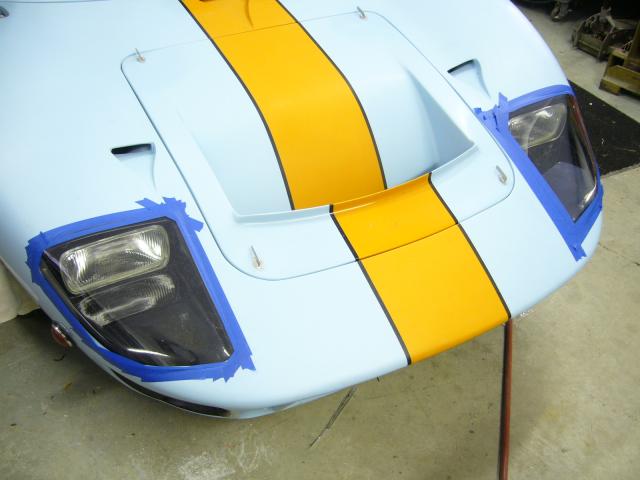

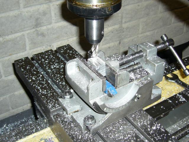

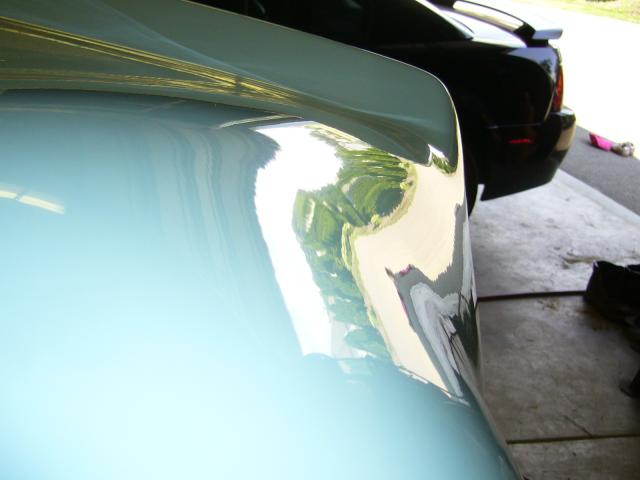

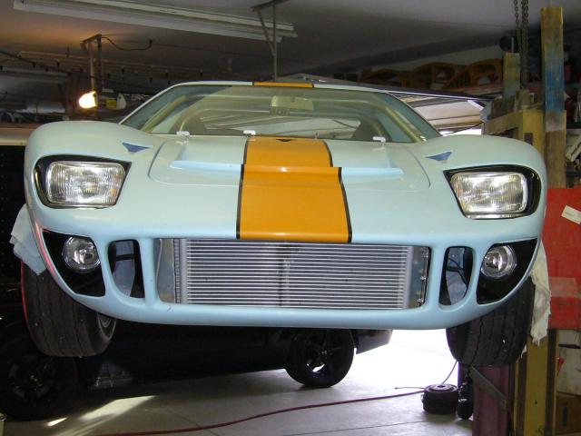

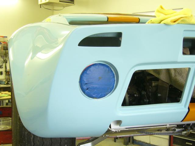

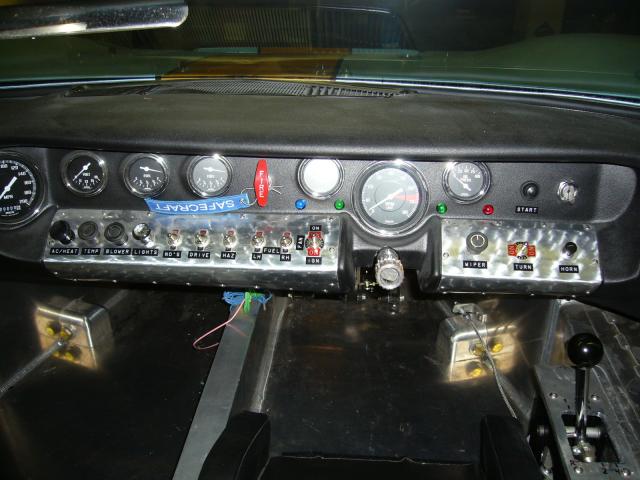

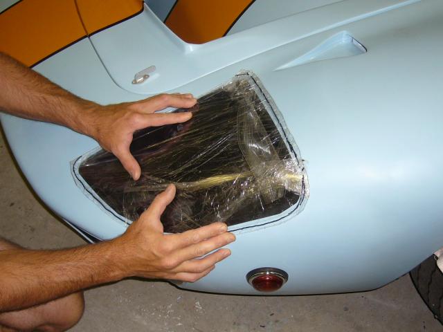

Spit polish and finish assembly has begun.....
- Installed and wired the front lights
- Finally put the Dymo label maker to work on the dash labels
- Started machining up mounting bases for the body side latches
- "Fitted" the plexi light covers. Will install once hardware shows up from McMaster Carr. Planning on riv-nutting with stainless button heads.
- Started on the buffing.... Got the first pass complete on the rear clip today. Found a couple spots I need to spend some more time wet sanding, but moving along......

Rob:
Looking good. Isn't fitting the plexi glass fun?
Just curious, do you plan to add a black paint line along the outer edge of the plexi glass panels? I am debating about doing so with (1) tape as Bill Dobbins did or (2) masking it and painting it.
Chuck
CESLAW is online now

Rep Power: 2 molleur is on a distinguished road
Re: Rob's RCR40 Build
Another "trick" is to tape off the border as suggested for painting, then apply several layers of tape to the entire plexi part. Put it in your blast cabinet & lightly blast the remaining border before painting. This makes for a good pebble appearance around the part and the paint really has something to hold on to as well.

Yep....fun fun fun.... NOT But they sure look cool now!
I originally was planning on blacking out the edge, for this reason I masked to the center of the plane. However, I recently realized 1076 had no black on this plane (interface plane to lense). So, was thinking about my options while sanding ...sanding... sanding. No epiphanies just yet.
However, Molleur's comments are not a bad idea. I did this on the Daytona coupe windshield. Masked off an ~1.0" border around the glass, blasted and painted it. It looked great. May consider doing the same and painting the body color. Hmm....will have to ponder it some more.
Another method that would accomplish this, for those of us who do not have our own blast cabinet, would be to head for the nearest city big enough to have a stained glass shop. Get some glass etching solution, prepare the glass as described, then you just apply the etching solution with a foam brush. 15 minutes later you have a fabulously "toothy", paintable surface with very sharp edges (as long as you applied the masking correctly).
The newer etching compounds are much more environmentally friendly, too...
Wouldn't work on the plexi headlight covers, though--only glass.

Haven't tried it, but what about something like Acetone? Would it etch the plexiglass sufficient to make it suitable for paint?
Might be more likely to melt it or turn it cloudy--laquer thinner would be my suggestion if one wanted to experiment with solvents. I'd be more inclined to take a piece of emery cloth to the plexi, once you had it masked. All you need is some ridges to create a less slippery contact surface for the paint.

tape it off and use fine steel wool to abrade it safely

What paint does one use? I assume any paint will look shiny through the plexi glass regardless if it is satain, gloss or flat. Simple spray enamel, like engine paint work? I assume one should stay away from laquer paints. What about model kit spray paint? It would be safe for plastic.
I'd say use any decent quality enamel, certainly model car paint (maybe Paolo is following this thread), although sprayed laquer does dry very quickly and might be a good option--I'd test it on a small area that would be fairly easy to touch up should the lacquer solvent have any adverse effects on the plexi...
Another option would be to use a vinyl paint. Most auto parts stores sell it as upholstery paint. I once painted a set of white bucket seats black and then drove the car for 2 years. There was no white showing through when I disposed of the car, that stuff's that good.
