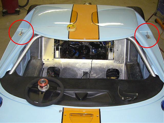

Rob, it's looking great. What are you putting in the top of the tail? Looks like cutouts for turn indicators or similar.

The cut outs are for under body air pressure vents. I simply mimiced the cut outs from some vintage pics. The also make great handles for carrying the body around, and I imagine will come in handy for pushing it around too.... ;-)

I love the way you added the rear cutouts. Are you going with a fabricated spoiler like mine?

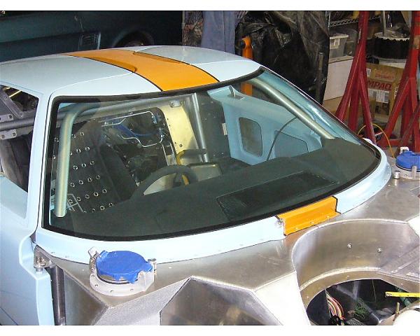

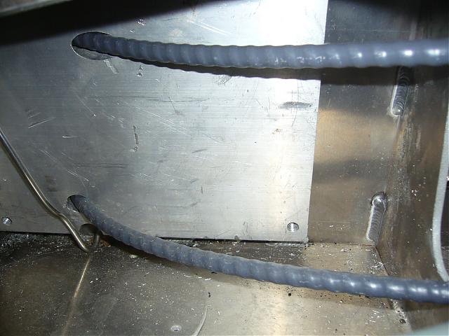

Re: Rob's build

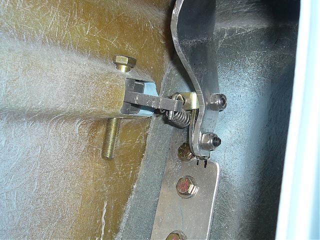

Nice project, nice progress.
One small "possible" issue, want to point out.
the Dzus clips that hold the spare/nostril cover on the front clip. You might want to put the retaining wire on the other side of the glass, or put extra secure fasteners with large backup washers behind the glass to hold them.
What happens is when/if the front clip pressurizes it lifts the spare/nostril cover. This is more of an issue with nostrils that don't go all the way to the radiator and fully seal, with a lot of air coming in the front and not all of it going out the nostrils, the pressure will increase so much that spare/nostril covers have been blown off at speed. More likely when the fasterners aren't adequate for the pressure.
Putting the wire on the backside of the glass means it would have to pull through the glass as opposed to just pulling the rivets/screws out. Of course it will change the depth of the Dzus so bullet fasterners with large backup washers may be the way to go.
Of course we can't see the back side to see if you've got a large washer there also, combined with some AN screws/bolts you could already be good to go, you just can't tell from the pics.
This was covered some years back but just wanted to bring it up again in a recent thread so the newer builders could take note.
Rob
Re: Rob's build
Hi Kalun,
Good catch. I agree 100%. I was really hoping to put the whole assembly (wire and mounting bracket) on the underside for the aforementioned reasons. However, I could not come up with a Dzus assembly that had that much reach to go throught the combined material thickness'. So, I came to the conclusion that since the nostril is the "late" style (full opening - therefore significant down force on the nostril) and that the RCR nose structure is extremely well ventilated that I could safely deviate from this design concept. So, the plan is to mount on the surface, use steel fasteners with large washers to carry the load.
In the pic they actually aren't assembled yet, as it will happen post paint. They are just sitting in place.
Thanks for the input. Always appreciated.

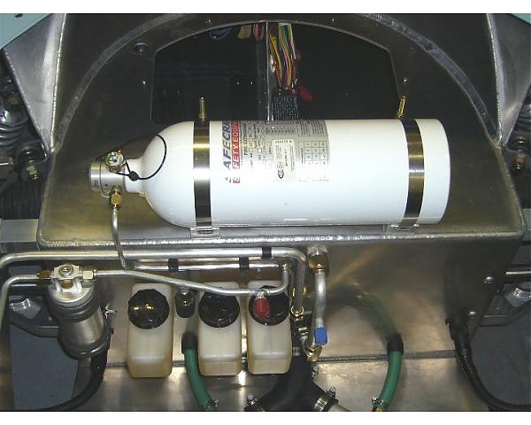

Also have the AC pretty much dialed in. Still considering a few fine tunes for aesthetics....but here's where I currently stand.
Re: Rob's build
Looking good!! That looks like a Vintage Air Mini Gen II. Is it? What AC compressor did you go with?
I just noticed you asked about a spoiler template. I'm sorry to say I don't have one.
Bill D

Re: Rob's build
Nice work Rob..
Bill et al.
that is the new factory RCR AC system.
All the lines are preformed for easy installation....this component has been one of the most difficult to engineer and also to get good vendor support for our custom LHD/RHD application .
The AC system is available as a stand alone proprietory system ONLY THROUGH RCR ...for anyone that would like to retrofit it to another brand of car.

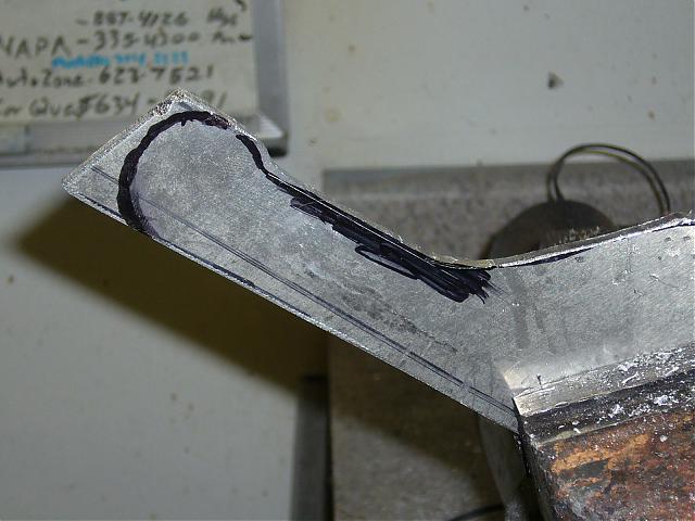

Worked the fender flares in today. Pleased with result so far. Will continue in the morning..
