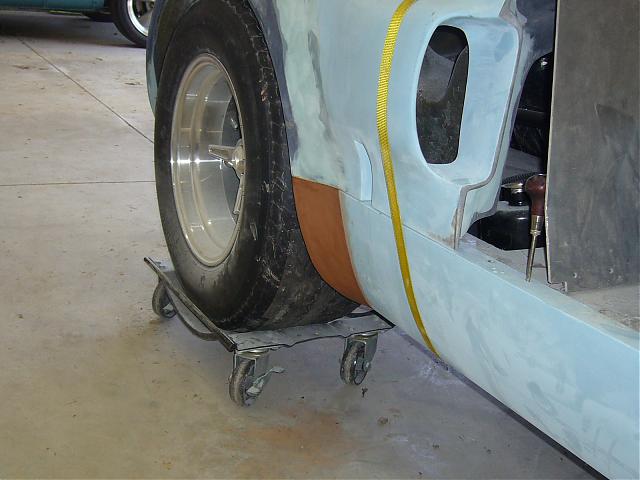

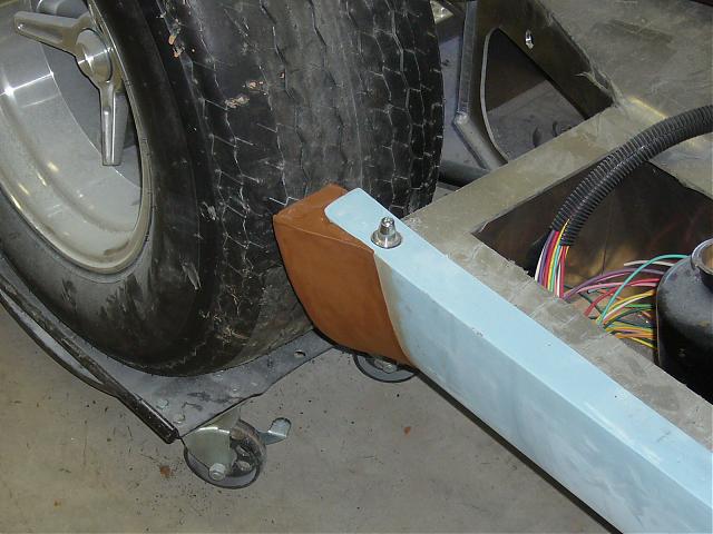

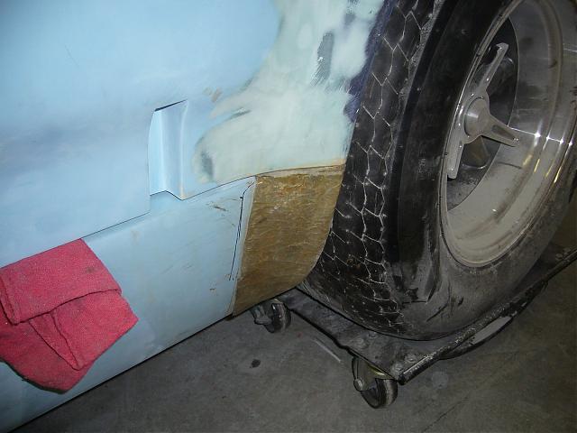

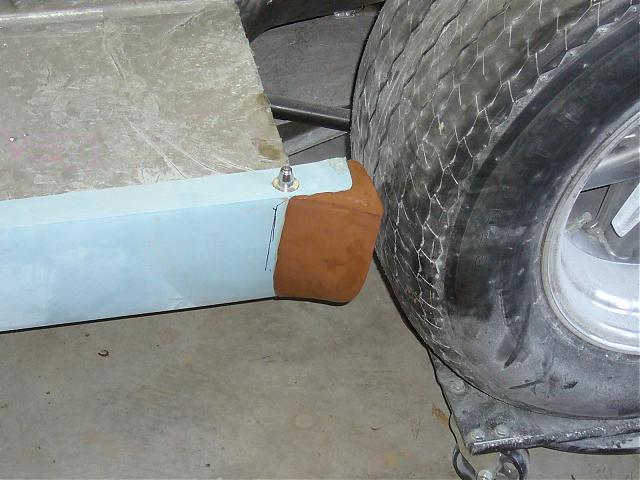

Hey guys.... rear flares are all but done now. Still need to do the rocker flares, will get on those next weekend. Just wanted to share some pics.
Rob

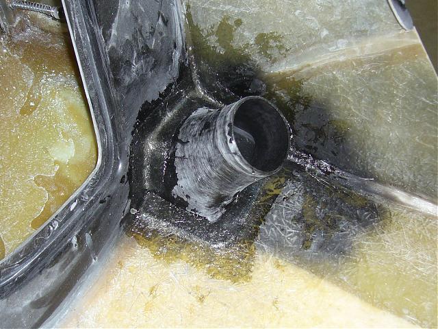

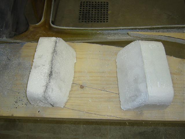

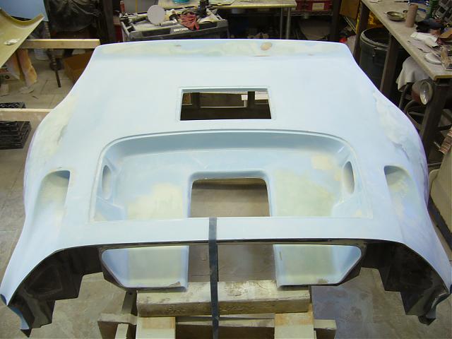

Followed Dean's lead and closed off the brake duct inlets today. Used blocks of styrofoam which I shaped, then covered with plastic garbage bags.
Will break out the foam in the morning.

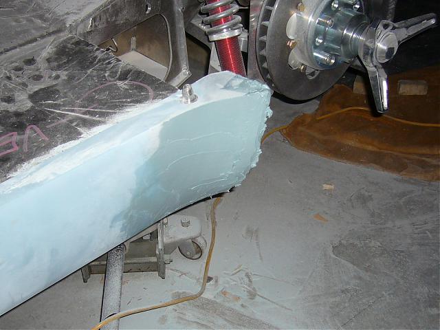

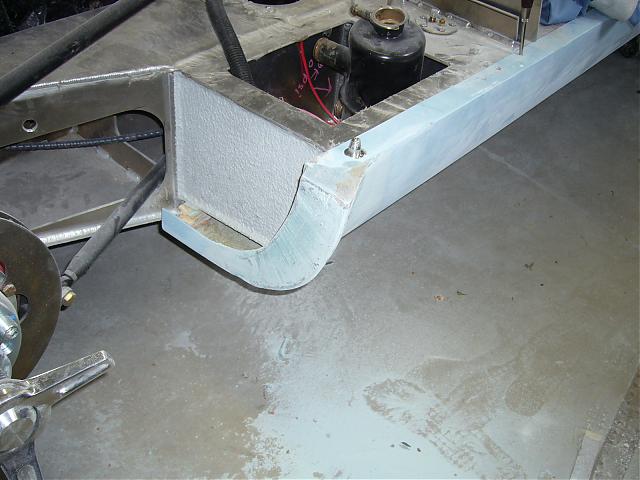

Finished up the brake ducts today, notched the lower front corner of the rear clip for the kill switch, and lots of sanding sanding sanding. I can see the light at the end of the tunnel at this point.

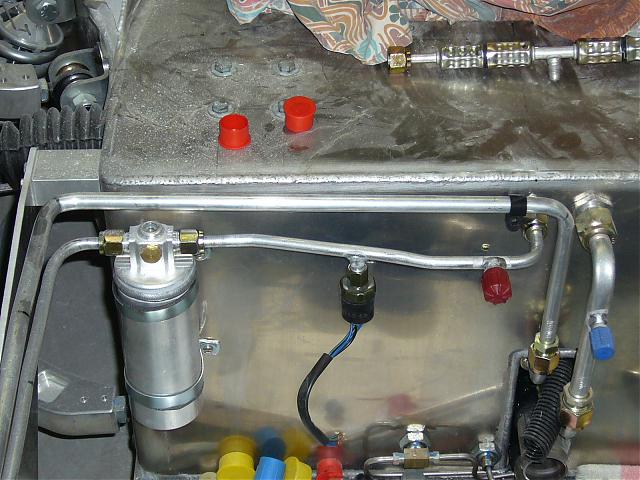

A/C tube aesthetic issue addressed from the 03-06-2007 post....
I like the looks of that....much.... better.

Did you do this mod. or is this how they will come from Hot Rod Air? I am wondering if they have taken into account the differences in the center tunnel location on LH or RH drive cars?

Hey Dean....
This is the plan for how they will come from HRA.
The dimensions will actually be the same, as the LH drive will be a mirror image with some of the bends reversed. The dryer will be on the opp. side, as will the condenser fittings and tubes.

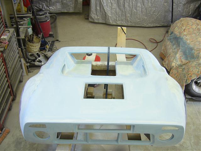

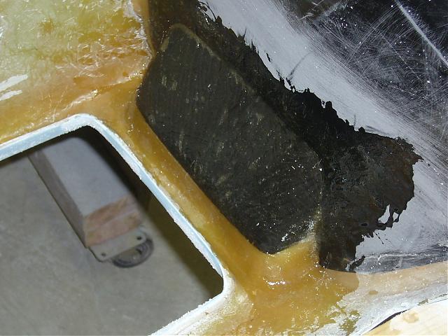

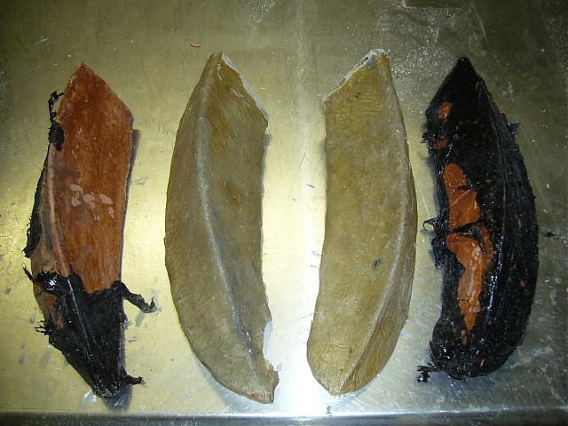

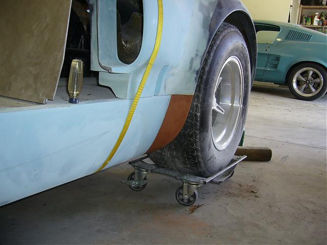

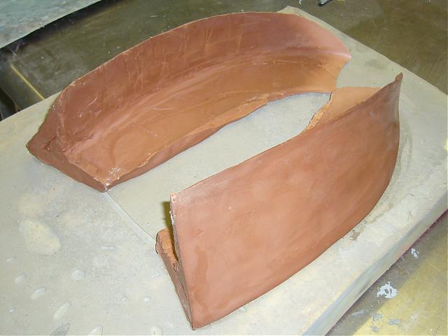

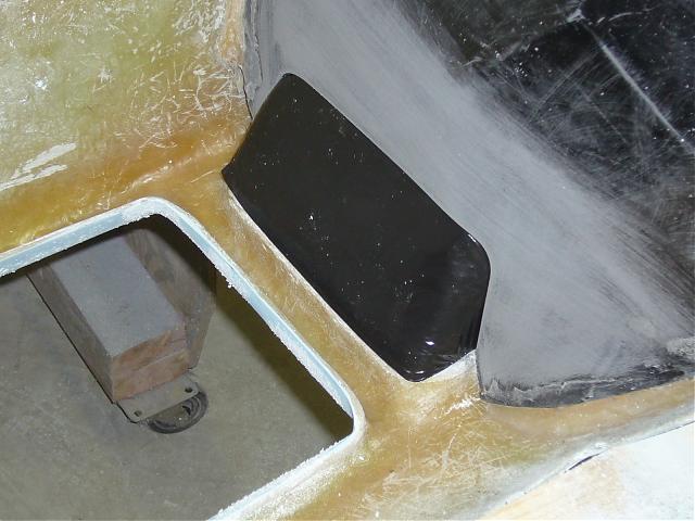

OK....the flares are nearly complete. Made the clay molds last weekend, made glass pieces this weekend. Installed... fill work started. Hopefully can finish the filler work in the evenings after work, so I can spray and sand primer this weekend. (Want to make the most of the bonus day)
Also, glassed in the NACA ducts in the front clip last weekend.

On another note - I was looking at your AC lines (the Asthetic improvement) and am curious what type of flare / fittings it takes. Is it single flare AN or ??

Randy,
Sorry mate...didn't really want to make the first set...
Re the AC lines, the flare is a single for an O ring seat. It is not one that I am capable of making. Don't know what the flare tool even looks like for it. It came pre flared.

On the new AC Line - is that the one now available from RCR? I really did not like the earlier design either..
