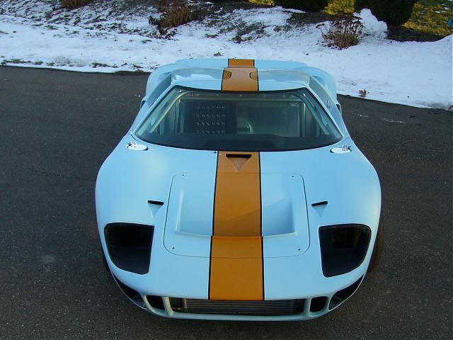

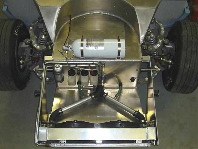

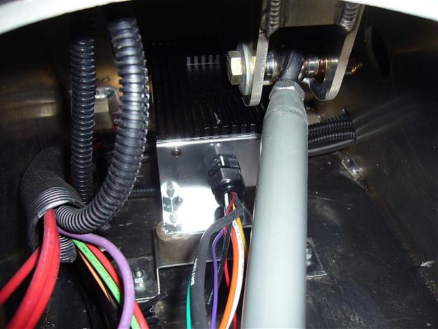

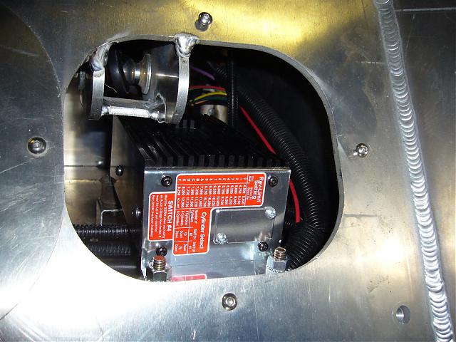

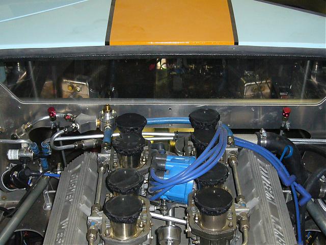

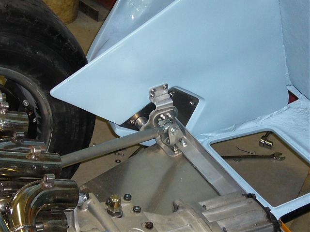

OK...been a while and the build is getting a bit away from the thread, so here is a quick catch up.

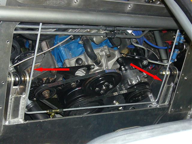

I have backed up a bit on the ignition, and have installed a multi spark system. I hid it inside the chassis to keep the desired look.

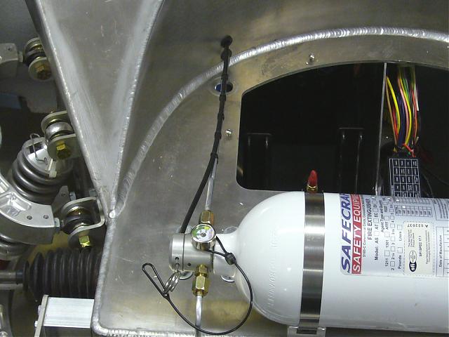

Fire system plumbing now complete

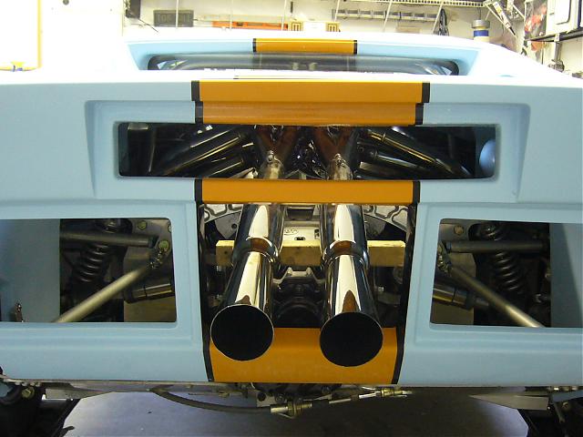

Exhaust installed (still need to make rear bracket at transaxle)

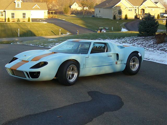

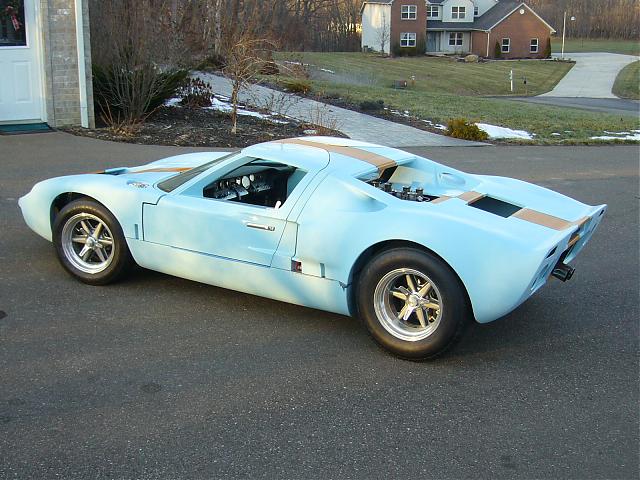

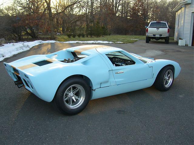

All body panels accept doors wet sanded to 1500 grit
Rear pan assembled and rear clip mounted (rough alignment only)

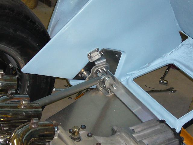

In lieu of straps, made some positive stops to catch the rear clip at full open.
She will be sitting in the corner for a few weeks while I re-do the 67 Stang to get it ready for sale. BTW.... anyone looking for one?? Oh..that reminds me...boy I've gotten spoiled working on the 40. Heck I can have the complete drive train out of that thing in about 45 mins, it took me almost a day and a half to get the "FE" outa the Stang. Of course with a fair amount of blood and cursing...
Hope everyone is having a great holiday season....

Nice build Rob, looks like you're close to finishing. Any info on the exhaust pipes, they look great!

Rob, your positive stops. They might be more effective if the piece that bolts to the rear clip as shown in the bottom pic was rotated 1/4 turn anti-clockwise to contact the front edge of the piece on the sub frame. At the moment a gust of wind would probably deform those pieces you have . In tech terms the moment arm the front of the clip has over the stops is huge. A couple of scissor links from each side of the TA to Clip would add a safety margin and gravity would ensure that they folded in the right direction when the clip is refitted.

Thanks Chris. The exhaust is RCR.

Jac, Yes...certainly and obviously the moment arm is huge. The material is high quality and I think there is greater chance that I would push through the adjustment rather than deform the material. This too in my opinion would render the design a failure, as I really don't want to have to re-adjust the rear clip once it is done. However, should the material deform easier than my engineering judgment anticipates, a couple simple gussets would likely address the design flaw. The stationary piece being 1/4 turn would address 1/2 of the equation...correct (still leaving the upper with the inherent concern), but did not work from a functional perspective of using the hinge plate. Thanks for you thoughts.

Incredible work Rob!!!! I still can't believe you went through the trouble of finishing the inside of the rear clip! It looks great! How do your fuel level senders work?
And what the hell is that white crap in your lawn!??????

The white crap is a strange anomaly which occurs roughly about this time each year. It apparently is actually "rain".... oddly enough. But I live in a god forsaken place where Car Guys can't actually enjoy their cars for nearly 6mos outa the year due to this winter rain (commonly called "snow"). I still don't know why the hell any of us live up here.....
