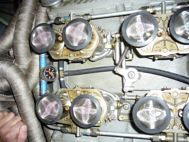

Today's project was to fit screens in place of the sock filters that I have been using to date. Using some insights from the discussion we had some time ago, I hunted down some tea balls "infusers" with 2.5" outer diameters. After a few hours on the net, found some available at the local hardware store of all places. For the retention to the velocity stack, I wanted to devise a way that I could easily pop them on and off, yet would look clean and simple. What I came up with was to cut the bellows out of a steering rack boot and use each bellow as the retention band. Cutting them out was a slow going process, but the result is exactly what I was looking to achieve.
When I am on the dyno I will take runs with them both on and off to determine if there is any negative affect on performance. I did a flow assessment with my hand meter, and they had at least 2.5 times the flow of the socks.

Re: Rob's RCR40 Build
Incredibly smart approach!! You are The Man!!
I really admire the ingenuity in resolving the myriad of details. Everyone has thier unique method of trial & error. Lots of examples of this on the forum!
Thanks for a great tip!

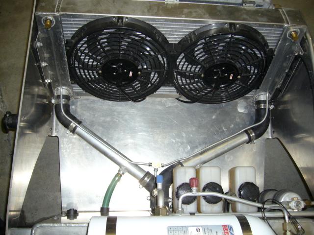

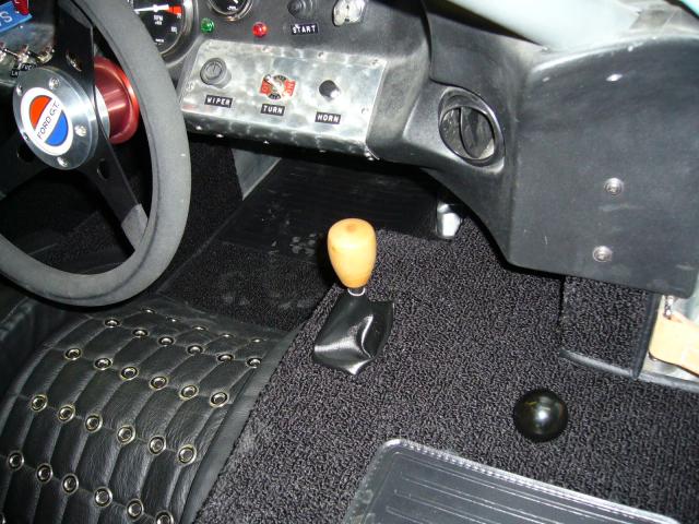

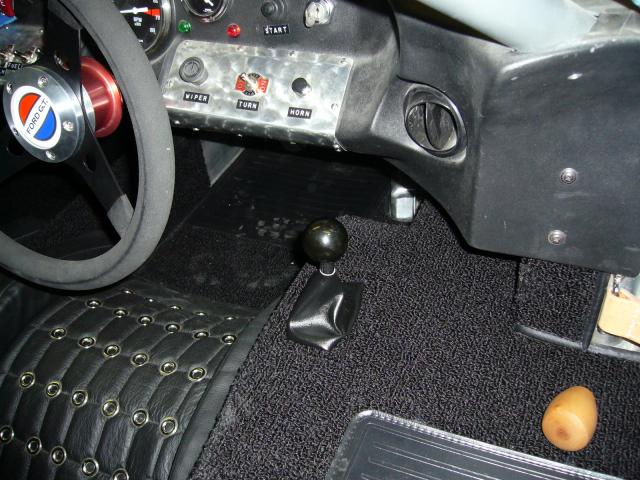

Finished the wood shift knob. It looks a lot like the one I intended it to look like (pic of 1008 below), but not sure if I like it. Bummer....since it took a lot of time and the heli-coil thread kit was $50. It looks great when there is no carpeting in, but with the carpeting in I like the black one better.

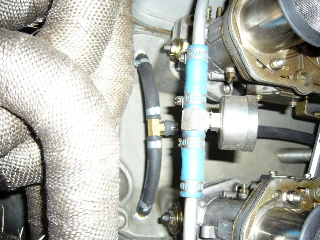

Plumbed recirculation lines into the cooling system. This took most of the time.
Re-jetted the carbs again to dial them in.

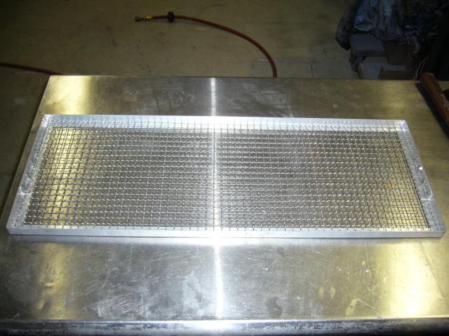

Next on the list is the radiator protective screen and paint the battery cover, then schedule the dyno time. Home stretch....

Rob,
Looks like you need to stain the knob a dark walnut/pecan or similar. I thought I had a shot of my friends original, but could not find a pic of it. I seem to remember it as a darker shade than what you have.
DRB#5

Hey Rob:
The knob looks great. A few hard laps with sweaty palms will likely add to the patina.
If you don't like the knob with your particular interior, just send it to me and I will put it good use . . .
Chuck

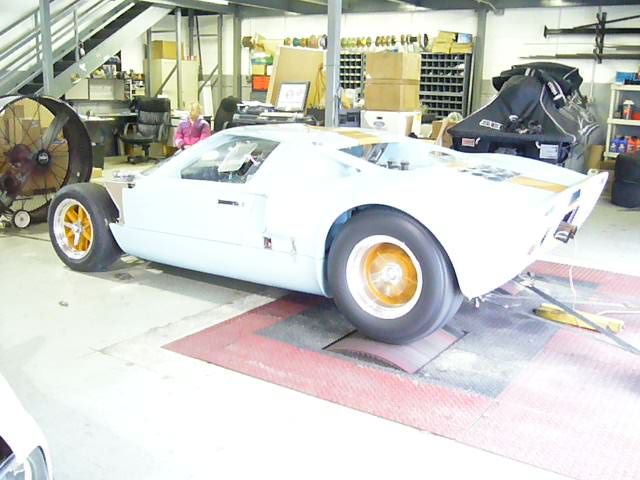

Chuck,......I'll keep that in mind ...

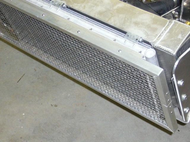

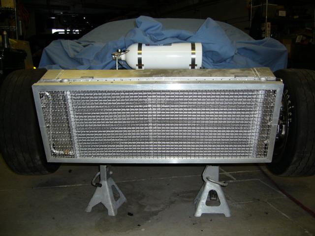

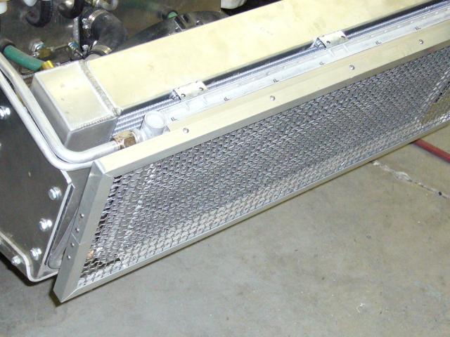

Finished the radiator screen yesterday.
Just got back from the dyno shop. Lucked out, recent jetting changes were dead on. Sometimes you just get lucky....
Numbers: 302 BHP / 316 Ft-Lb and mixtures were good, with a hint (~1 point) to the rich side on WOT. Tea ball filter screens were utilized, as this is how it would be run. Temp ran at 185º.
Dyno Pull vid

As I recall you are using IDF carbs. Just curious as to what jets you are using? I suspect our two set ups are pretty close.
Screen looks good. Looks stout enough to stop any big chunks that might get thrown your way . . . .
